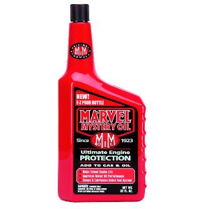

Sea Foam does seem to work really well also.
   / 2 Cycle Carburetor Cleaner
#26
When in doubt View attachment 236323
Been a long time since I used Marvel Mystery oil, but it's always been a good product for a lot of uses. Of course, I used to regularly use Marvel Mystery Air Tool Oil when I was repairing/rebuilding mechanics' air tools.
And every time I think of Marvel Mystery oil, I'm reminded of one of our customers when we had a Texaco service station in Marietta, OK, in 1956. He drove a 1950 Ford that he kept looking and running like a new car. And when we changed oil in it, he wanted Texaco oil and substitute a pint of Marvel Mystery oil for one of the quarts of motor oil. Texaco branded oil was a non-detergent motor oil. Havoline branded oil was Texaco's detergent motor oil. So his method resulted in a high detergent motor oil and obviously worked well.
