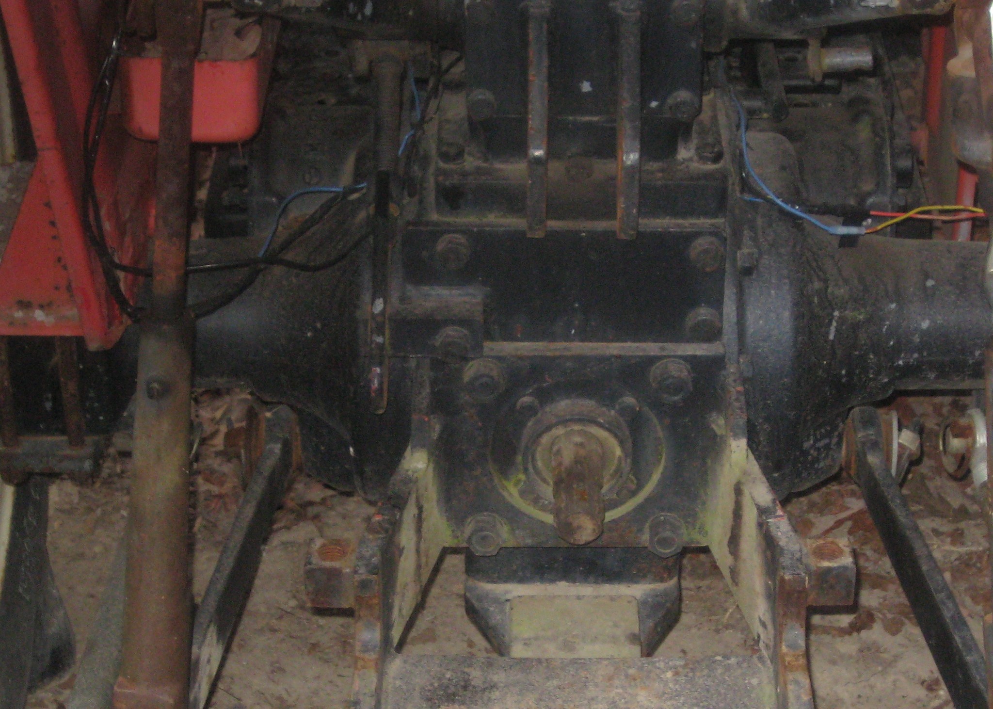

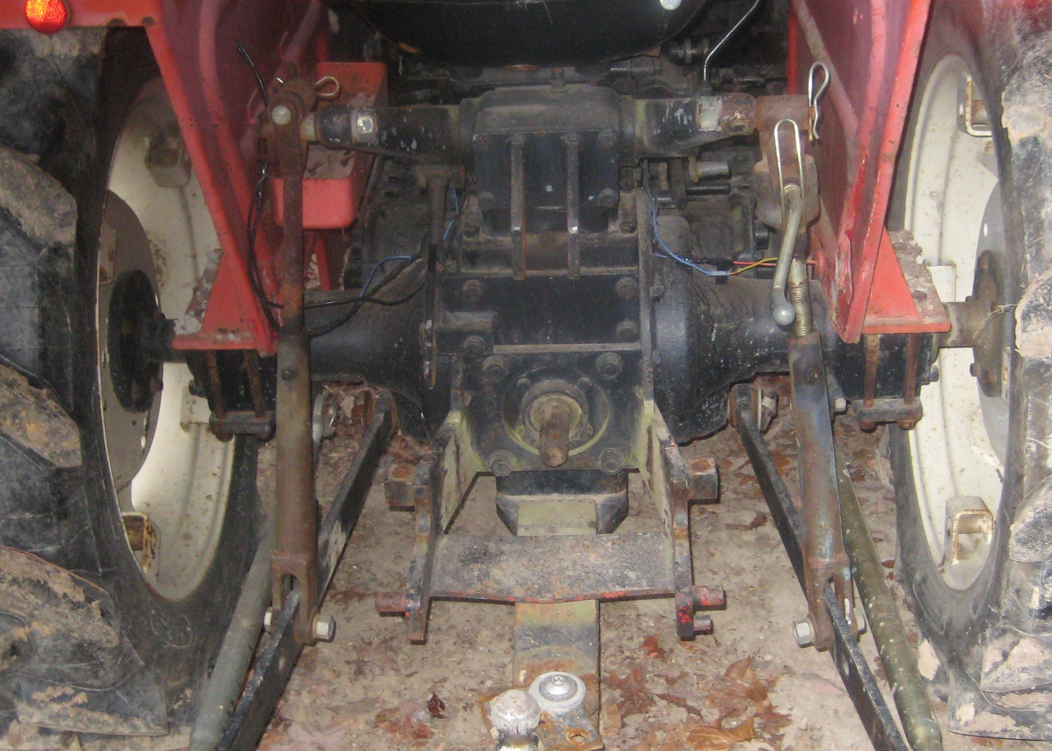

Does anyone have apicture of what a stock 2 point hitch looks like on a japanese tractor? Really need a picture if possible I am working on getting a tiller hooked up to my shibaura S700
/ 2 point conversion
ok here is a picture of what the back of my tractor looks like. It has a 3 point on it but has the metal frame around the pto is this originaly for a 2 point? If so this will be the deciding factor on a 2 point tiller or 3. If it will work with a 2 point I will go that route.
Need some help ASAP because I will be buyin a tiller tommorow. It could potentialy save me a few hundred dollars if I buy the 2 point. Thanks for the help.
/ 2 point conversion #7

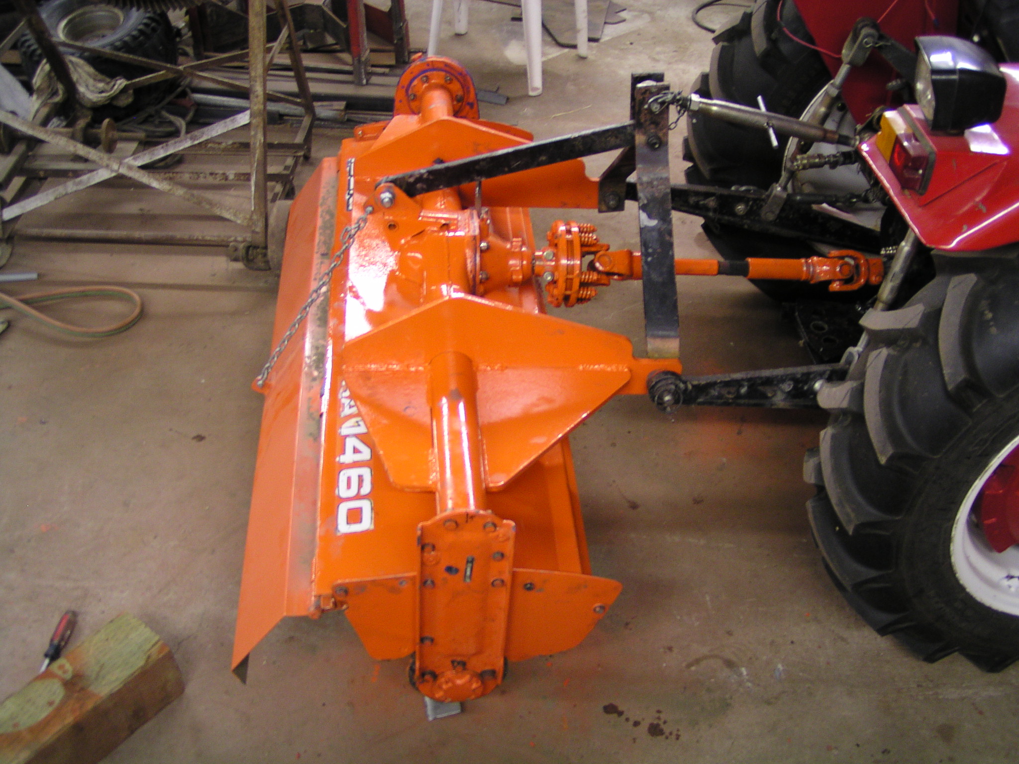

It looks to me that you have a 2 pt hook up available, but each manufacture has their own 2 point system. I know that my Yanmar 2 point is MUCH different than what you have. I have a 2 point tiller and use it a lot. I do not have a picture which clearly shows the 2 point system hooked up, but maybe separate will help illustrate how mine works.
The 3pt lift link attach directly to the tiller and the nose of the tiller is pinned on each side to a cover over the PTO. On the picture of the rear of the tractor you will see the pins that attach the tiller to the tractor.
Ok great if I go with the yanmar 2 point I think I will be able to to some minor mods to make it fit the tractor. A few quick metal brakets and some welding I think I will be able to make it work.. Thanks for the input.
/ 2 point conversion #9
If I had a 2 point tiller that did not match my machine, I would not try to make a 2 pt mount, but rather make the tiller 3 pt. That would make it easier to mount and more universal. And I do not think that it would be any more difficult.

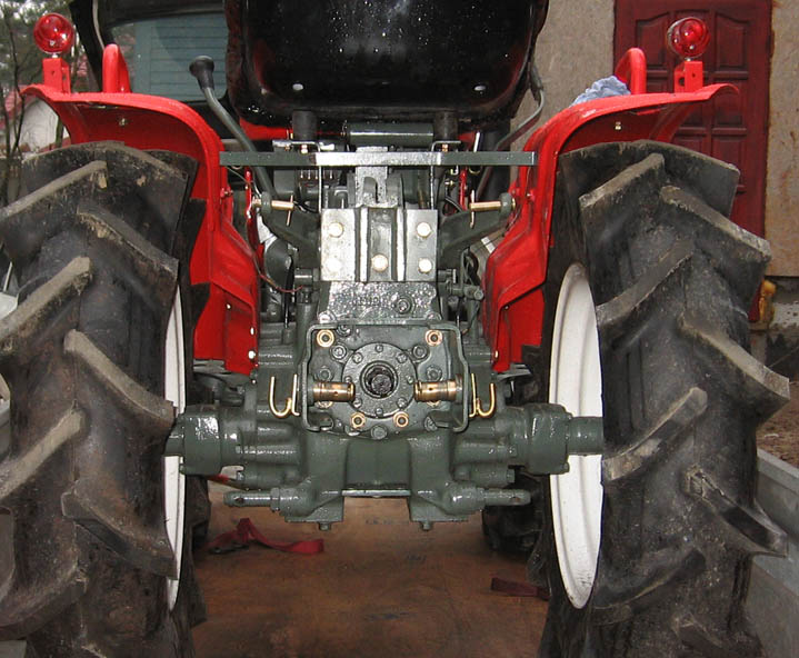

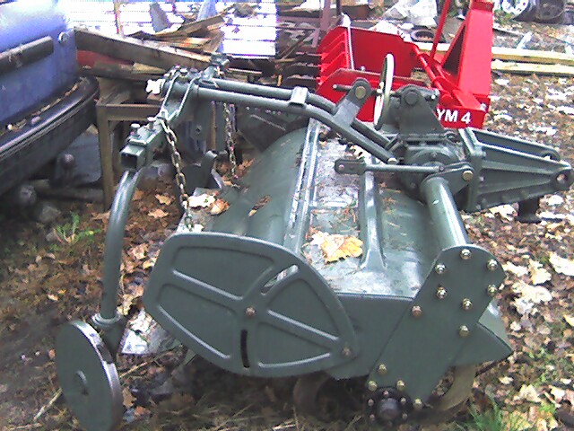

I have a couple of 2-pt tiller setup photos that might help. Looks like a pretty simple connection, one pivot point and the two lift arms.
Bill
#12
Great thanks for the help. On your bottom hookup how far apart are the pins that go throught the tiller.
/ 2 point conversion #13
Umm, that's not my tractor. I got that photo off the web somewhere, thought it might come in handy sometime. If you get the two point tiller (Yanmar RS1202, etc.) it should be the same width at the pivot point.
Bill
