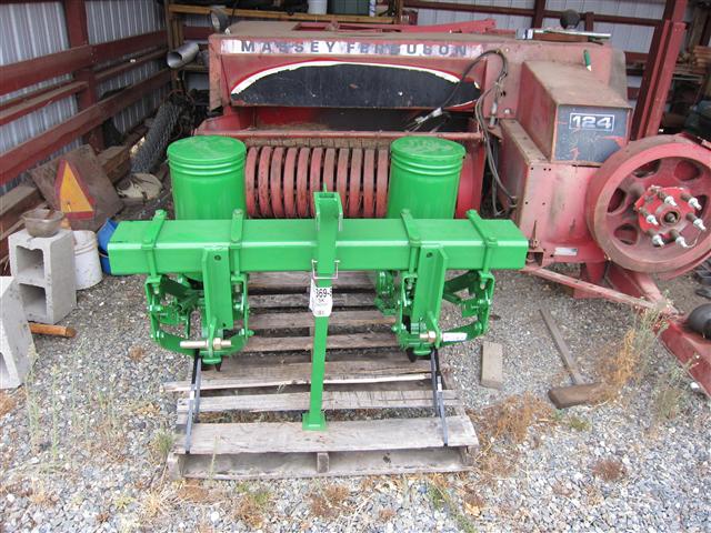

It just a matter of what you are willing to spend. Yetter is still making the JD 71 row units, but under their name. The 71's are among the best plate planters every made. If you are wanting new dry fertilizer boxes to go with it, the guys down at First Products can hook you up with a set of stainless steels ones.
As others have said, you can also look around for a good used set. I have seen some guys that are cutting down older JD 7100 planters and making 2 row set for sale. Nevertheless, it's not hard to rebuild the row units if they need it. I bought a 6 row set of JD plateless planters at an auction and then ran them through my shop (disassembled , sandblasted, paint, new bears, idles, chains, decals) and probably saved myself $10k +.
71 Series
1stproducts.com
   / 2 row planter #5

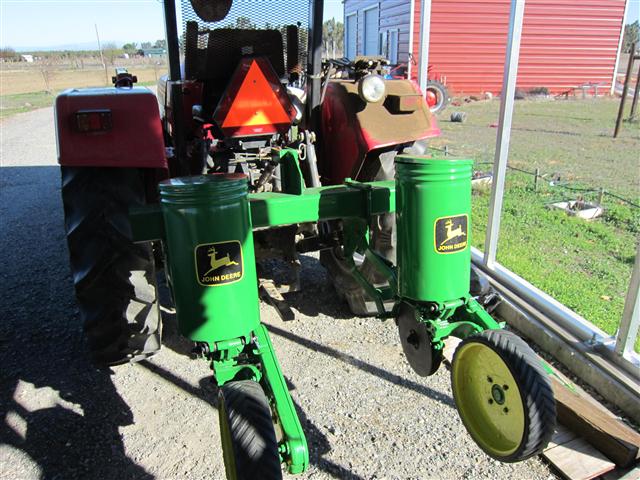

I bought a refurbished dual JD 71 Flexplanter off eBay for $1K plus about $300 shipping from Minnesota to Northern CA.
Yetter makes their version of the 71 now.
You can add fertilizer boxes as mentioned earlier in this thread.
Good luck
