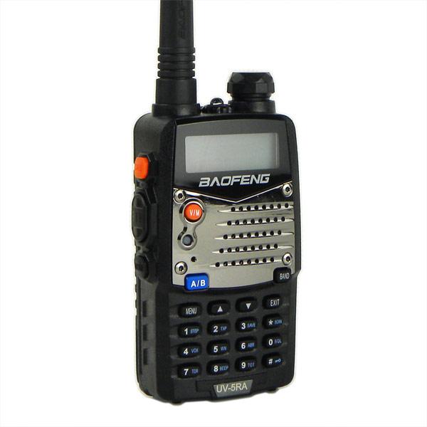

We used to use CB's down here in the deep South when we were running our hounds and hunting, but most of us have gone to VHF radio's, Kenwood, I-Com etc, and we talk truck to truck 10 or 12 miles, you can buy these radios brand new off of Amazon for 125.00 thru about 175.00 for the mobile units and get a good hand held Baofeng for about 40.00.

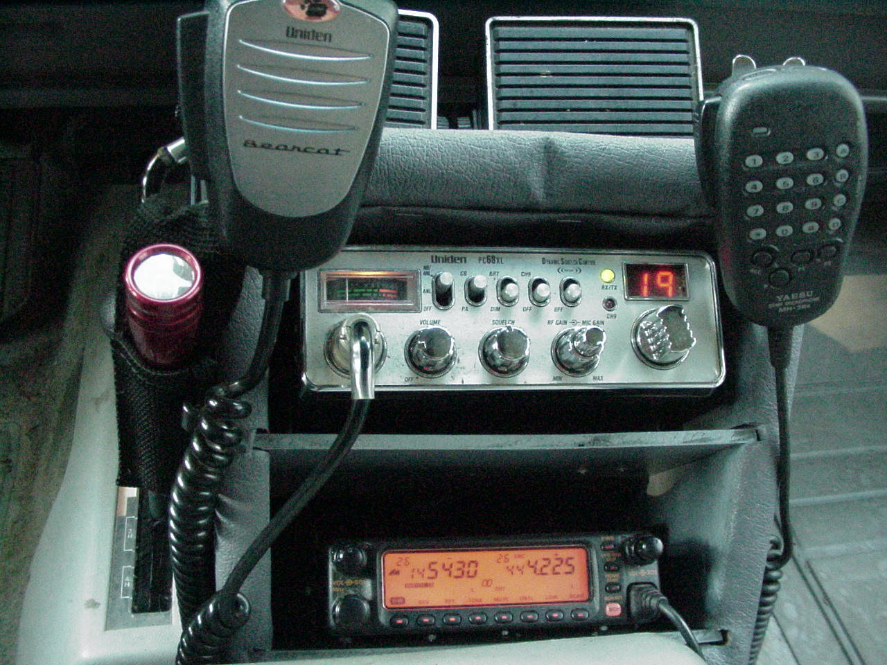

I still have my CB in my old truck, my ham radio, a couple of handheld (HT) radios in the console and usually my cell phone with me. Not many folks use CB anymore in their cars, but the truckers sure do and some 4-wheelers. I also have a portable CB radio/speaker setup that can be plugged into a cigarette lighter with a magnetic antenna that radio can sit on the hump or seat. I will sometimes loan this outfit to another driver/car (without a radio) so that both vehicles can have radio communication. I have also given a person a handheld radio to talk/guide me backing up my trailer into a tight spot when I can't see them in my mirrors for hand signal directions or hear them. I have my 2m/440 50 watt amateur radio mounted in my old truck, but I'm the only one in the family with a license to use ham radio, but that can sometimes patch into the telephone system to make phone calls with the right repeater location. FRS (VHF) radios can be pretty cheap to own, sound good and anyone is legal to use them like (AM) CB radios. Their range is limited, but work good in a large areas like parking lots, shopping malls and close together vehicle caravans. Cell phones can work too, but sometimes cost money per call/minute (like mine) or are limited to metro areas within cell towers range. I still think every vehicle could benefit from having an old tried and true CB radio mounted inside. Many years ago before cell phones, everyone in our family had a CB in their car and I still have my base station radio set up in the house with an antenna mounted on the roof that stayed turn on all day long to listen for someone trying to contact home. My poor man's cell phone service, but today there is no reason to limit yourself to any one form of communication.
