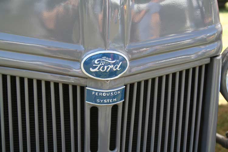

FALLON: I respect your contributions but I differ with you completely, both from personal plowing experience and from reading of Harry Ferguson's development of the Three Point Hitch.
When a Three Point Hitch mounted plow is adjusted level, front to back and side to side, the Top Link and Lower Links are in the condition of tension worked out by Ferguson to locate the VIRTUAL HITCH POINT just behind the tractor's front wheels. I do not know what load split between the front and rear wheels Ferguson desired but he developed the 3-Pt. concept, including hydraulic lift, Draft Control and central PTO location, over fifteen years of plowing trials in Britain and Ireland. Development involved the 3-Point hitch and tractor dimensions.
When Ferguson licensed his patents to Henry Ford in January 1939, Ford engineers modified the design of the two Ferguson created prototype tractors used in Ferguson's 1938 demonstrations to Ford, for Detroit assembly line production, but the dimensions remained Ferguson's. Ford engineers carried out laboratory tests and found the greater draft load on the plow, the more weight transferred to the tractor's FRONT wheels. Ford engineers were amazed. I have found interesting vector diagrams of forces involved but diagrams are in .pdf format which, alas, cannot be copied to T-B-N.
Ford produced Fordson brand tractors from 1917 to 1922 in the USA, longer in Britain, so Henry knew tractors. In 1938 it took Henry Ford only minutes to recognize genius in Ferguson's "system" relative to existing tractor designs.
While the collaborative tractors were known as Fords, they carried a plate under the Ford logo inscribed 'Ferguson System'.
Ferguson broke with the Ford company in 1946.
Ferguson's multiple 3-Point patents expired serially in the mid-1950s.
In 1953 Ferguson merged his company with Massey-Harris, which changed its name to Massey-Ferguson.
