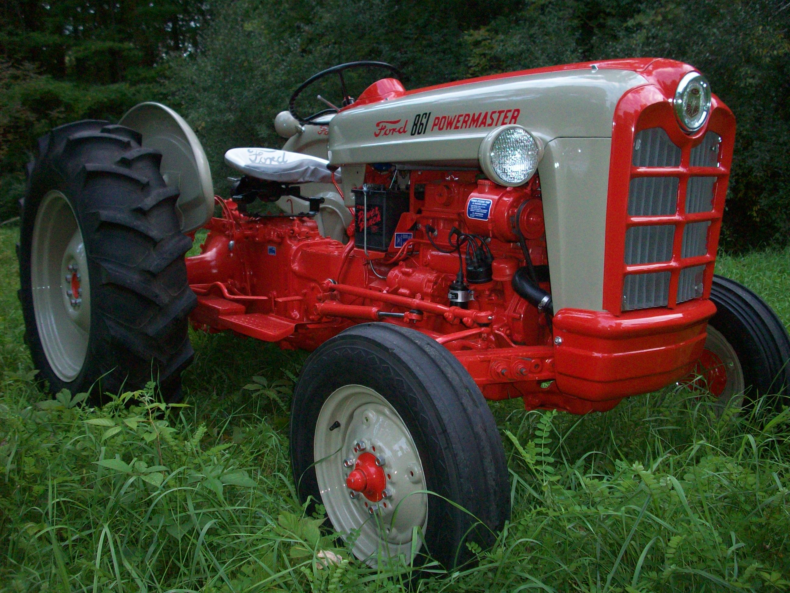

I find the old utility tractors are usually in the 2-5K range, but 9n are out there for 1500. They don't have hydrostatic or 4wd, but in many cases they are equal or more powerful than machines costing 10 times or more money. Hydro robs power. I mean a 9n is close to 30 hp, what does a kubota 30 hp of the same weight class cost? 15-20K? Or more depending on options?!? A ford 861 is not a lot bigger footprint than an 8N but it's around 60hp, that's just nuts! Power steering, live hydraulics, live PTO. They sell for 3-5K. Probably 30-40K for something like that from Deere or Kubota I'll bet. Lots of retired farmers restore old tractors as a hobby, and there are some great running machines out there. Just don't buy one that's beat all to **** and left outside all year for 50 years, heck for the money you save you can buy two so you won't be lacking the use of it when one of them needs repairs.
I'm actually envious of the people in Wisconsin. The farm density is higher or has been higher due to all the dairy farms, and it's like a utility tractor paradise over there! I wonder if it isn't the best place in the USA to buy old american tractors. Close to Michigan too where they made a lot of that stuff! When I get bored I look on craigslist tractor ads and think "if only that beauty was here and not 500-700 mi away in Wisconsin!"
Look at this beautiful piece of old American Iron!

I think you're suffering from "Grass is Greener" Syndrome. I am in Wisconsin, and you'll pay dearly for good old Iron, not quite what East Coasters pay, but normal prices. You can buy ragged out junk anywhere, but good old iron sells well. My 4430 came from Iowa, my 4840 came from Illinois. Also, there's always unscrupulous junk jockeys that will patch up a junker, put some nice paint on it, and sell it to someone who doesn't know what to look for. And there are the shelled out machines at consignment sales.
That's why my recommendation to Arrow was to skip the 4 wheel tractor and hire the work out. You can buy a tractor cheap, then pay for it twice more pretty easily. And I definitely wouldn't recommend an N series for brush hogging. Non-live PTO has gotten a lot of guys injured, and a few guys killed, while mowing without overrunning clutches mounted on the PTO. That, and the fact that it makes it a pain to mow. You push in the clutch and the mower stops. They're not great for close-in cultivating because they only have rear mount cultivators.

This is a great discussion. Hopefully the OP is getting something from it. Don't get me wrong on old tractors, I love the way they look, their simplicity, and how much machine you can get for the money. There's some truly great machines out there.
I'll agree with Bill here (fun how we can take turns agreeing with Bill) about the N series, though. They just aren't worth buying. Yes, an N has it's place, but in my opinion, that's limited to pulling around a firewood trailer, driving in parades, and maybe some draft stuff, pulling a plow etc. They are unsuited for tilling with a tiller and dangerous for bush hogging. Actually, they are dangerous for just about everything, especially in the hands of a beginning operator. Also, I'm not sure how much time you've spent on a CUT, but there are just not any situations where a 9n is equal to or better than a Kubota. Your argument that they have good HP is fine, but their gears are unsuited for vegetable production, and there aren't many applications for stationary belt power on a veggie farm. Also, a 9n might have had 30 HP at the engine in 1940, but I don't think you'll find many making that on a dyno today.
Remember, I both love old tractors, and grew up farming veggies with N tractors, so my advice is not computer jockey advice. My dad farmed veggies with an 8n from 1974-2013. I've spent countless hours tilling, mowing, discing, etc with an N.
Now, that said, there's plenty of other tractors but much newer that are much better suited. Unfortunately, if you want to run three point equipment, which is a huge plus, we have to skip most of the farmalls. There's great machines there, just not as a first or only tractor (if you've got other tasks around the property anyway). There's good Fords, internationals, and Deeres in the sub-10k price range. Lots of good machines that'll farm veggies just fine. BUT you better know how to fix them or be prepared to learn fast. You'd also better have an "oh-*****" plan in place for when you NEED your tractor today and it won't run. If your neighbor is a friendly retired mechanic, with three tractors he'll lend out, then maybe old tractors are for you. Otherwise, newer machines have a serious benefit.
