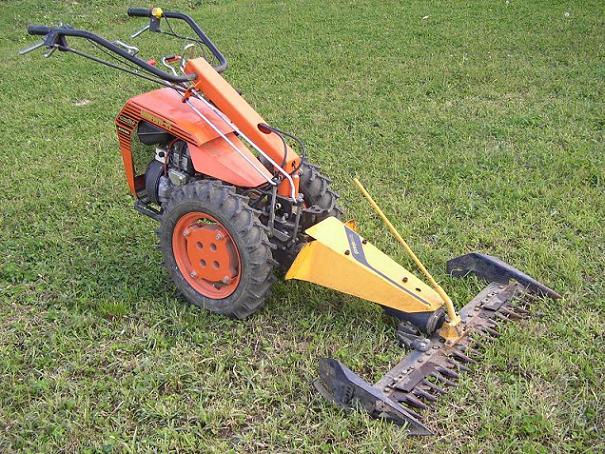

I'm from other side of pond, and don't know what's available there.
Here we have lot of brands, but most famous is Goldoni and his clones. Pretty good and reliable machines.
BCS, SEP are known but not that popular. BCS is known as producer of excellent mowers, for communal or ag purposes.
I had 2 walk behind tractors, and one of them was 8hp gas engine, Goldoni clone, produced locally. It had direct shaft and 4.00-8" wheels. Excellent machine for tilling.
Now I have another locally produced walkbehind tractor, with equal engine, just different tranny. It is not as good for tilling, but is good for mowing purposes. It has 20% faster PTO speed, shuttle with 3 speeds, one fast (10mph) speed for road and differential with separate brakes.
I have several attachments, and some of them are home built.
If you have particular questions, feel free to ask. /forums/images/graemlins/wink.gif
On pic: tractor on 4.00-12" wheels with sickle bar mower 35"

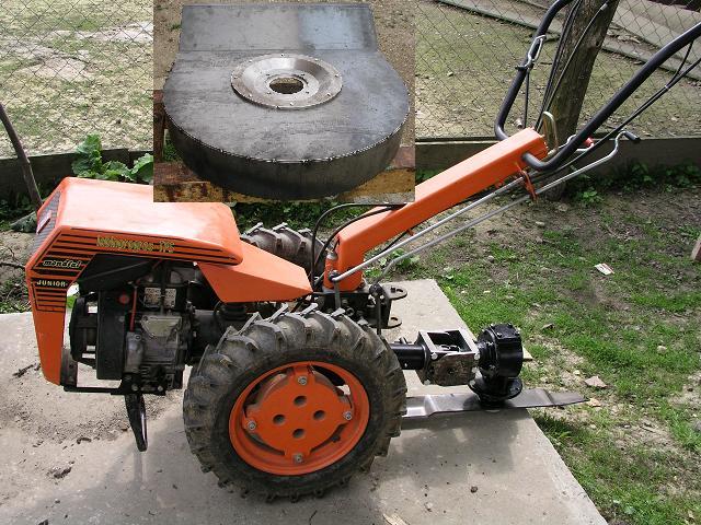

Current project: 24" rotary mower in testing phase. Mower housing on smaller picture
