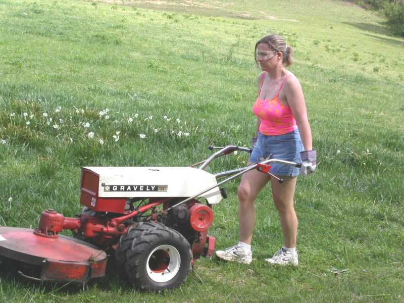

Gravely...
"There is no brake other than the forward/reverse lever. "
Yeah... I know about this one !
1st time at a Gravely's controls... ~age 10...
...almost pushed my Aunt's 1950's Chevy over because I didn't know how to stop the tractor... went straight into the passenger's door... /forums/images/graemlins/shocked.gif /forums/images/graemlins/shocked.gif
Powerful tractor... !
Dave...

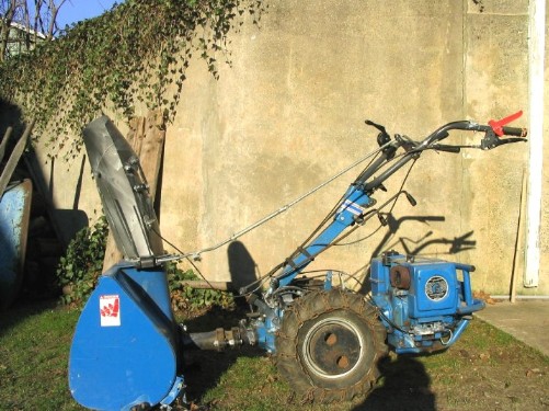

I found in my archive picture of model Super Lux 150, with 2 cyl diesel engine.
   / 2 Wheel Tractors - Buying & Using #38
I'll have to look at it more closely, but I don't think it's a three speed. Maybe that's for the 150 models. Mine's the little 140. Do you have a picture of the gear shifts? That might clear it up.
   / 2 Wheel Tractors - Buying & Using #39
I'll look Darren.
We have here model 140 locally produced, by company TPS. All of them have ground pto. When you shift it in that position, pto stops, until you move tractor forward or reverse. When tractor is in move, pto rotate forward and reverse, too. I mean lower pto, where you attach tiller.
Switch pattern is: SYNCHRO-Neutral-FAST-Neutral-SLOW if my memory is good.
I haven't this machine, and it is my object of desire.
BTW, 130, 140 and 150 have equal, iron casted housings. Attachments are fixed by two M16 T-screws. Is like that on your machine?
Does your machine looks like one on pic?
