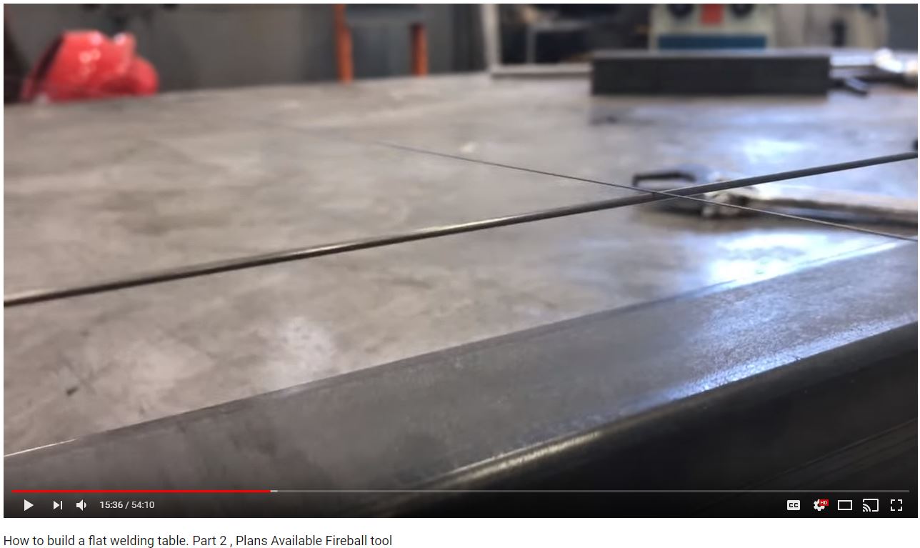

About a year ago I made myself a bigger welding table and one of the things that got me scratching my head was how to ensure the top was flat. YouTube was a good source of inspiration at the time and as usual, ever since it keeps throwing up suggestions for things it thinks I should watch. Most of the time I ignore them, although this one caught my interest when I came in for a warm up and a coffee this afternoon and after watching both parts, I thought it worthy of a mention here as I know many of you appreciate a bit of good engineering that is well presented and may not have seen this.
The first part has a lot of intro (I must confess I mostly skipped through the section where he was just measuring the flatness of a commercial welding table), then shows a high quality welding table build How to build a flat welding table. Part 1 , Plans Available Fireball tool - YouTube
The second part is what really wowed me. It shows a simple technique for checking/adjusting for flatness that could be applied to any metal surface, using just 2 lengths of taught music wire, a ball bearing and a buzzer - something I have never come across before. There is also a good explanation at the end about the thought he put into reducing human error in marking out a flat plane How to build a flat welding table. Part 2 , Plans Available Fireball tool - YouTube

Interesting, Eric. Of course, it presumes the flatness of the bench he's moving the clamped bar along to be accurate. It is an interesting method to establish a plane, to be sure.

Lots of good fab tips (and plugs for his various squares), but I'm not sure how practical the method is in anything but a well equipped industrial shop. A saw horse will move as soon as you try to apply tension to the music wire, as will a ladder. And unless the floor is very level, there's going to be errors because the fixed string will reflect any un-levelness in the floor. Unless you can figure out a way to use a level on the wire, and a very good level at that. But then as soon as you touch the wire with tle level, you will change the lay of the wire.
If all you're trying to do is get the plates on the table into the same plane, I'd start by leveling a center plate, then use a straight edge and shims to adjust the surrounding plates to that first plate. If you have three 1-2-3 blocks (two under the straight edge on the center plate, the third on the plate being leveled), they would be easier to use than shims. Yeah, it would take some time, but it would eliminate all the monkey motion and Rube Goldberg stuff with the wire, ball bearing, and beeper.

Sag on the wires was my first concern when working to a few thou, however looking at some other sites suggests gravity effects on a thin taught wire are insignificant over a short distance. I agree his setup looks a little awkward, but the principle is there to be applied to whatever anyone's imagination can come up with.
With my limited welding skills, a table that flat would be wasted on me. Once I had straight edges on my table, I got my slatted top near enough into a single plane using thin fishing line pulled tight across each diagonal, raising and lowering a corner until they only just touched one another.
Actually, it doesn't. He is using the second transverse WIRE as his point. The other end can be off any amount, he brings the wire back to plane against the other wire. The wire will be 'flat' given enough tension between its points. And if the wire is essentially 'level' or a close approximation, the table will also be level.
The most important thing is that the table is flat compared to itself. Not compared to the poured concrete floor.

If the bench he's moving that transverse ware across isn't flat, then it will affect the results. If it is, say, higher at one end, or has a bump in the middle, that will throw off the level of the wire as he's moving it along that surface.
I'm not questioning the wire, but rather the surface the wire and assembly are mounted to.

He is adjusting for the flatness of the table by adjusting the wire up and down. There is another wire across the 2x2" steel square tube that is under high tension, ensuring it is flat. He adjusts the wire that he is traversing across the table to just barely touch this wire, establishing a flat plane.
See this image from the video:
