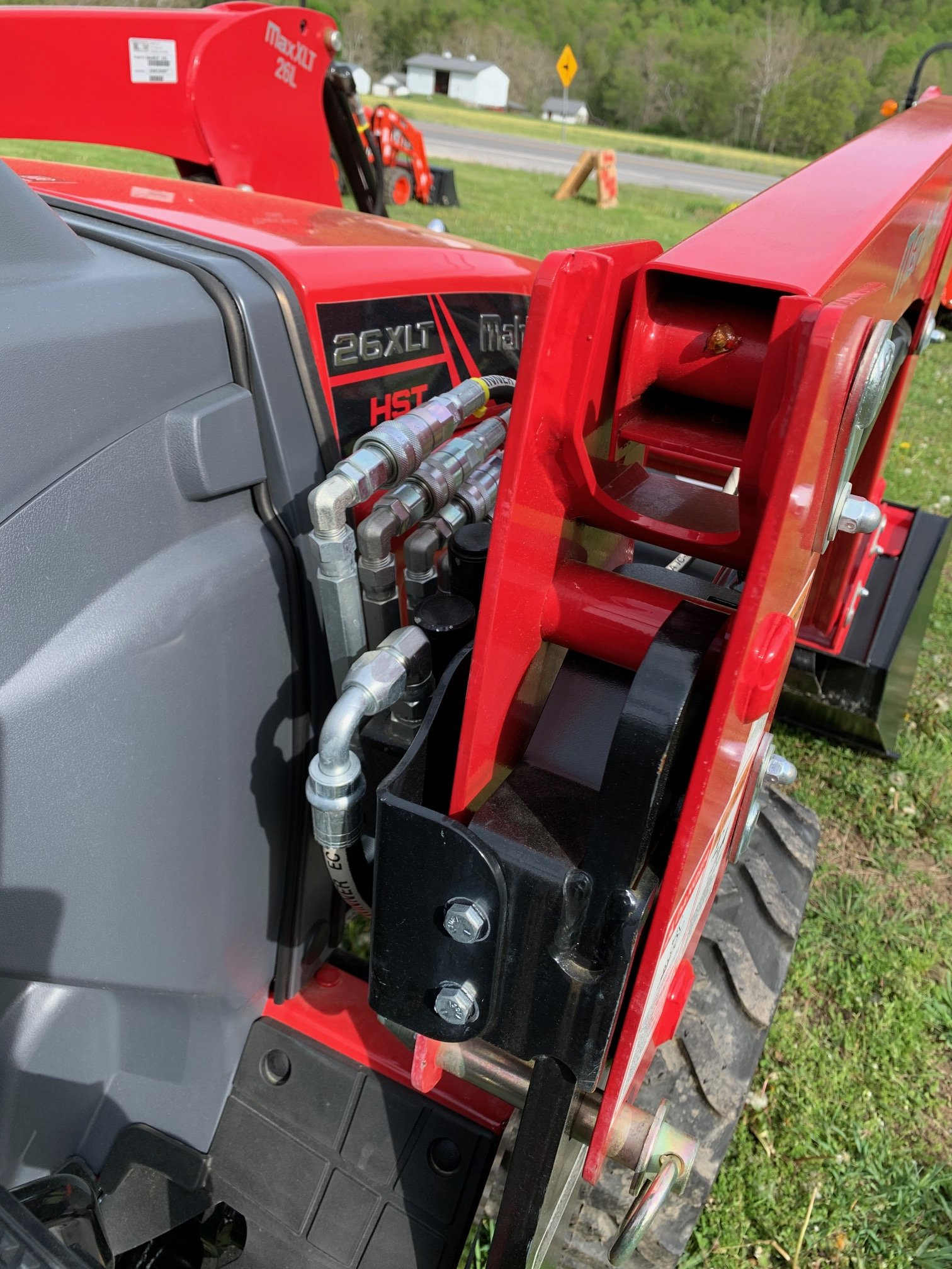

Long story short, my local dealer has a Max 26xlt with Ag tires (i must have Ag tires). It arrived to their lot in August 2020 and has the curved boom, rigid and flexible lines, Korean Built, model max26L. 5 photos are just below and my questions at the very bottom of post

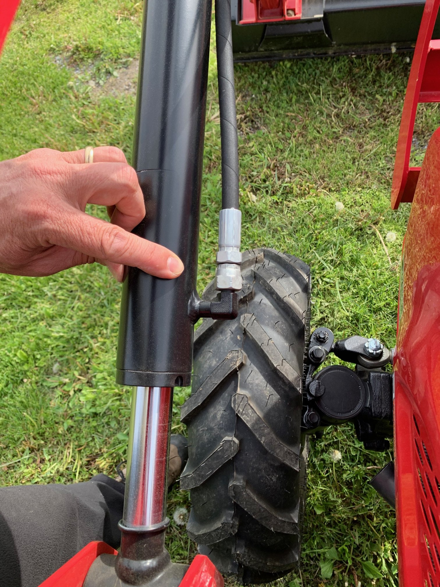

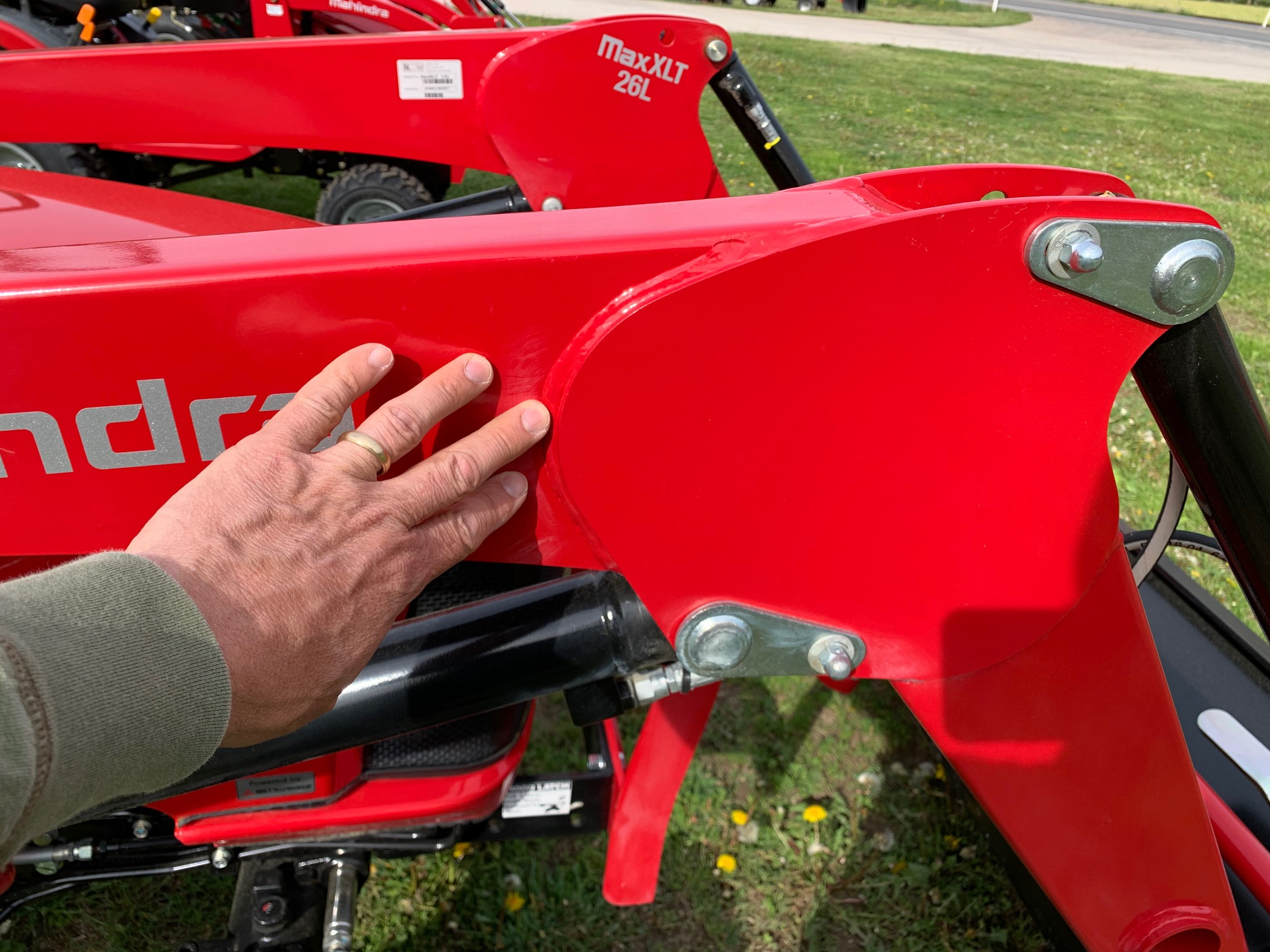

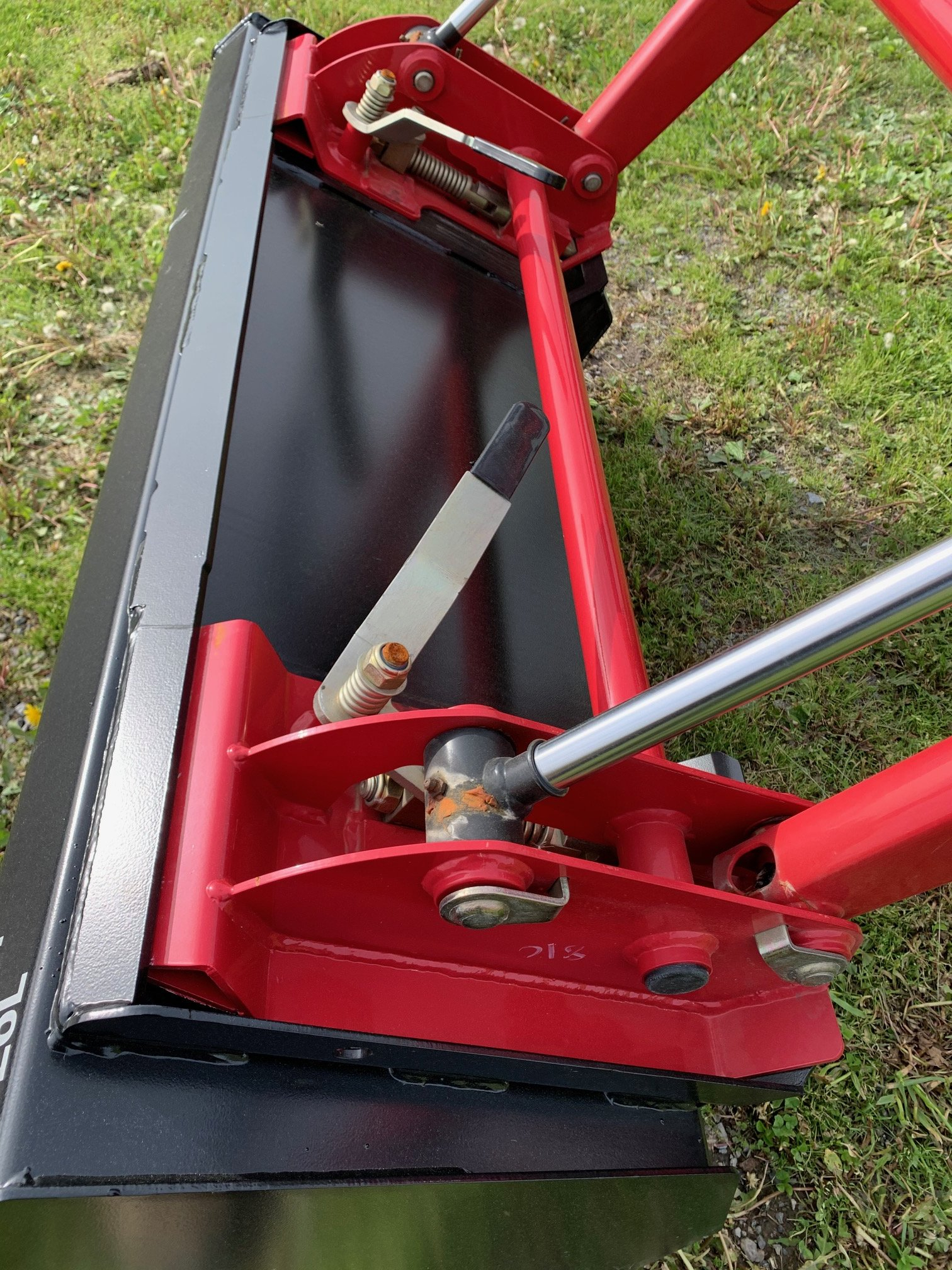

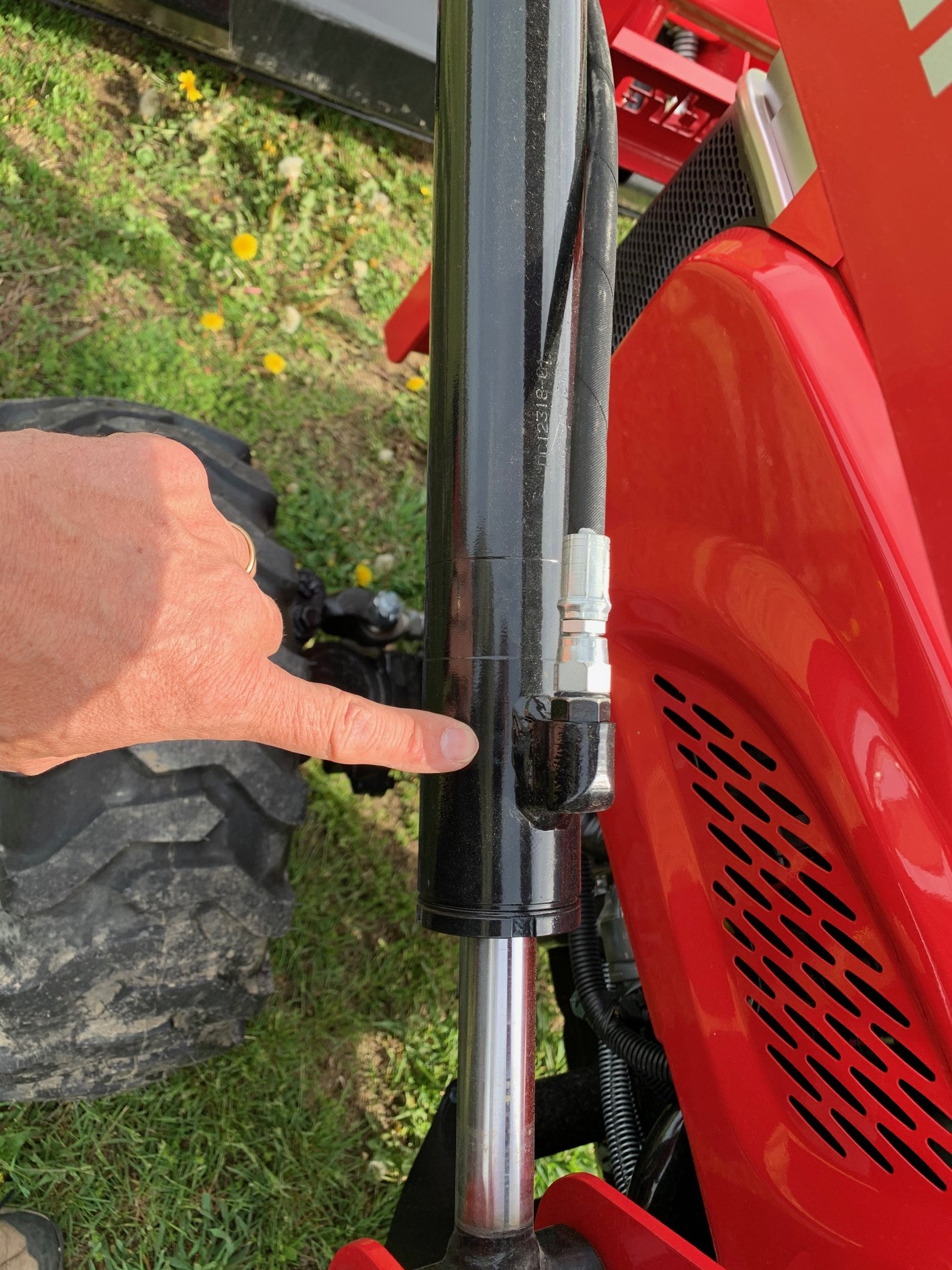

On the other side of the lot, they have another Max 26xlt (with industrial tires) that arrived this spring and has a straight boom, larger knees, thicker tubing, all flexible lines, beefier hose mounts on the hydraulic cylinders, made in USA model maxlt26L. Second set of 5 photos just below and my questions at the bottom of the post.
If you compare the two sets of photos you can see considerable differences. The USA build unit just looks heavier duty.
A new brochure was on hand for the MXLT26L. Out of curiosity, the dealer pulled a 2018 brochure for the same MXLT26L. Every specification was exactly the same in the 2018 literature vs the current literature. The dealer is sharp and they said there has not been any info. from Mahindra about a change in loader manufacture nor specifications for the MXLT26L...?? So I figured I would post up looking for answers.
Why is there a new USA built loader on the 2021 models? Has anyone had issues with the Korean/curved boom loader? Those hydraulic fittings on the Korean built cylinders just look wimpy compared to the USA unit along with several other features. I prefer the USA built loader but it comes with the 2021 tractor which has industrial tires. They wont switch out the industrial tires/wheel (for the ag tires/wheels) with the new, USA built loader. Remember than the loader warranty is ONLY 1 year.

Not sure if it’s still the case but the max series was a Mitsubishi made tractor. They were shipped to the US and asssembled using US manufactured loaders and backhoes. KMW and Ameriquip were the names I recall. Don’t know if the 2 models you’re looking at are still made by MHI and not familiar with the Korean loader

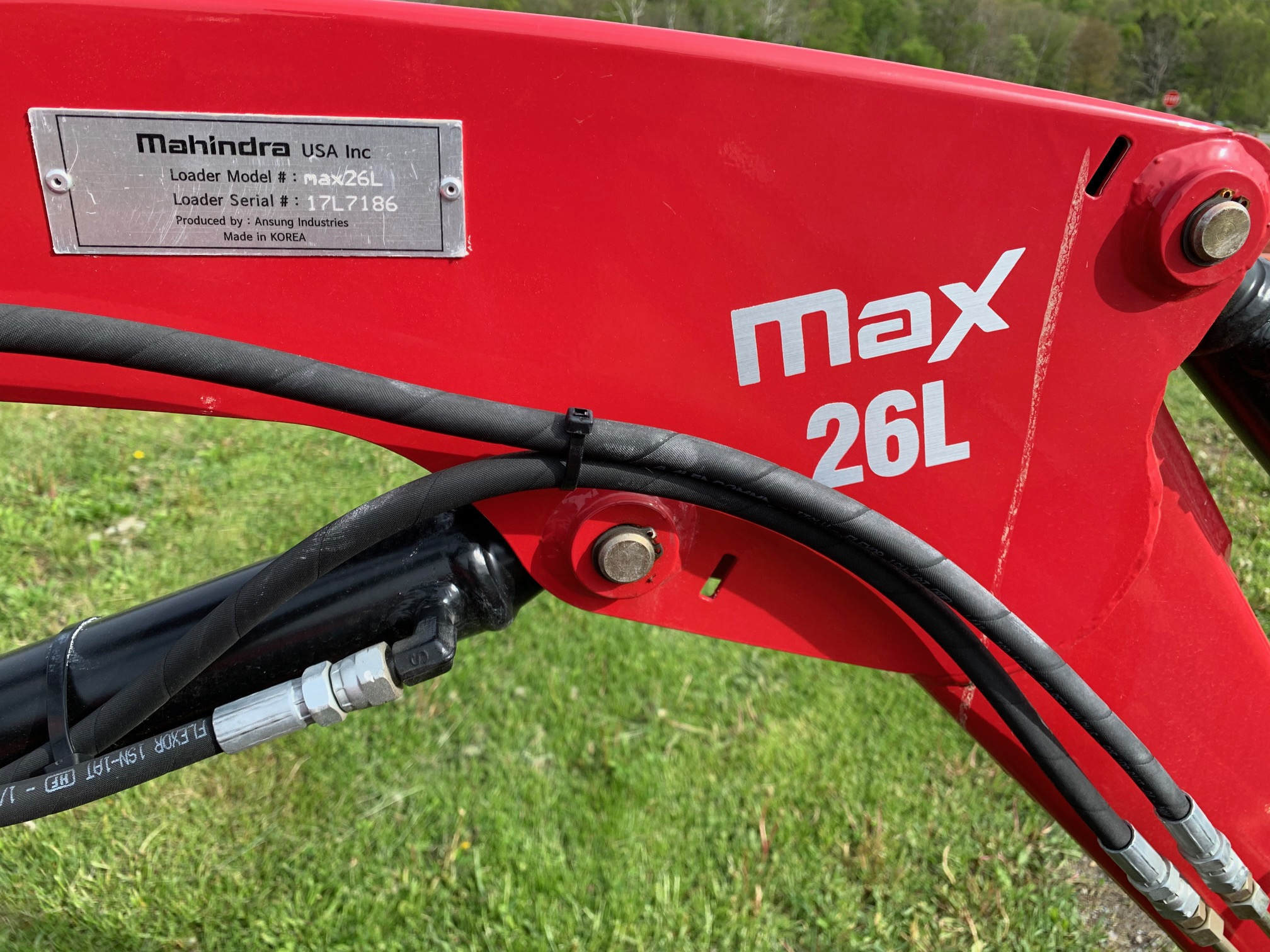

It looks like the sticker in one of your pictures shows the loader was made by KMW. That’s who made mine and I’ve been very happy with it.

KMW, Kansas Machine Works, not made in Korea.
hey, good catch! Went back to the photo and read the fine print. The loader is Made in Korea, but not produced by KMW, my error. Its made by Ansung industries. See photo. Gosh those letters are small. So thats at least 3, maybe 4 different manufacturers of loaders for the Max 26xlt.
