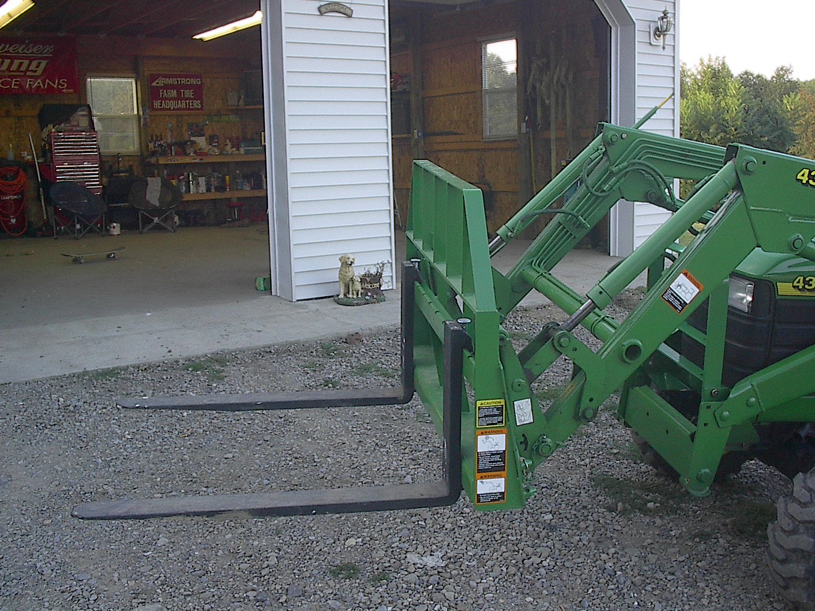

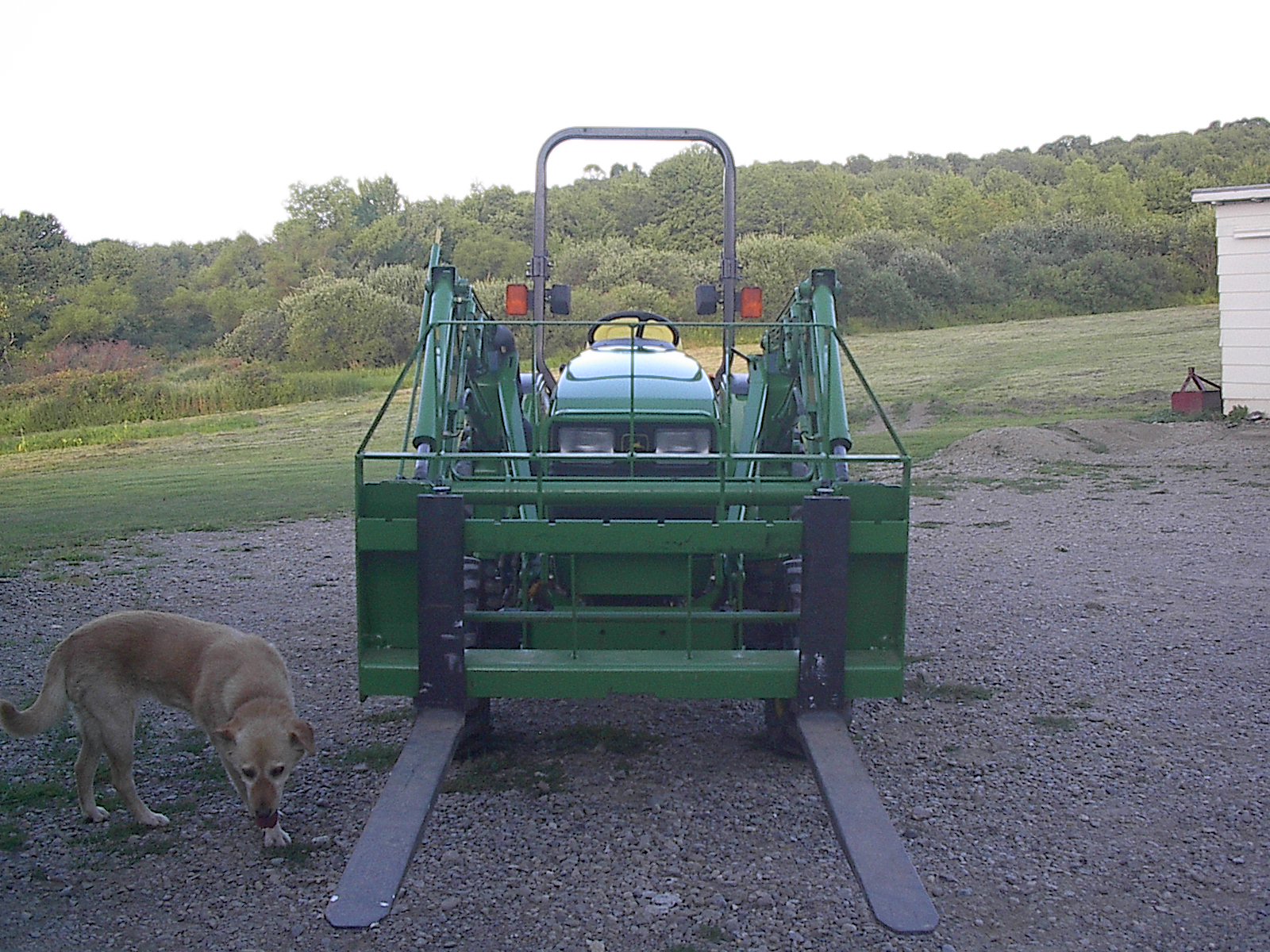

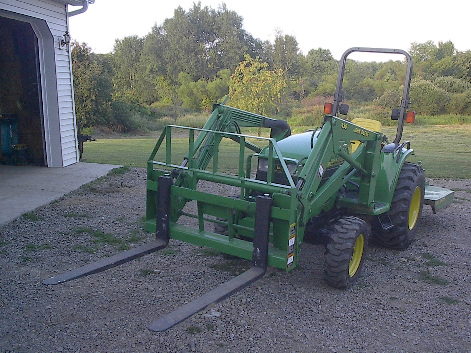

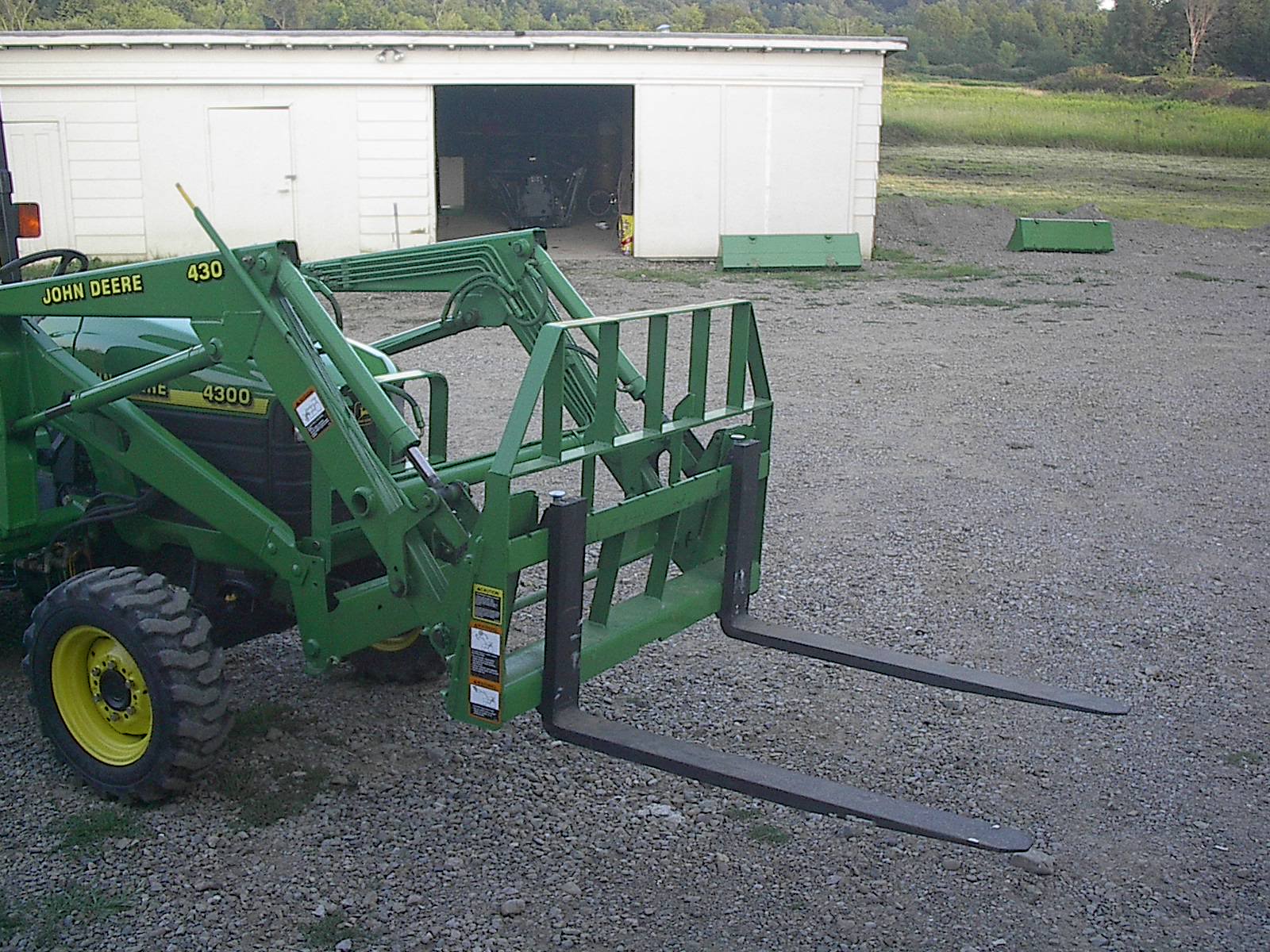

yes, they take the same forks as the 300 and 400 series loaders.
The 200 and 300 have the same pin/hook dimensions the 400 are different/bigger. I see now the newer forks have 2 sets of pins so they will work for the 200-400 series, my earlier model Horst forks only had the one set of pins.
I vote for the Horst cast pallet forks as well, I paid over $900. for mine, but when compared to the Deere ones I liked the Horst better, bought them from Deere dealer.
