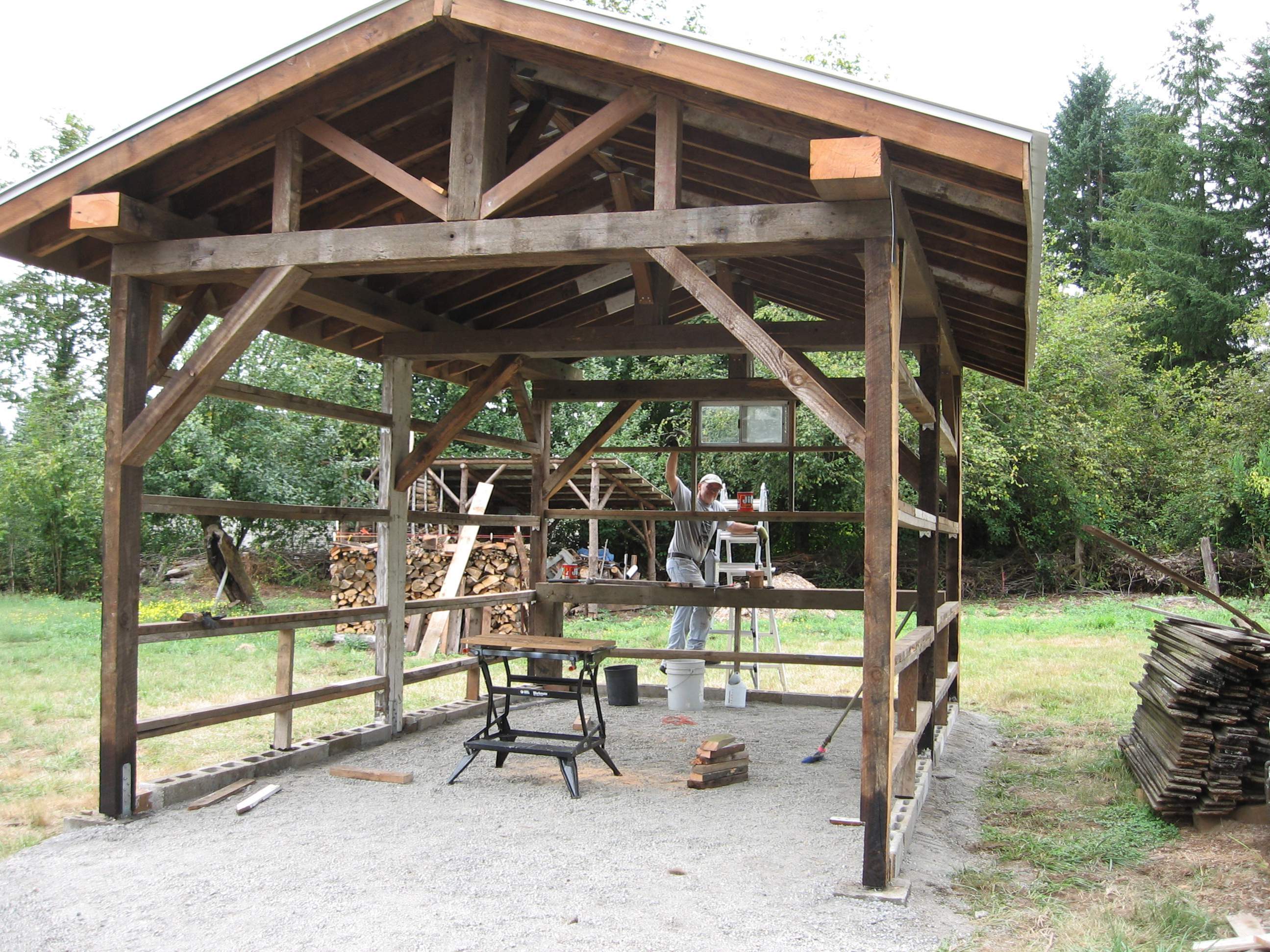

200 square foot post and beam "barn" from salvaged wood
   / 200 square foot post and beam "barn" from salvaged wood #11
That's a healthy looking frame! I think you won't be able to pile enough snow on it to collapse it ;)
   / 200 square foot post and beam "barn" from salvaged wood #12

Nice work. When in doubt, build it stout:thumbsup:

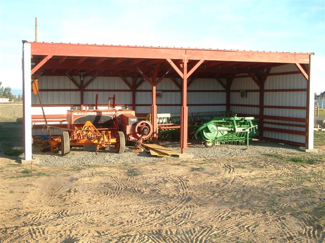

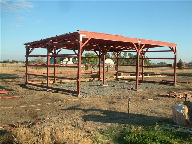

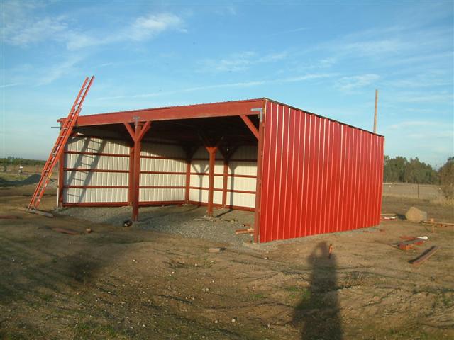

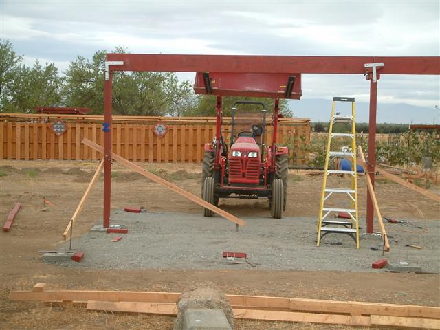

I built a 20x28 pole frame building a few years ago for my equipment. Used the same foundation idea you're using.
Equipment shed-1.JPGEquipment shed-2.JPGEquipment shed-3.JPGEquipment shed-4.JPG

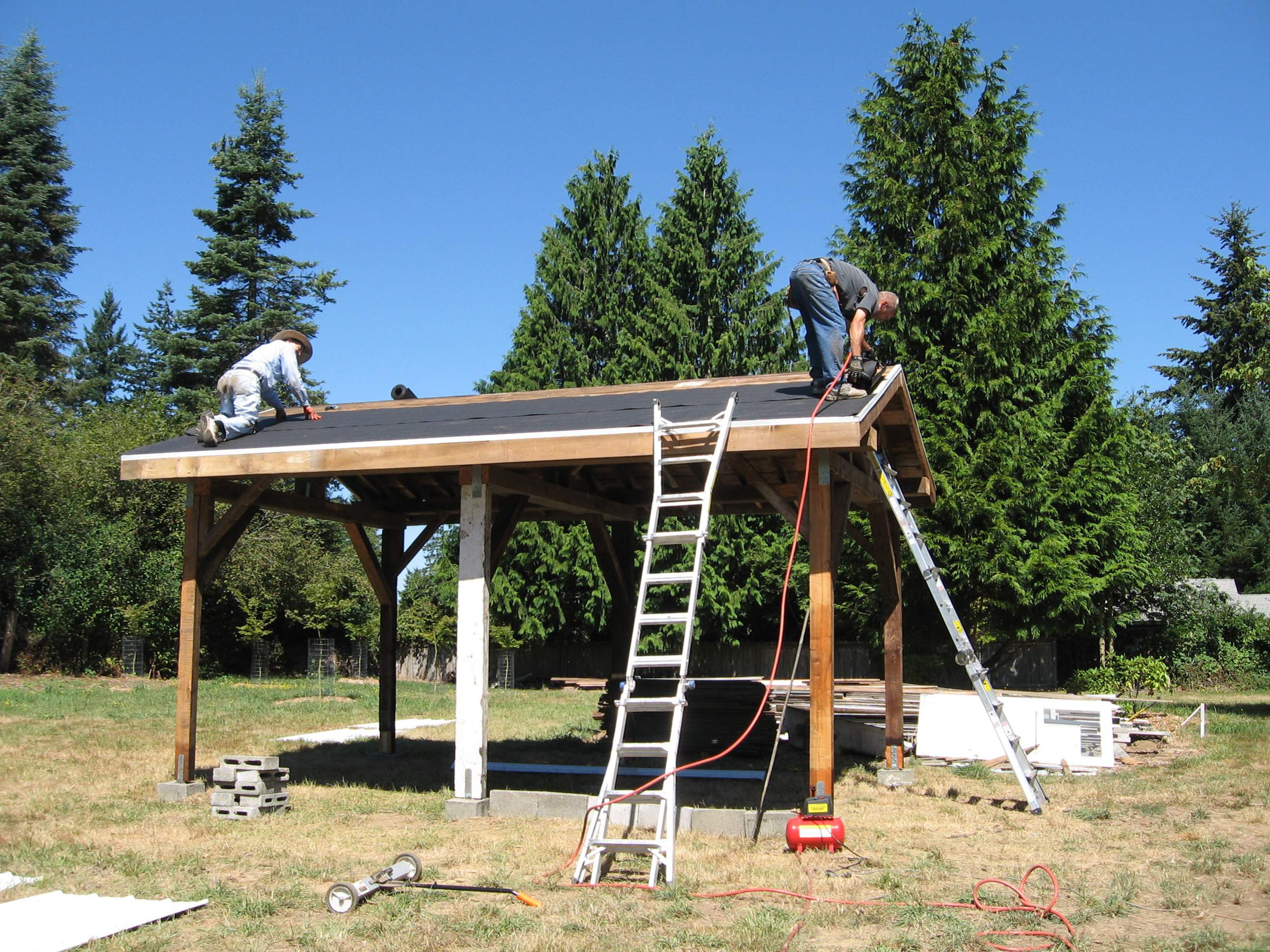

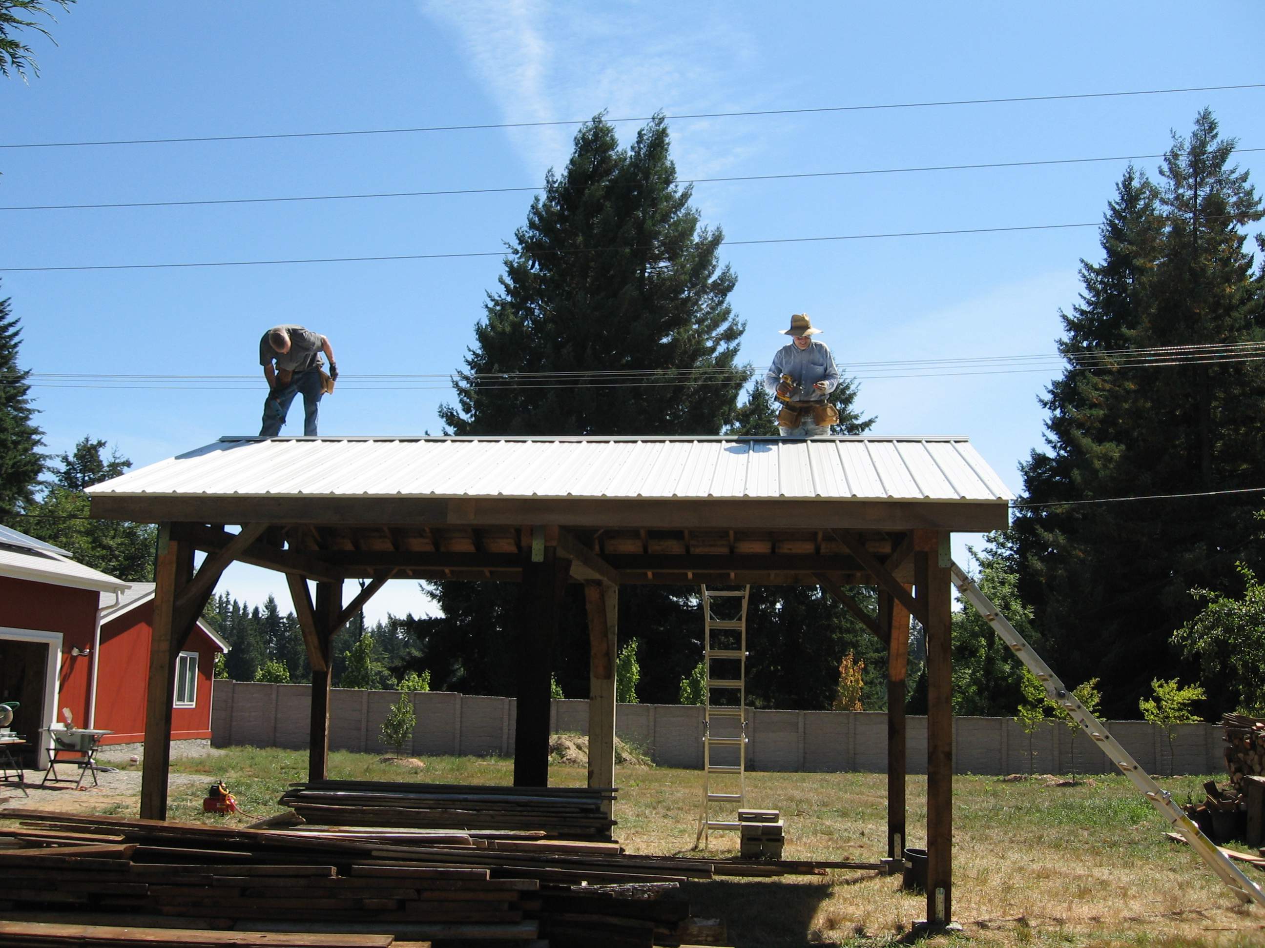

Last weekend we got the roof on. This week I spent my time getting the floor graveled, the cement-block skirting placed, and framing up the supports for the siding. Next steps, siding and doors.:cool2:

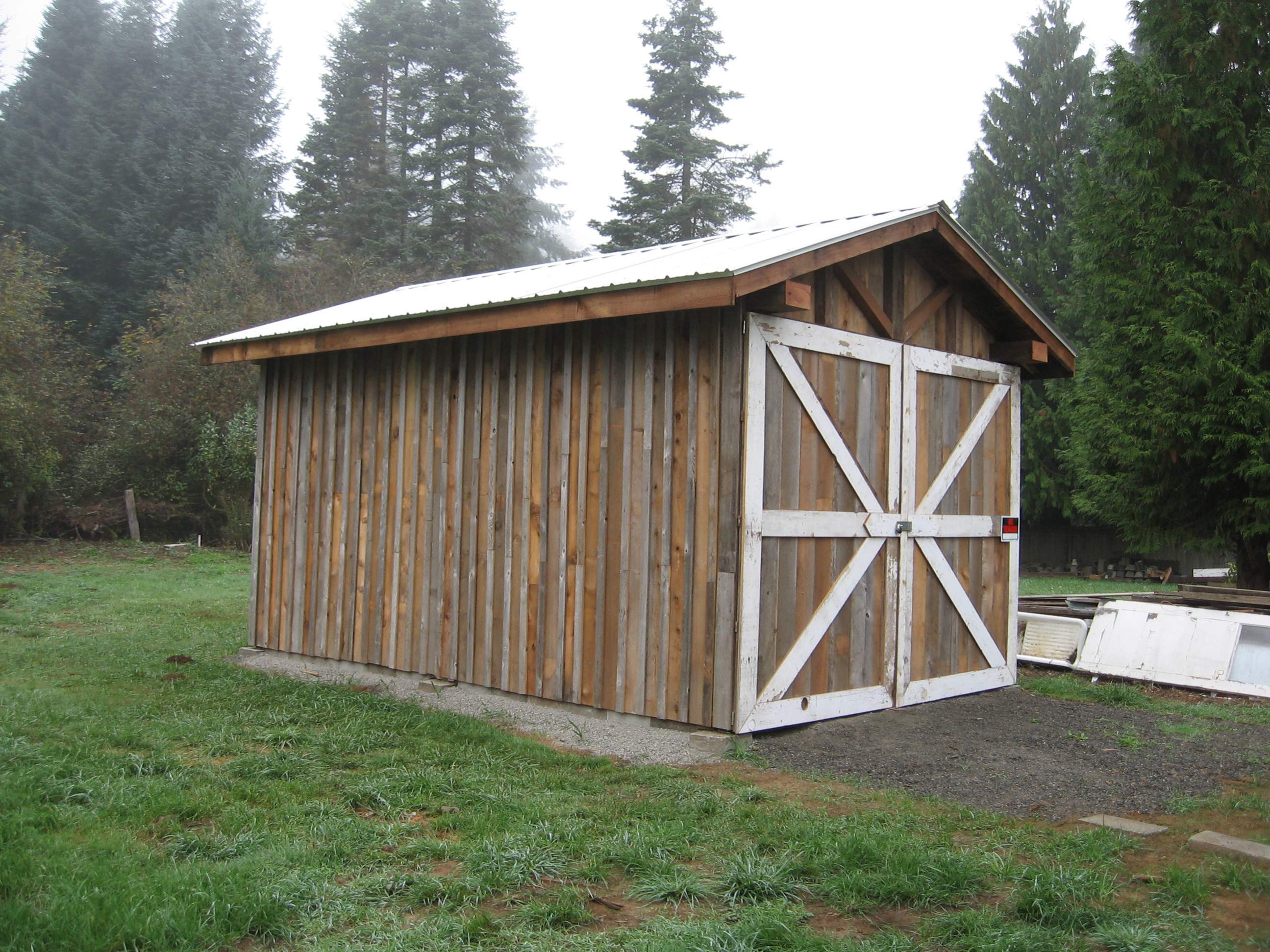

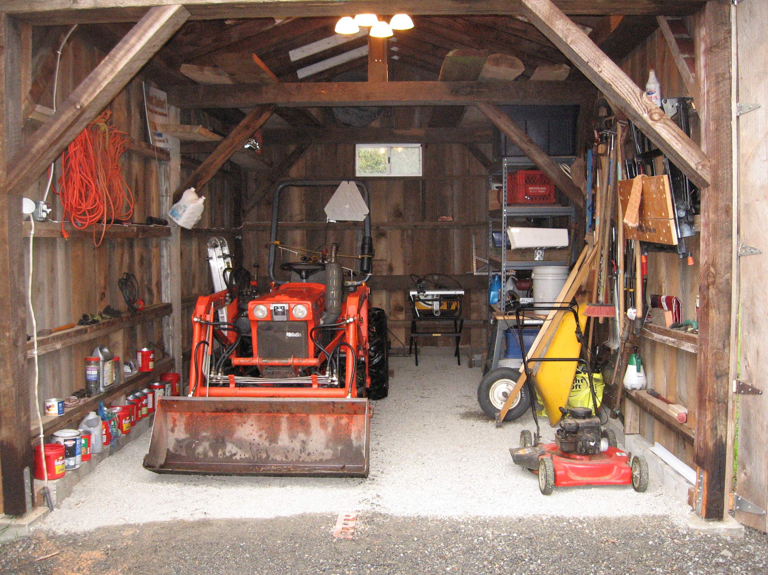

Finished (except for the gutters)
   / 200 square foot post and beam "barn" from salvaged wood #20
Looks great. I love seeing those old timbers getting re-used. Thanks for sharing.
