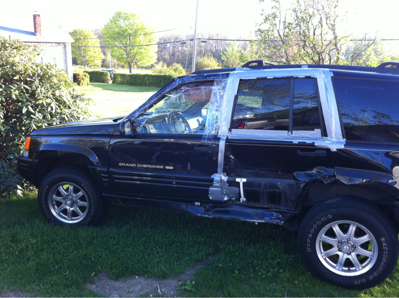

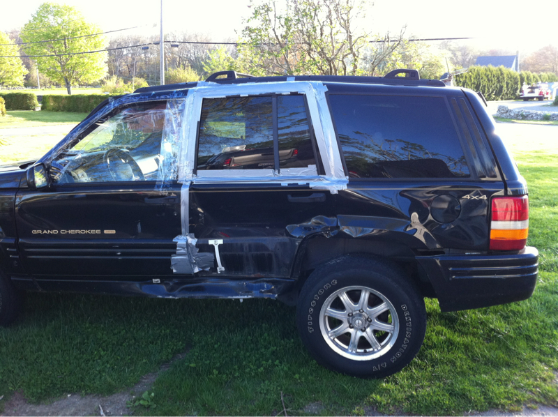

I have owned for myself a Cherokee pioneer with the manual transmission(Olympic edition), a Cherokee sport '95, Grand Cherokee limited v8, as well as 4.0l, a grand Cherokee TSI, and currently a Cherokee limited 2001. Only one of these vehicles had a v8, which gave at best 16 mpg. The straight 6 4.0l HO engines were all great, I never had an engine, or transmission problem. Brakes were frequent and expensive in the V8, but cheap and easy in the 4.0l straight 6's.
Just like you, when my daughters came of driving age, I chose jeep grand Cherokees for their safety, dependability and reasonable mileage. Parts are available everywhere, cheap, and anyone can fix these! And of yes, each of my oldest 2 daughters totaled each of their grand Cherokees!!! But thank god (and Chrysler), they weren't hurt. Had they been in smaller, more fuel efficient vehicles, I shudder to think of what could have happened! After being totaled, the local jeep guys bought the weeks from me for $350-500!!!!.
My used grand Cherokees were all purchased for between $3,000-3500 with 97k to 120k miles and have been good cars, and protected my daughters as I hoped. From your description of the vehicle you are looking at, it sounds way too expensive for the mileage and condition. You may be surprised how many really great condition keeps are around for much better prices and with much better mileage than what you described!!!! But yes, I think one in good condition makes an excellent choice for a first car for a new driver. In fact my 13 year old is already asking if she will inherit her older sisters, or when we will begin shopping for hers!!!!!!

   / 2001 Grand Cherokee #15
PS, this was my oldest daughters '99 after she decided to suddenly make a U-turn across Grandin rd in Roanoke (5 lanes) after missing her turn and was broadsided by a car parts delivery truck at 40 MPH. Luckily no injuries!!!! After being checked out, she was fine, the jeep drive able, she drove the 600 miles home in this jeep the following week!!!!
