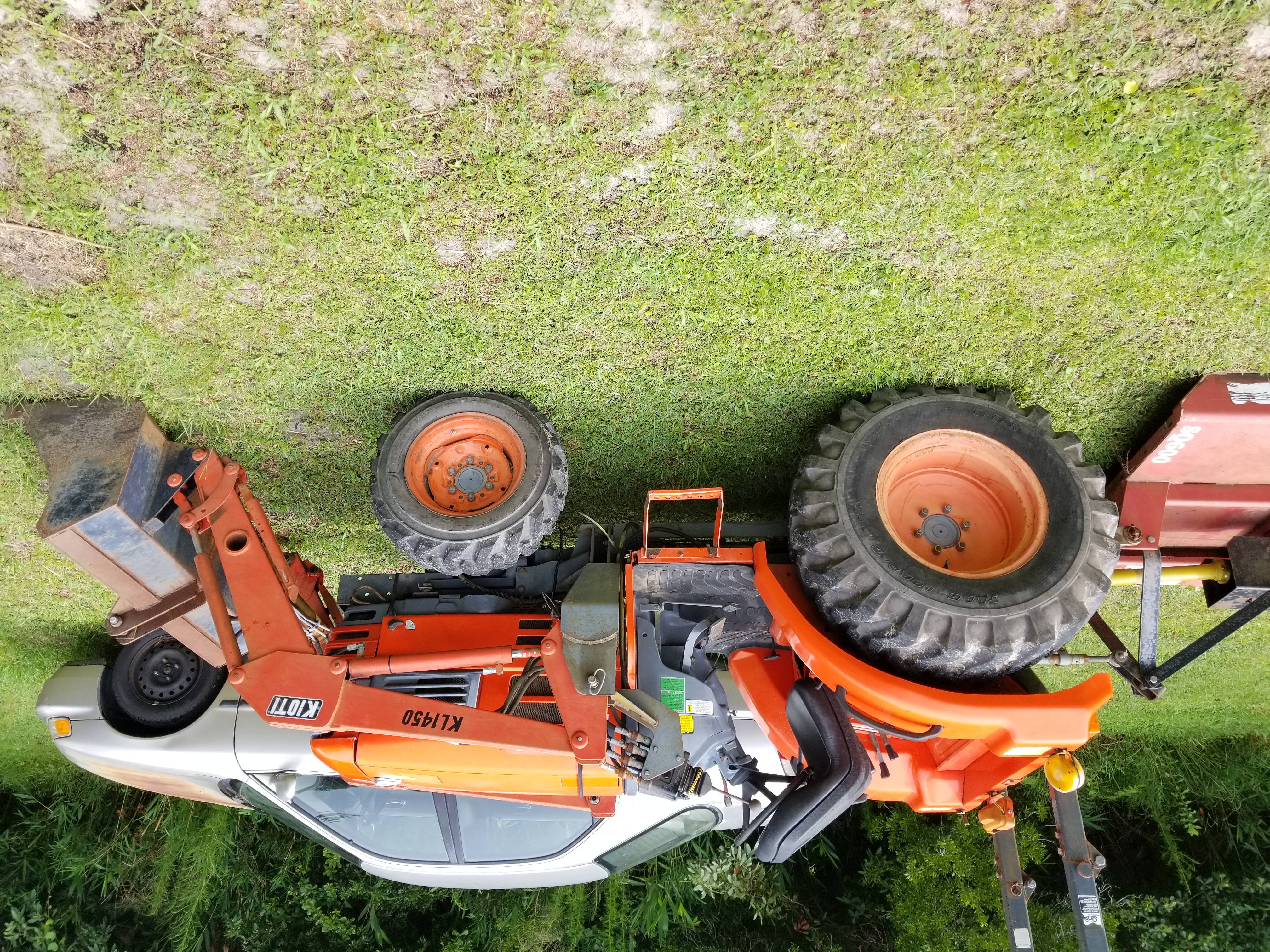

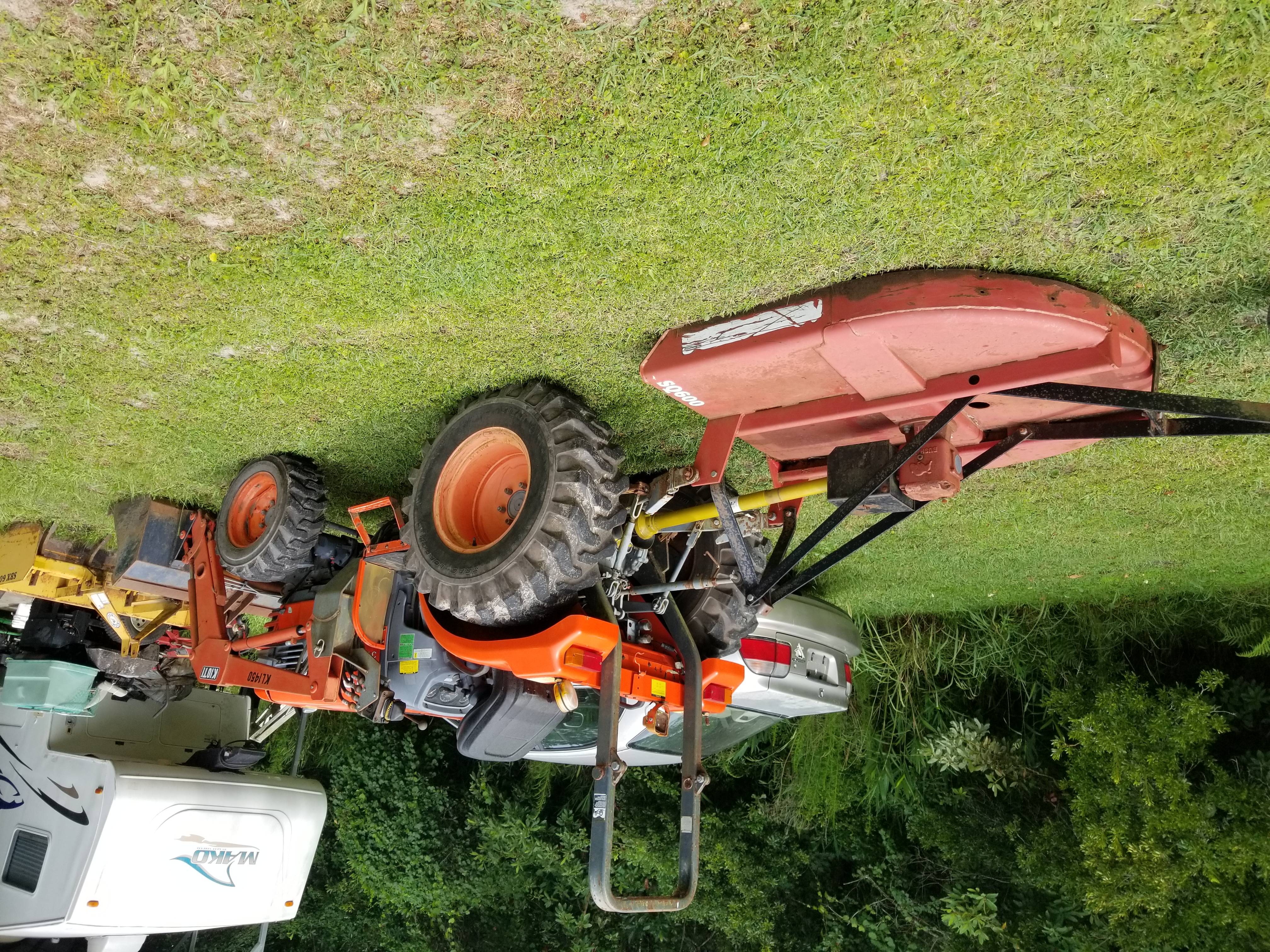

could you have used2 1/4"or 2 1/2" cylinders? plus i dont know what you mean about the bucket pins ,do you have a picture? also did you up the psi any?
   / 2002 kioti dk35 or 2002 branson 4020 which would you buy? #20
I had to alter the linkage (linkage where the bucket curl cylinder hooks to the bucket) for the 2" cylinder to clear the loader arms with the bucket rolled all the way back. Plus I was concerned 2 1/2" cylinders would slow the dump/rollback speed to much.
Bucket pins. The pins for bucket. The lower pin the bucket is attached to the loader arms, and the upper pin where the curl cylinder attaches to the bucket. I have the Skid steer style Quick attach (SSQA) and the upper and lower pins where 5" apart. I moved my curl pin up 3" so they are now 8" apart.
As far as pressure. The book calls for 2300 PSI. I have mine set at around 2450 PSI.
