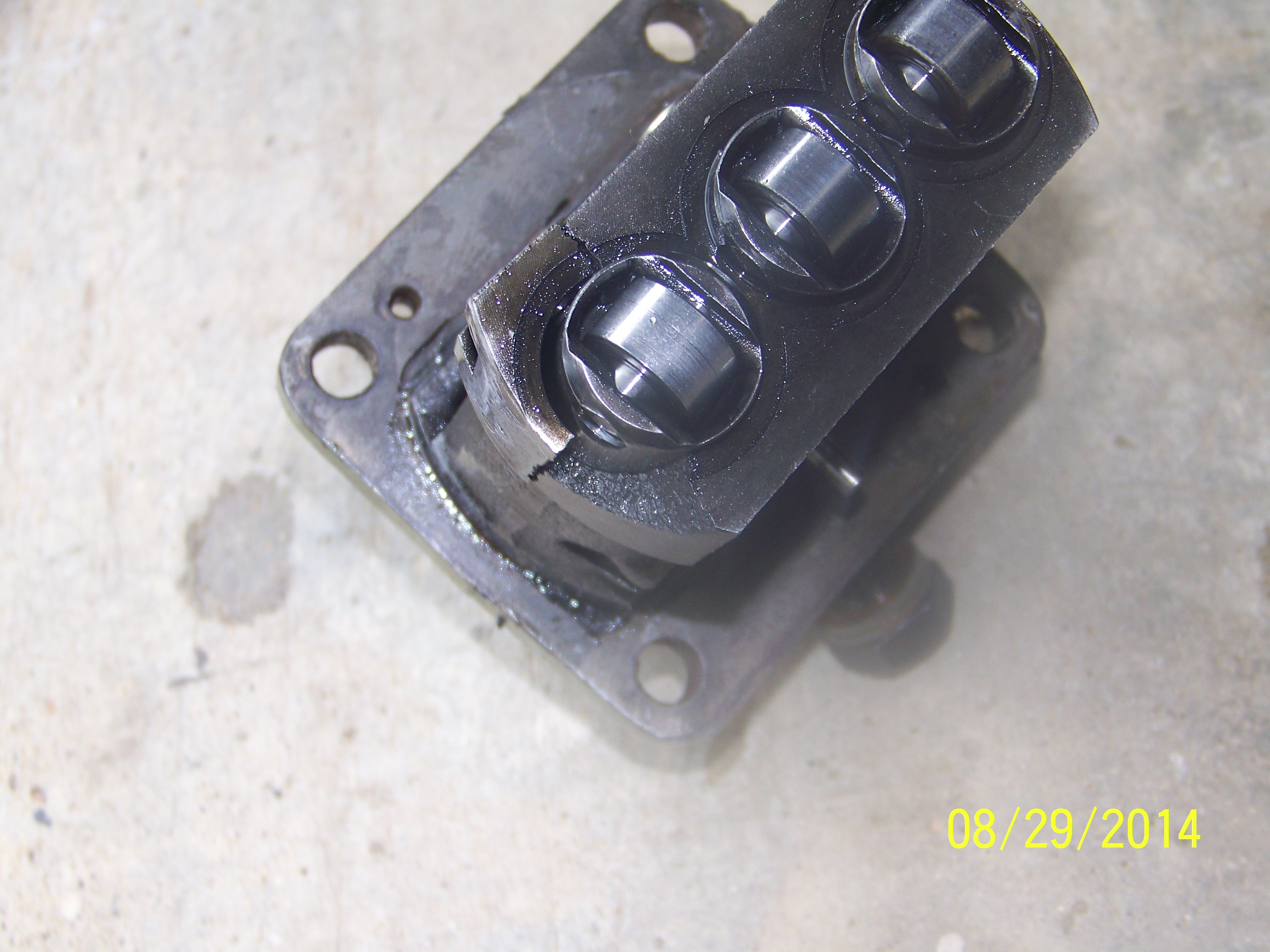

As the followers of this forum know I am constantly messing with my tractor. This may get long but is not required reading. As stated before my 2002D was a Vietnam refurb and has dealt great misery in the past but been reliable for some time now. However, it has never run quite as cool as others that post on here. Without going into all the things I have done to the cooling system you will just have to believe me when I say the cooling system is in good condition. In the mid to upper 90 temperatures my tractor will run at about 5/8 of the way on the gauge when pulling a good load.
Now on to what I have done. Under the trouble shooting section of the repair manuals injection timing is listed as a possible cause. So I went through the timing check as shown in more than one manual. I don't know about other models but the timing marks on my 2002d crankshaft pulley and the mark on the timing cover are a good 2" apart. Rather hard to tell when they are actually lined up. Best I could tell my fuel started out at about top dead center instead of the prescribed 21 degrees BTDC. I pulled the pump, it had .020" worth of shims. .004" is suppose to change timing 1 degree. I took all .020" out, put a thin coat of rtv on the surfaces and bolted it up. I don't know how many of you have done this timing procedure but moving the crank very slowly and knowing exactly the degree the fuel starts out is not an exact science. I still think I am injecting a tad late but much closer then it was.
Now the results: Tractor temperature stayed right at the half way mark so did run cooler. Final determination is not in but I believe I gained horse power.

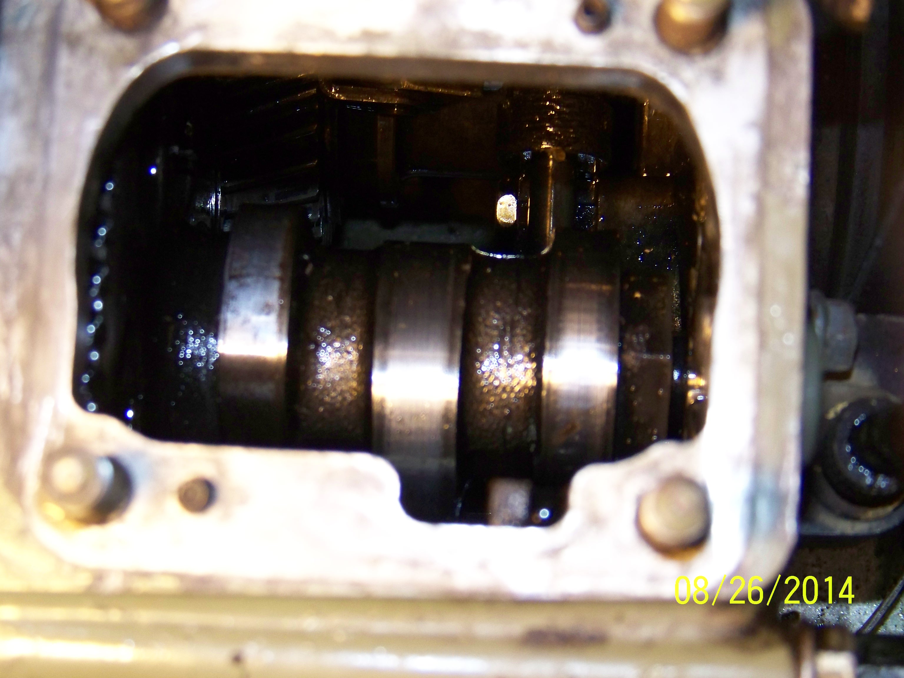

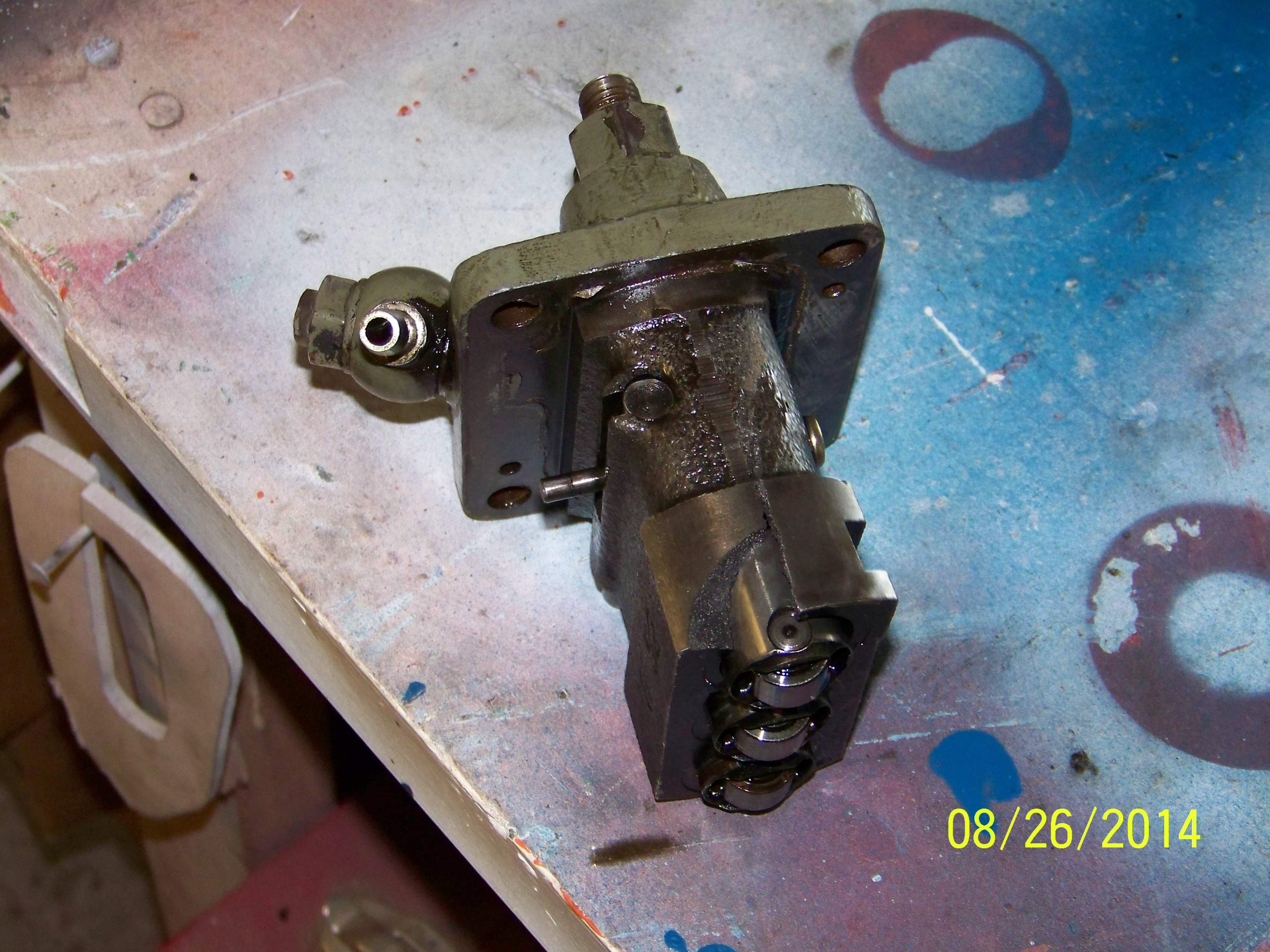

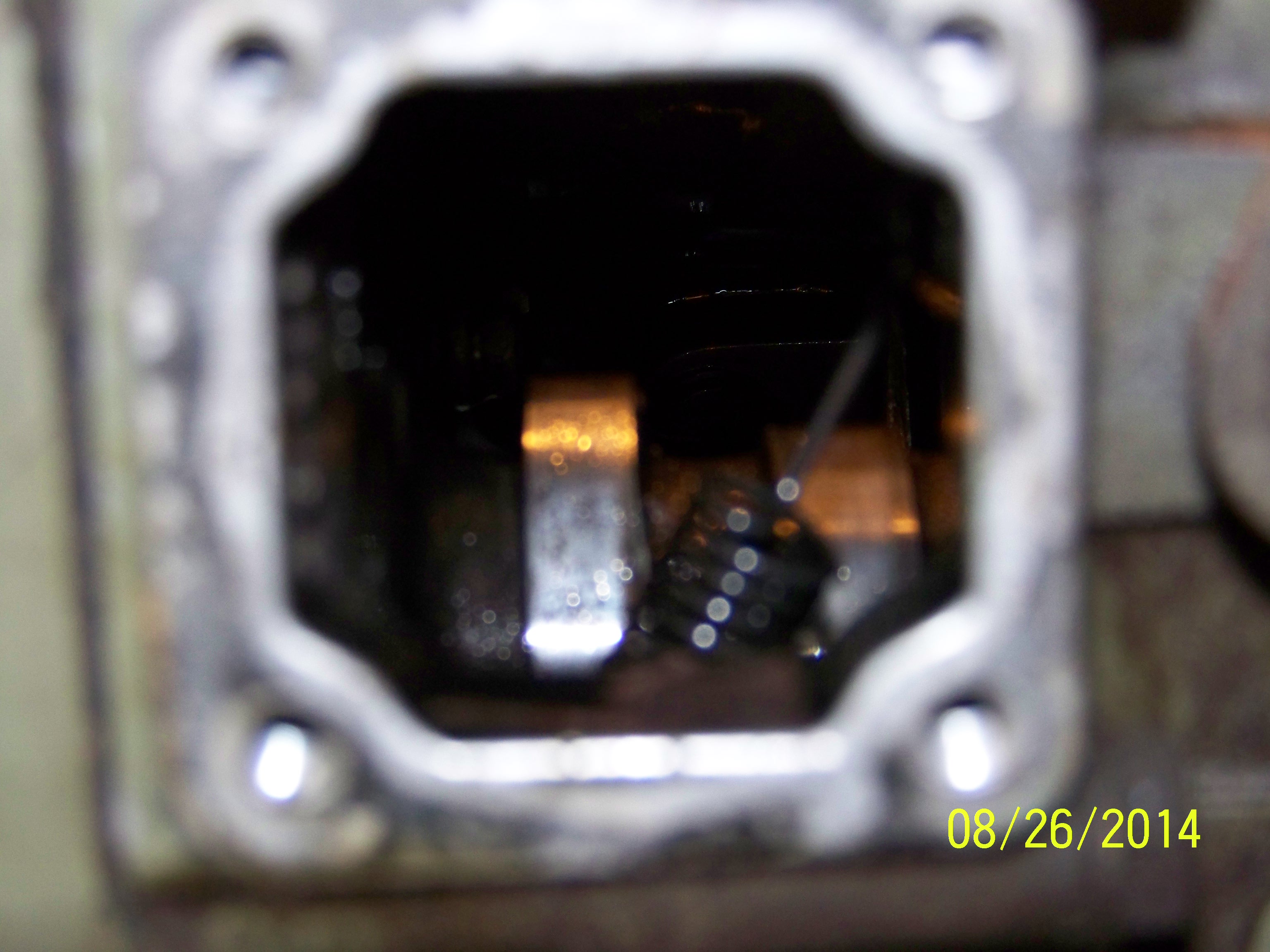

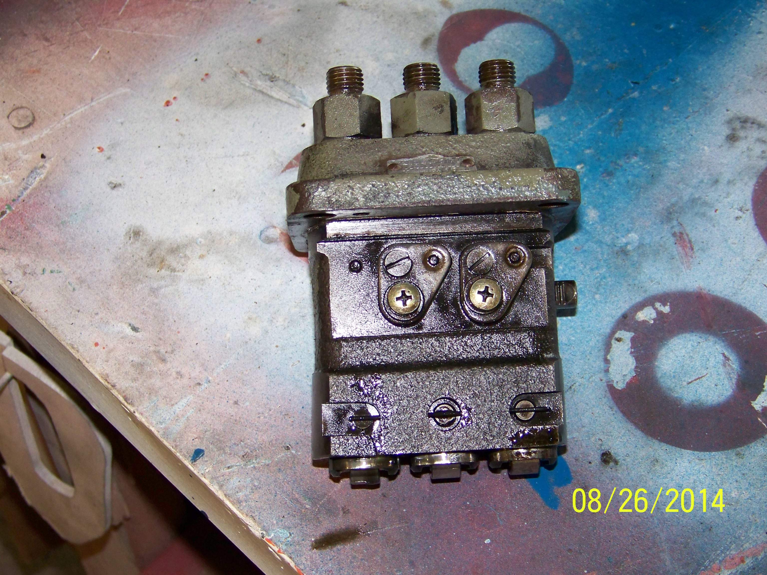

Now the bad news. When I removed my pump to access and remove the shims I found the pump housing broken where the plunger guide is at on #3 cylinder plunger. No doubt it has been broken for a long time. It is scary looking but when I came in and saw the price of a new pump is close to $600 that was even more scary.. All the cam lobes showing some wear but I wouldn't think is unusual for 31 years old and over 3300 hours. In any event I am going to run it and hope it doesn't crater and tear something else up.
Took some pictures of the pump and one shot looking down in the pump opening and one looking through the inspection plate opening. Hope some of you find this interesting. Next to last picture is the scary one.

Think that missing piece is in Pan? I believe I would have to take a Look.
/ 2002D fuel injection pump experiment
I don't know for sure but doubt it because the pan was off the tractor after I purchased it. Old LCI Equipment changed the broken crankshaft. No way for me to be certain but I believe that break has been there since Vietnam. If you do a close up view of the last picture you can actually see the clearance on that guide. Very scary, I guess I am probably not being wise not spending the $600 for a new pump. $600 for an old retiree is not easy.
/ 2002D fuel injection pump experiment #4
That piece has been missing for a long time looking at the break. It appears to have been a poor casting as you can see up further along where the 2 halves meet it doesnt have a good bond/cast between them and appears to be quite porous. Is it my imagination or do the rollers on the plungers look scored and one has a piece out of it?
Pictures may be deceptive, the rollers were pretty smooth. What would you do if it was yours?
/ 2002D fuel injection pump experiment #6
Yup, between the break, worn cam lobes and worn roller, you need a pump: however if mine, to enable an earlier pump, I would remove the studs from the opening and work on the surface of the opening with wet/dry emery paper on a perfactly flat surface, (glass, Plexi, etc.), and take a few .000" off the surface, (like milling a head). If wrong you can always reshim.
After some prayer and thinking it over I have ordered a new injection pump and shims. I just can't stand the thought of that broken housing possibly breaking and causing much more damage. I will feedback when done. :dollarsign:
/ 2002D fuel injection pump experiment #8
That would have been my back-up plan.
/ 2002D fuel injection pump experiment #9
...pan was off the tractor after I purchased it. Old LCI Equipment changed the broken crankshaft.
I'm trying to imagine what stress could chip the corner off the casting like that. Is there a ding indicating a broken rod etc slammed into it? Is that pump even located where a broken crank or rods could hit it?
The broken casting looks like evidence of the VN shop knowingly using a damaged component off a grenaded engine.
No wonder that importer is gone. The VN wholesale operation near here went out of business apparently due to the unpredictable quality of what they were sent. The kids sent over here to run the import house were wonderful about supporting their customers (their retailers) and making an exchange when needed, but I think they had so many warranty returns that it made their business unprofitable.
I think you did the right thing buying another pump.

Any signs of that broken piece yet? If no then you can pretty well guess it was put in like that. I believe you stated LCI had the pan off so they would have seen it or the Fragments!! So my guess is typical VN.er. so Ditto... "Old LCI Equipment changed the broken crankshaft. No way for me to be certain but I believe that break has been there since Vietnam".

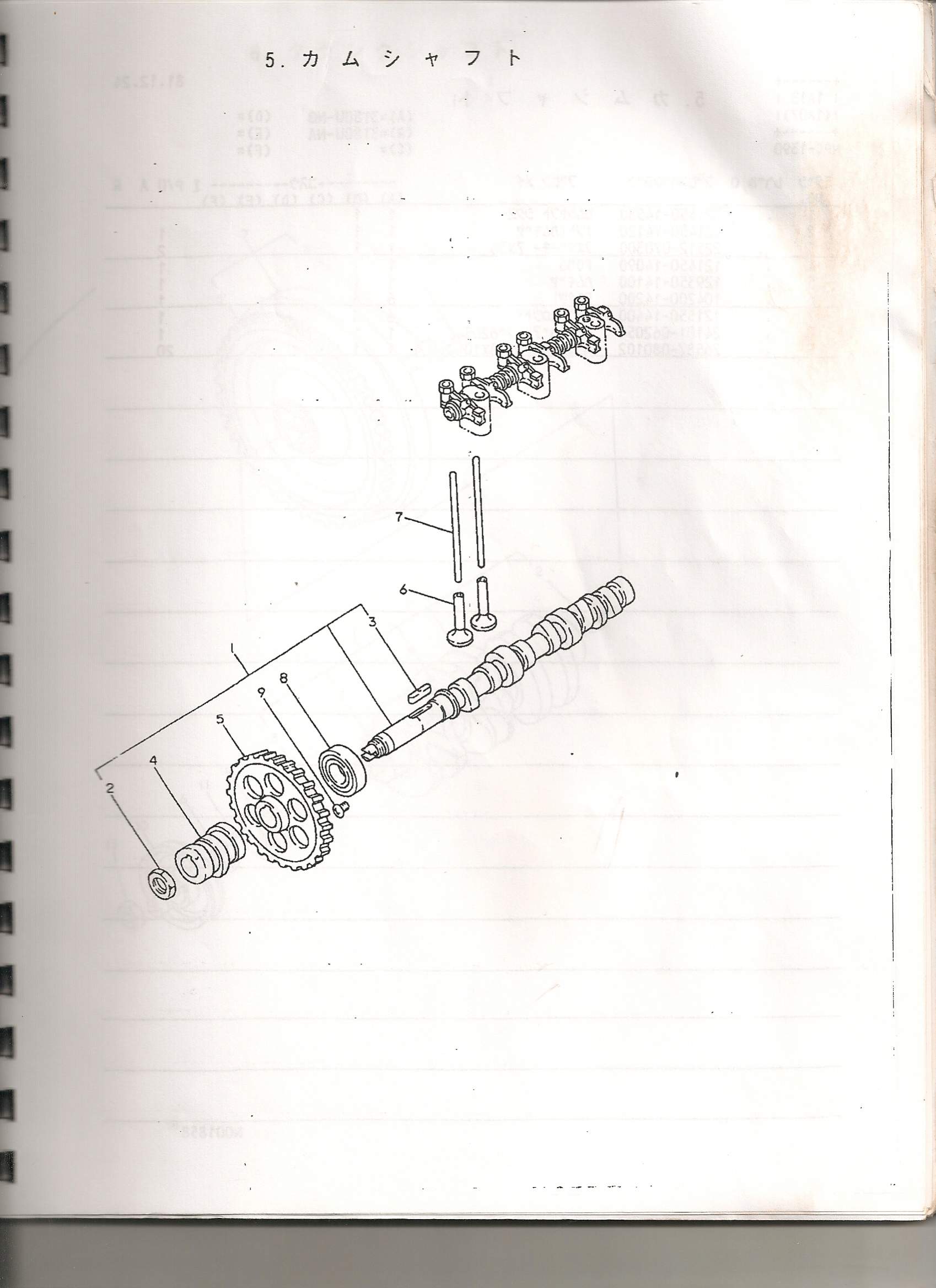

The pump cam that runs the pump on this model is inside the gear cover and separate from rods, etc. #4 on the drawing. Expecting new pump tomorrow so will be tearing into it. I will inspect as much as is possible for missing piece. Maybe try to get a clearer picture of the break on the old pump just to show how scary it looks.

... inside the gear cover and separate from rods, etc. #4 on the drawing.
I wonder how they broke that piece of cast iron.
Maybe Bud (EFC)'s stories weren't a dramatization when he said the VN 'rebuilders' buy their raw material from Japan by standing a container on end and directing the salvage yard to pour tractor fragments in. :eek:
/ 2002D fuel injection pump experiment #13
IMO. Looks as though someone just plain dropped it!! Most men in VN. aren't very tall but the cast wasn't ment to take that kind of abuse.
/ 2002D fuel injection pump experiment #14
I would agree in that thing has been broken since put on your tractor.
I think California hit it. I bet that pump was pulled off a motor with a broken rod or something that hit it...or they dropped it on the concrete shop floor (if they even have those over there) and broke it and said well lets see if it still will crank and run. I think it had been running like that a while.

Received the new pump today and installed. Started with a .012" shim, seemed to be a little late on timing, took the pump back off, removed the shim, put a little rtv sealant and reinstalled. Looks as close to 21 degrees as I can tell. I am telling you, it is difficult to move the crank and see the exact degree that fuel starts moving.
Runs fine in the shop, started raining so it will be tomorrow before I can load it up and see what happens. We need the rain, so sure won't complain.
I did examine the gear case as much as is possible through the openings but could not see or pick up any metal with a magnet. Rolled all 3 cam lobes around and just can't see noticeable wear on any of them. Pushed around on them with a screwdriver and everything seemed tight.

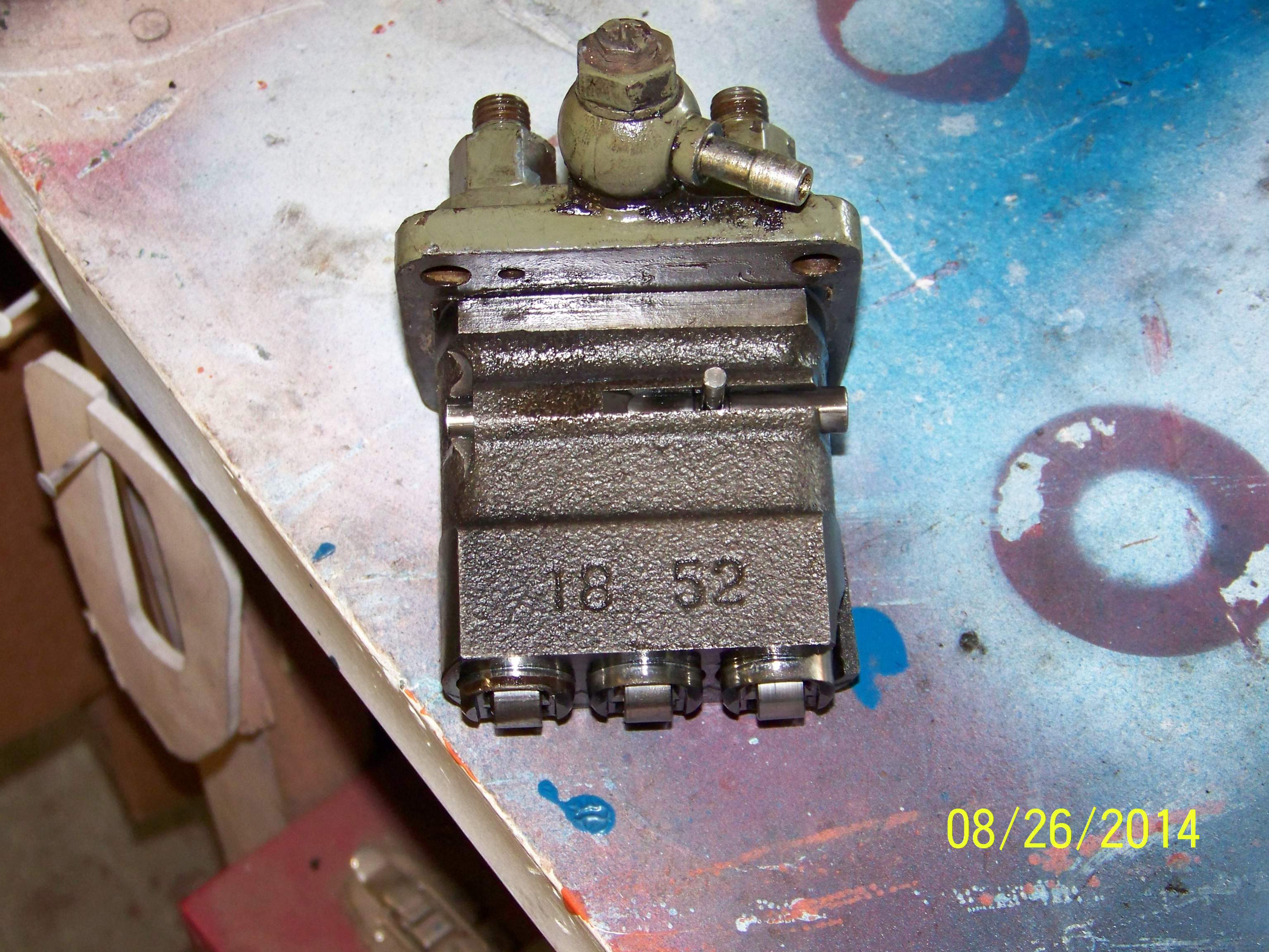

Posting one final picture of the old pump that might show a little better just how bad the break is.
I was just thinking the same thing, they thought it would be fine. Lucky it ran well all this time and never leaked diesel in the sump! :eek: That photo is just plain scary.

Yep, it's a goner, considering those cracks, in addition to the broken piece.

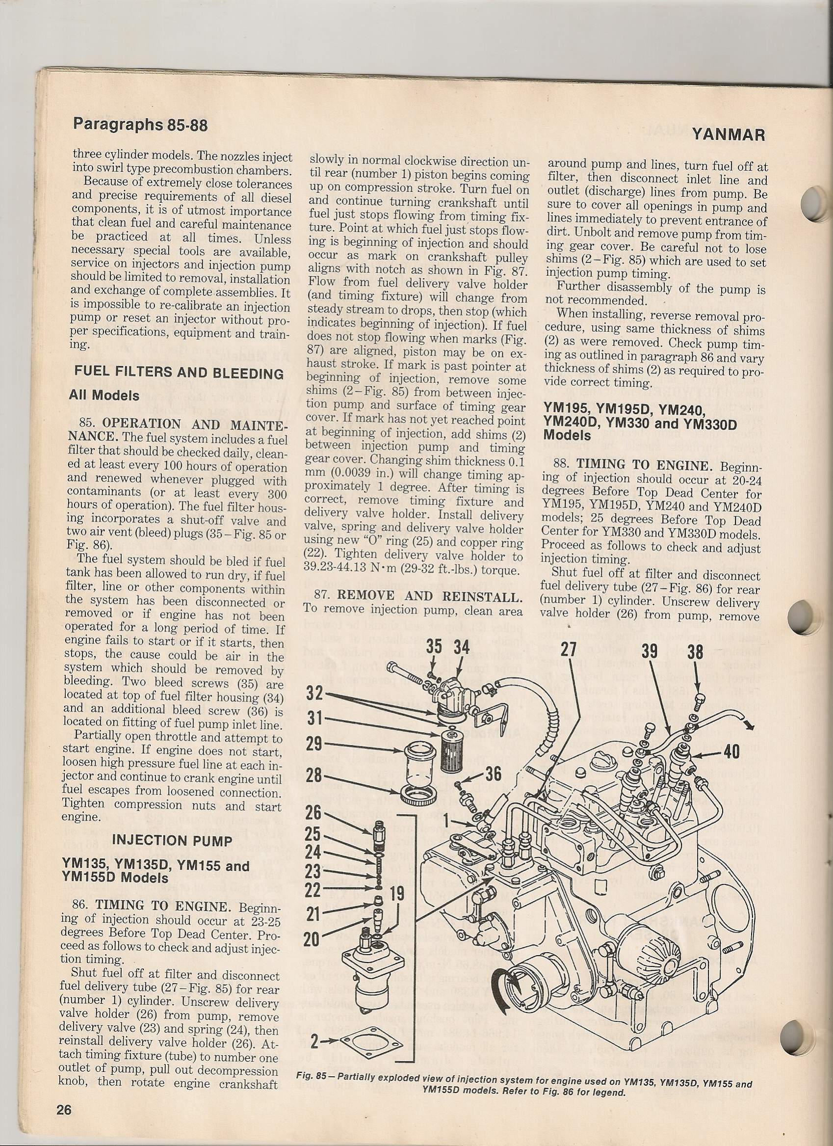

Got about 7/10ths rain yesterday. Took it out and loaded it up this afternoon. Temperature gauge went right up to where it has been running always. Really couldn't tell any difference in running. Maybe no improvement in cooling but I sure will have a better piece of mind knowing my pump shouldn't crater on me.
How about some opinions on the timing procedure. I have both a repair manual for a 276 and one for a 220/226. I believe these to be copies of the original Yanmar manuals. Both manuals give the same procedure which is the one I followed. That is to remove the injector line from #1 cylinder, turn until fuel just starts out. Timing mark is to be lined up at that time.
I just got to looking at an I&T repair manual for the 135,155,195,240, and 330. Procedure is same for all these models per manual. Quite different than the other Yanmar repair manuals. Wondering why two different procedures?? I will post the page and would appreciate others opinions on this. I am supposing end results should be the same?? :confused3:
I looked at my I&T manual and see what you mean. I can't explain that.
Here's a photo of the timing section in my original YM240 Service Manual (page 46). Yanmar's procedure is a lot simpler than what I&T described.
