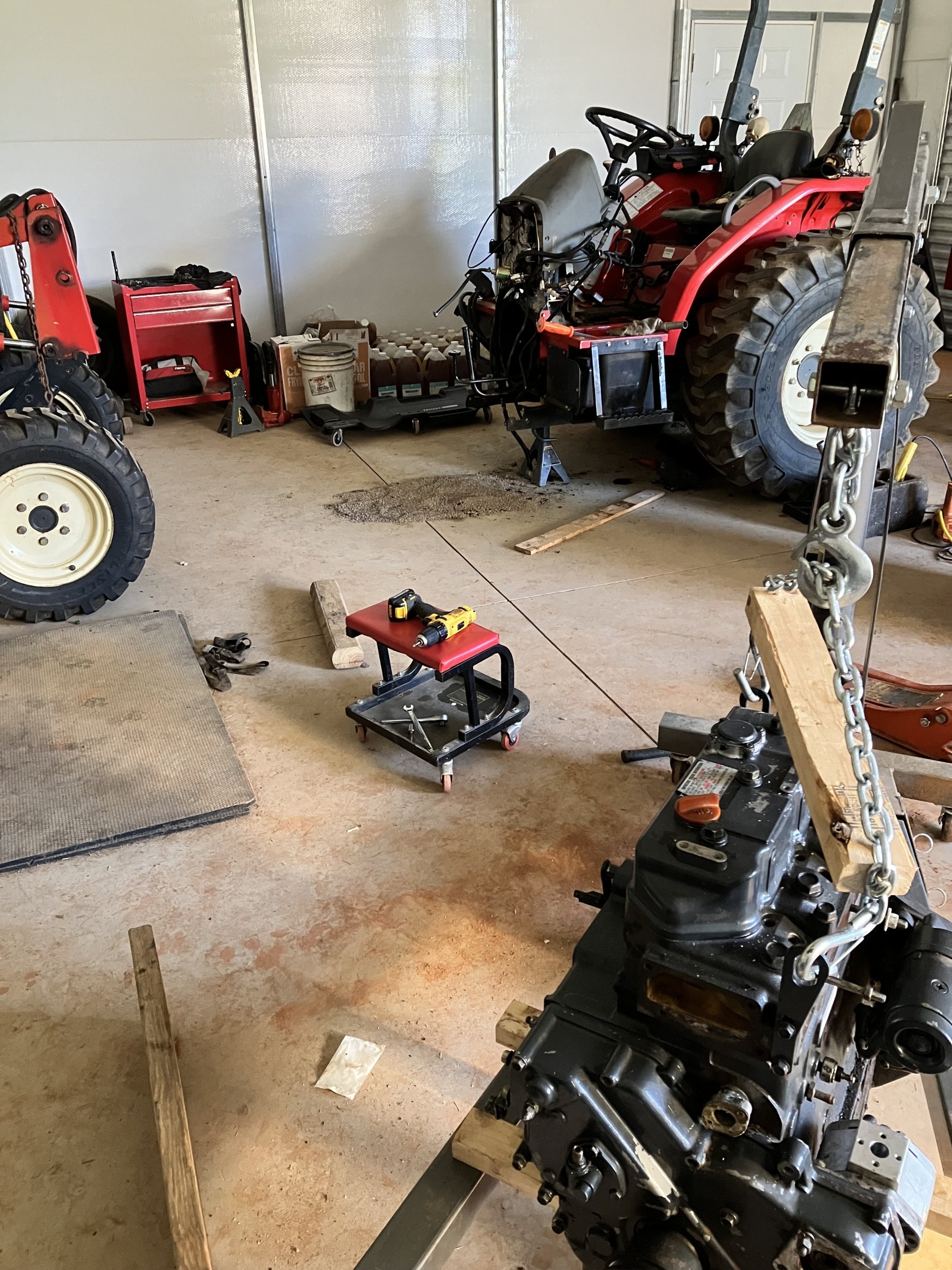

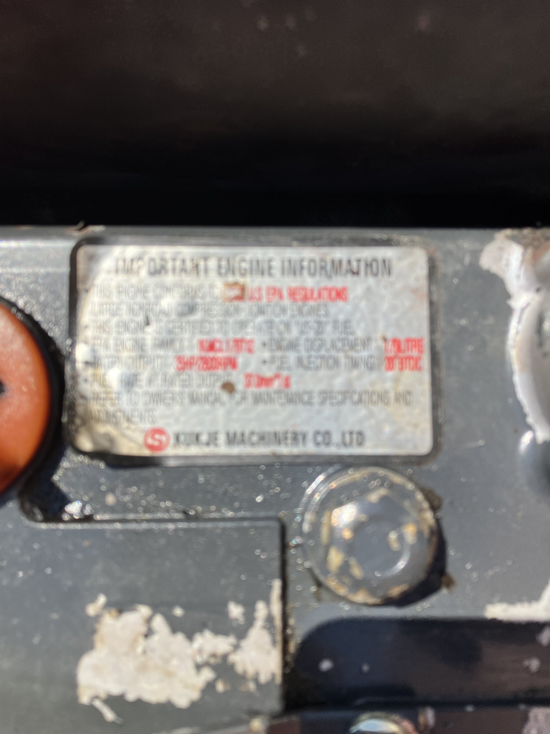

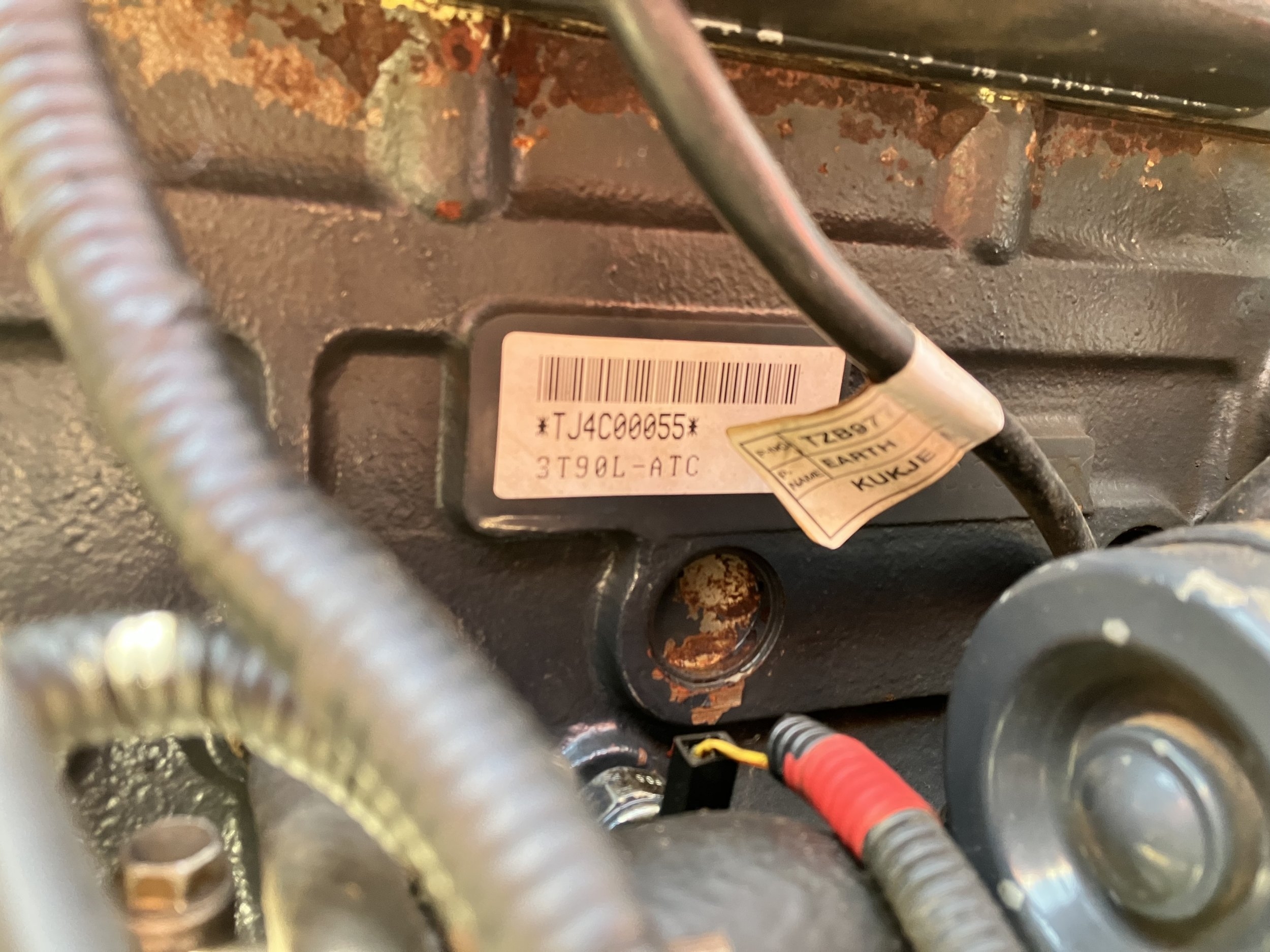

3510 with the Kukje 3T90L engine. I’m looking for a block. A complete used engine would be nice but I can get by with just a block or if there’s another engine that will bolt up and work. I’m in Northwestern South Carolina. An help would be much appreciated. Thank you.

Wow that doesn't look like any kind of fun there. what happened if you don't mind sharing?
   / 2003 Branson 3510 engine Parts
Drive gear for the hydraulic pump stripped out on the the previous owner. After having it replaced he most have not seen the need to clean out the metal pieces. I found gear teeth in the oil pan. Spun rod bearing and gauled the mid shaft cam journal. There isn’t a replaceable bearing in the block so either have to find a place to bore it out and make a bearing or find another block. Perhaps just put it all in a pile, set it on fire, and walk off. :ROFLMAO::ROFLMAO:
