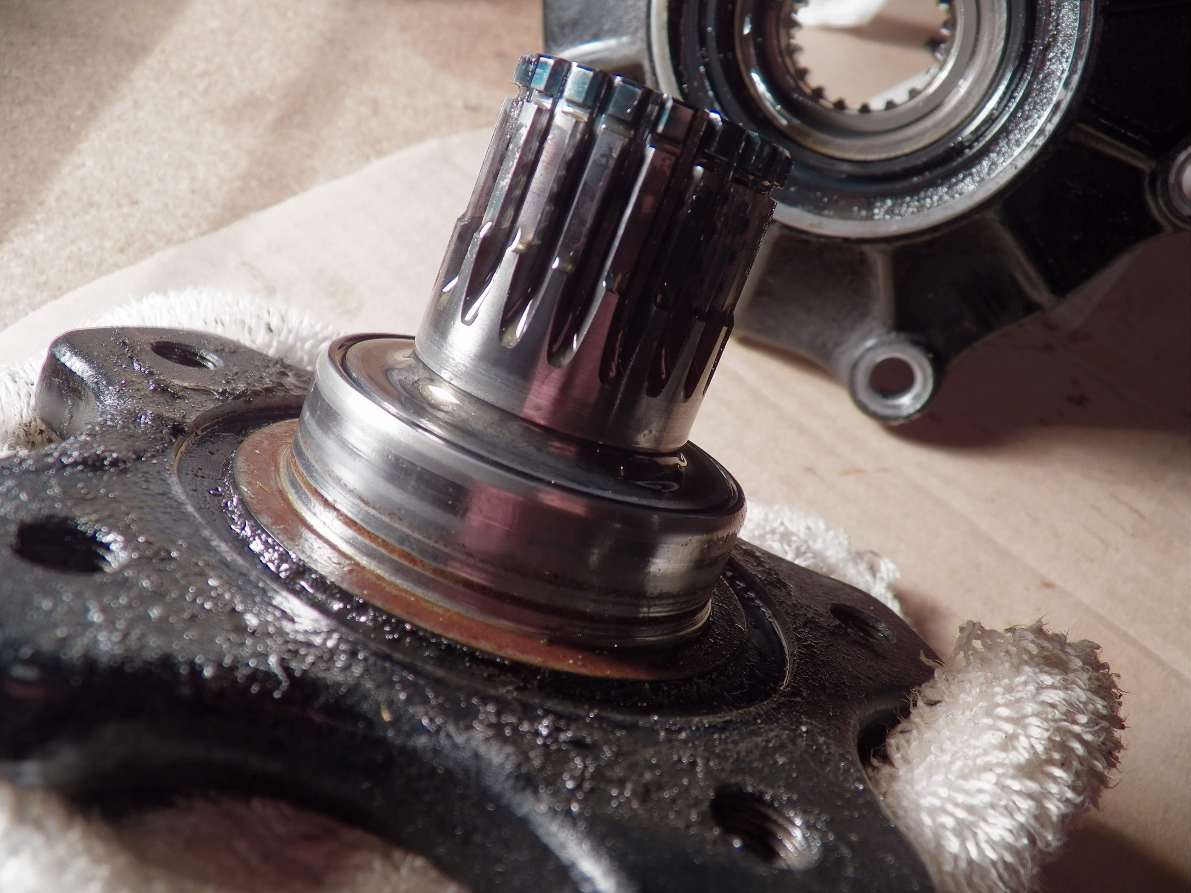

your link didn't work. but the joint you mention is dry on mine, the entire spindle oily. I HOPE I'm right. I popped the final drive cover and and popped the spindle - the seal is not torn or anything but had some dirt in the rubber between the two ridges, the "sleeve" that the seal seats on is deeply grooved and needs replacing.

That's weird about the link. It isn't working for me today either, but it was when I posted it.
Try this one. In this link part # 12 is the seal I'm referring to-
http://jdpc.deere.com/pimages/MP29/MP29822________UN08OCT02.gif
Mine was getting my drop tube and final drive damp (mine wasn't leaking bad like yours).

When I checked it over yesterday I topped off the oil, then spotted the leak. She sat on jacks overnight and slow-dripped from the spindle about a tablespoon worth. All I can say is that seal must be torn somewhere that I can't see. I was surprised by the damage to the sleeve and the dirt in the seal, I assume that dirt may have been there a long time, but not sure why it suddenly started leaking after that last snow storm. Oh well, for your entertainment, here is a pic of the spindle and seal as it sits on my bench....
Funny how this started at the other end. Just glad the old girl held on until temp got above zero and the snow stopped, with an unheated uninsulated garage it's hard to keep up with these things.

Be glad it's that one and not the upper one. The upper requires disassembly of the lower and upper joints and seals. Hopefully you can get it all sorted to your liking, and will have it fresh in mind should the other side start to leak.

As for the front axle seal it is fixed. Funny, there was no sign of water in the front axle, just dirt in the seal.
