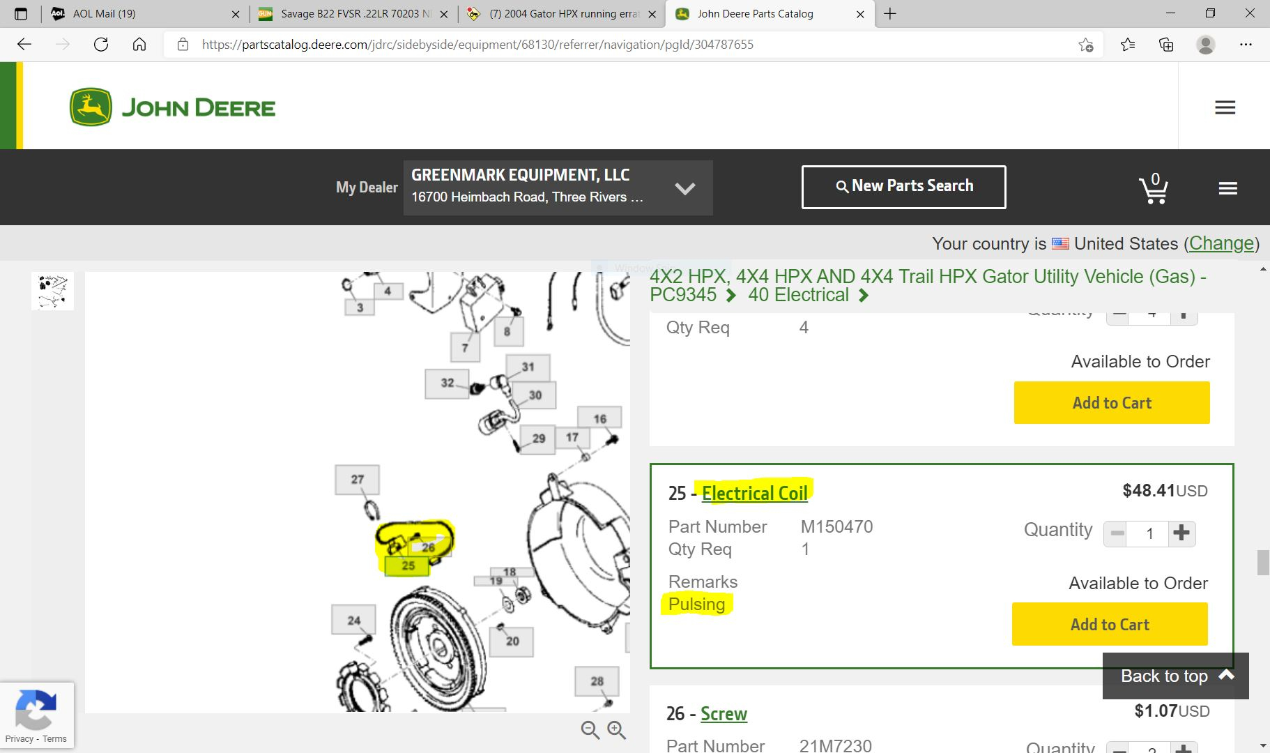

Have you replaced the pulsor coil?
I do not know what spark plug caps should OHM. You might want to try new ones? HPX gator.JPG

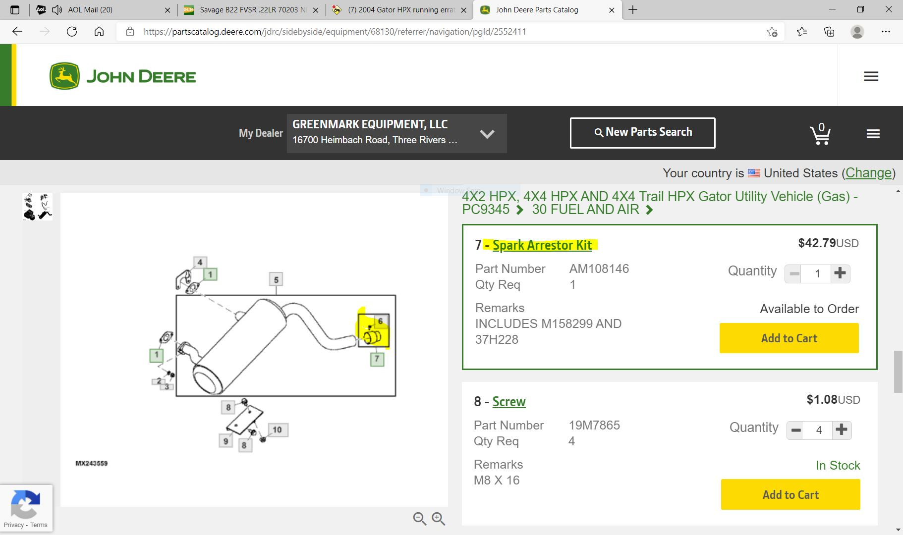

Does it have a spark arrestor on the muffler? I think it was an option. If so, see if it's carboned up/clogged.

I've had the exhaust off. Yes it has the spark arrestor, and I took it off to check the exhaust for being plugged up. It is clear. Unit only has maybe 500 hours +/- on it.
