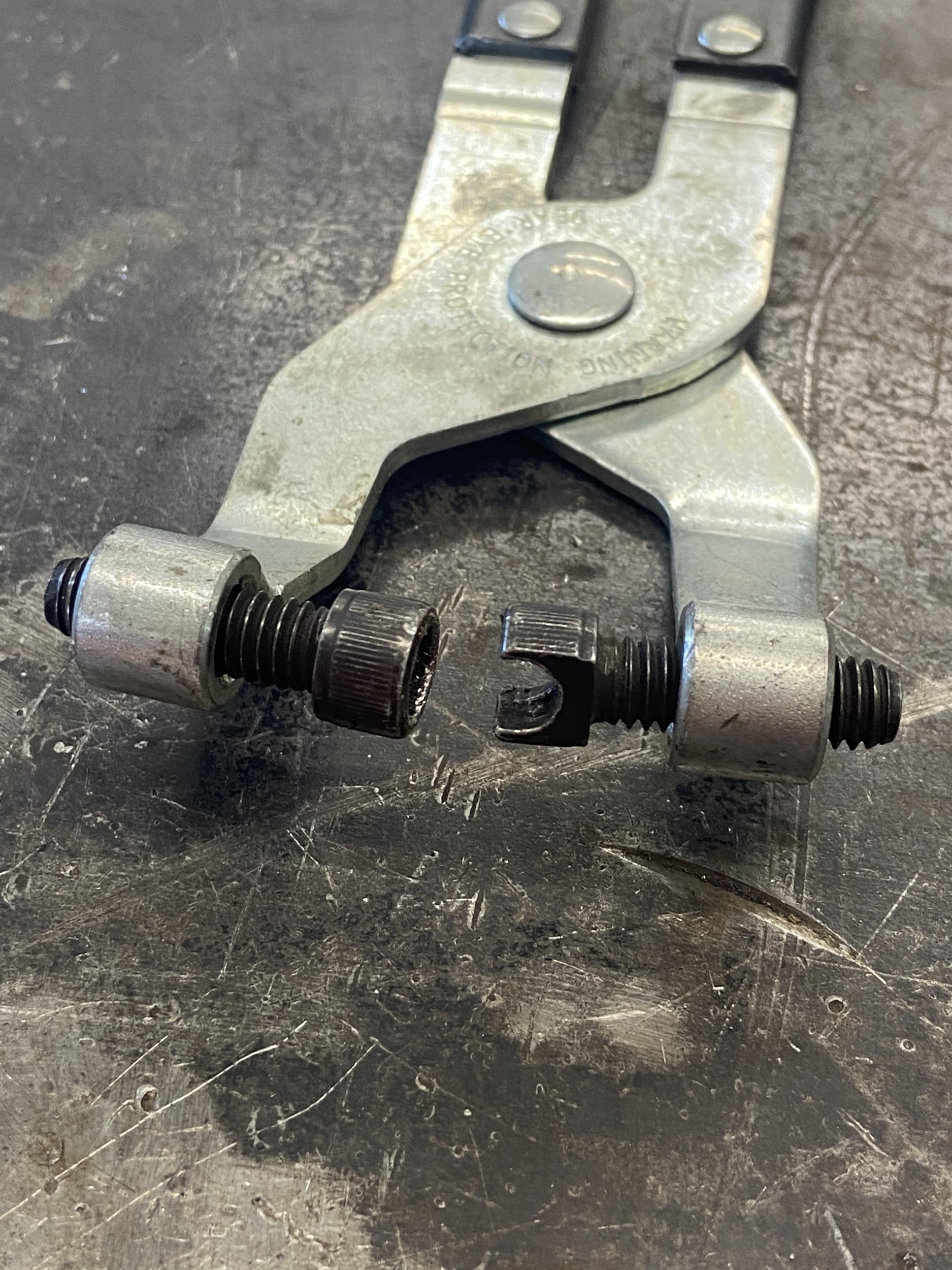

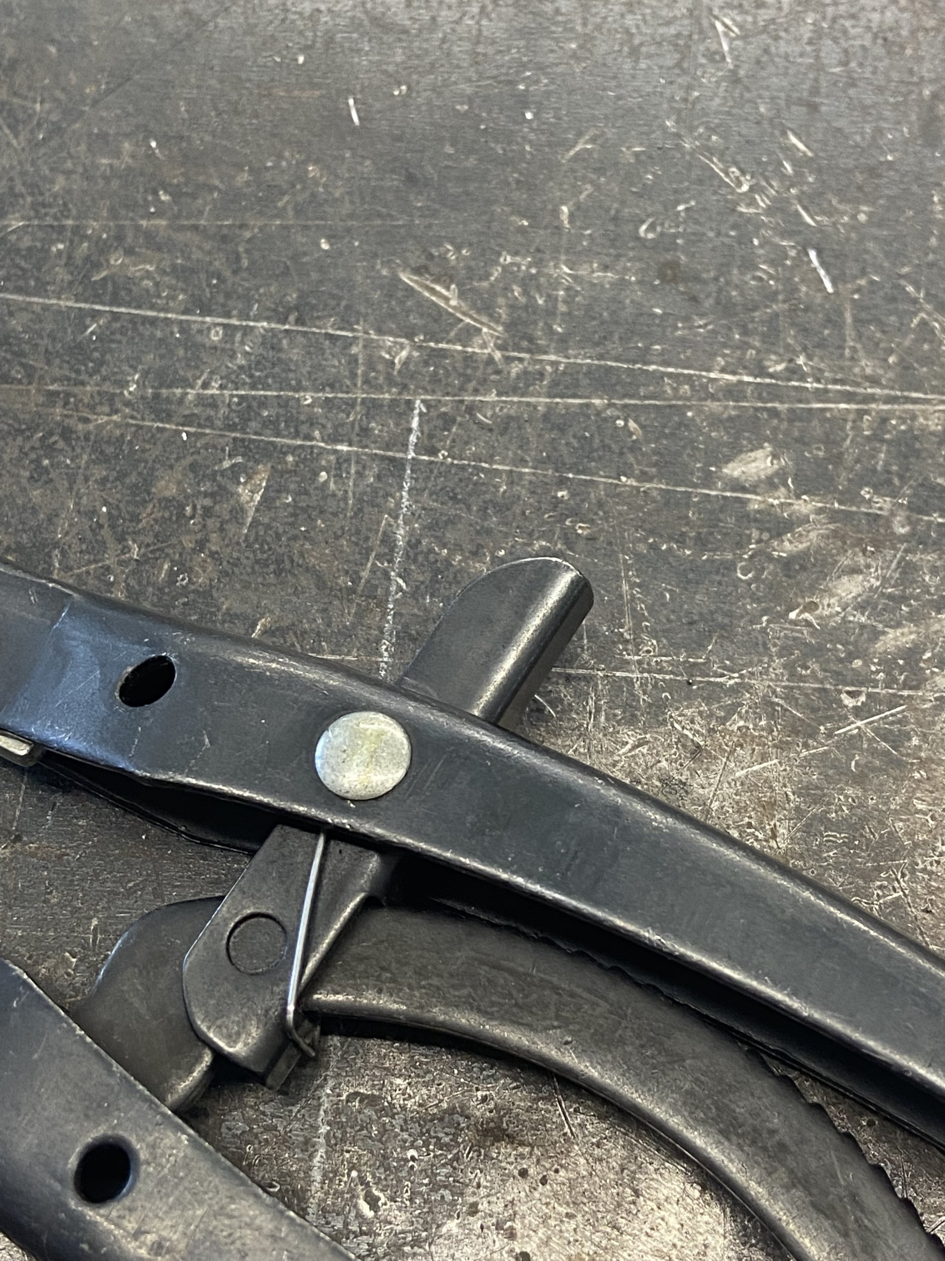

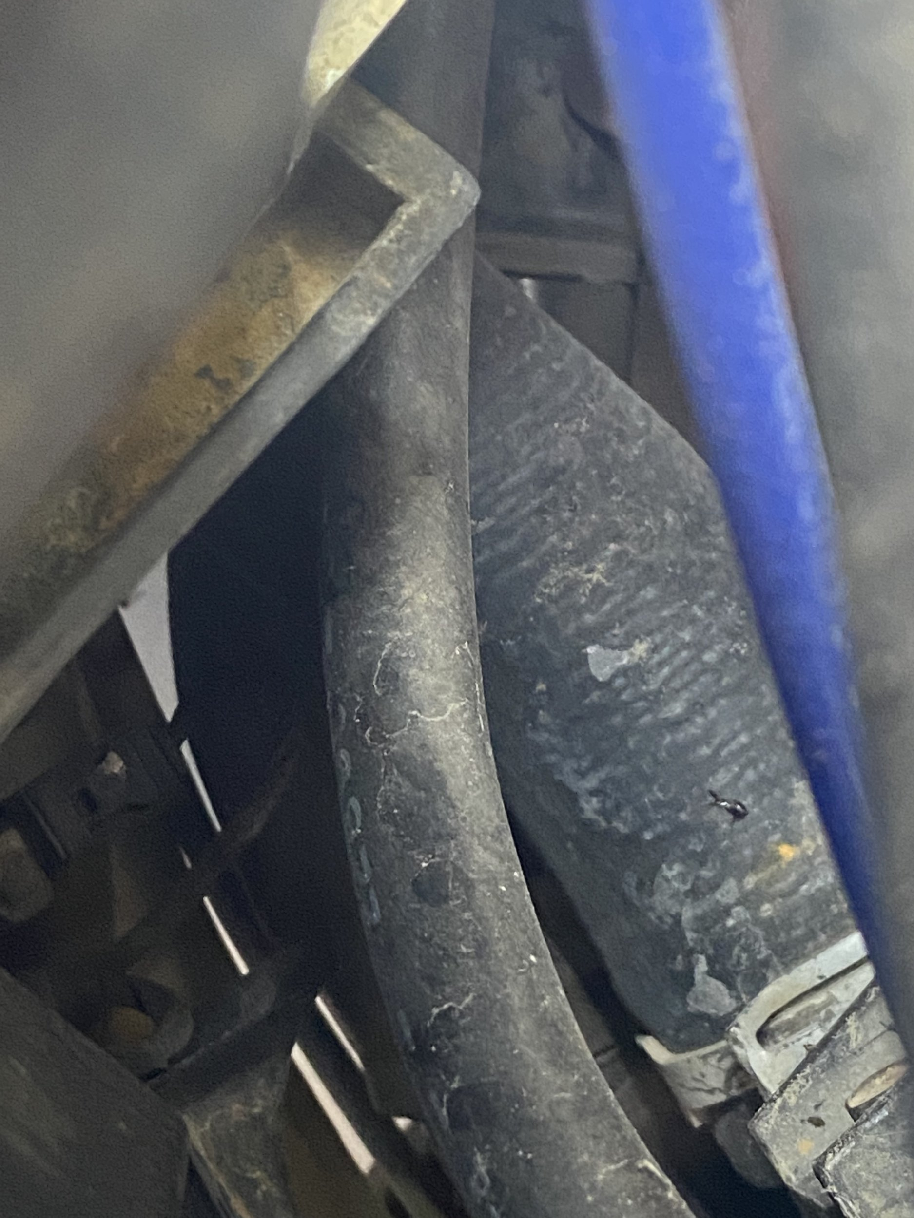

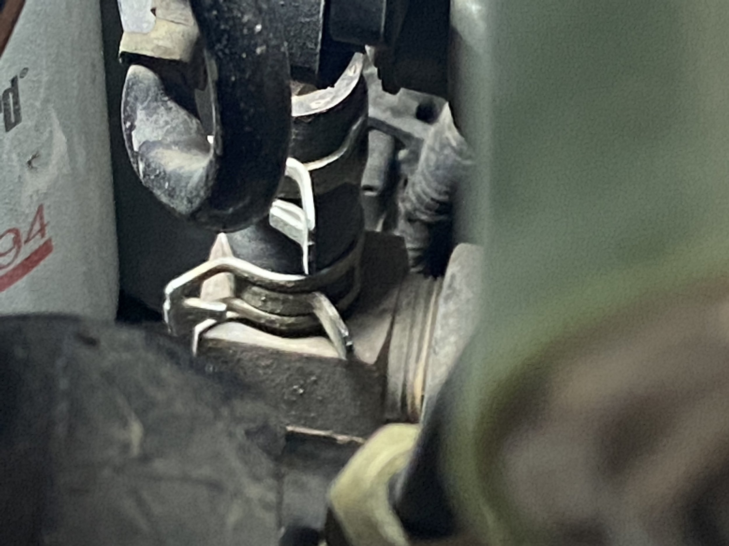

It’s kind of hard to get good pictures, but these clamps were difficult to access. The pliers are offset and reversible so you can get the side you need in the right place and also has a little ratcheting mechanism to help hold the clamp open. Sometimes, it’s still a tussle, but I have been happy with these hose pliers

For anybody replacing hoses on a 2004 Mazda B3000 like mine, I got those pliars today. The clearances in this truck are so tight that the pliars just didn't work for me on this vehicle.
A small vice grip and a medium vice grip worked.
I'm not sure if the manufacturer designed these hoses so that you'd replace them after taking the fan and fan shroud out to replace the water pump?
I reused the spring hose clamps...now I'm wondering if I should have installed new ones? I haven't replaced the coolant yet.
