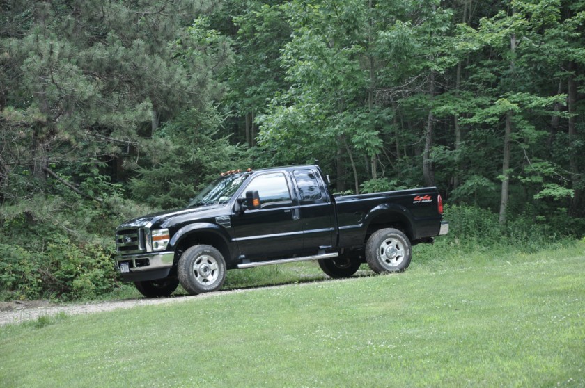

I have a 2009 f350 v-10 w/ 4:10's and in the city, in the winter hubs unlocked 15% ethanol I get 8.5 to 10 depending how many red lights I get stuck at. On the highway unloaded in the winter I got as high as 15.2 going 65-70. I start mashing the gas and those figures drop rapidly. I love my v-10. I had a 2005 f250 5.4 before and to me when towing 8K and above it won't get out of its own way. The best MPG I got out of that brute was high 12's on the highway at 65 MPH. This ethanol crap really does a number on MPG in the freezing weather..My new 350 w. camper pkg, and plow pkg actually rides smoother than my 2005 F250.
   / 2005-07 vs 2008+ F350? #20
Nice truck.
