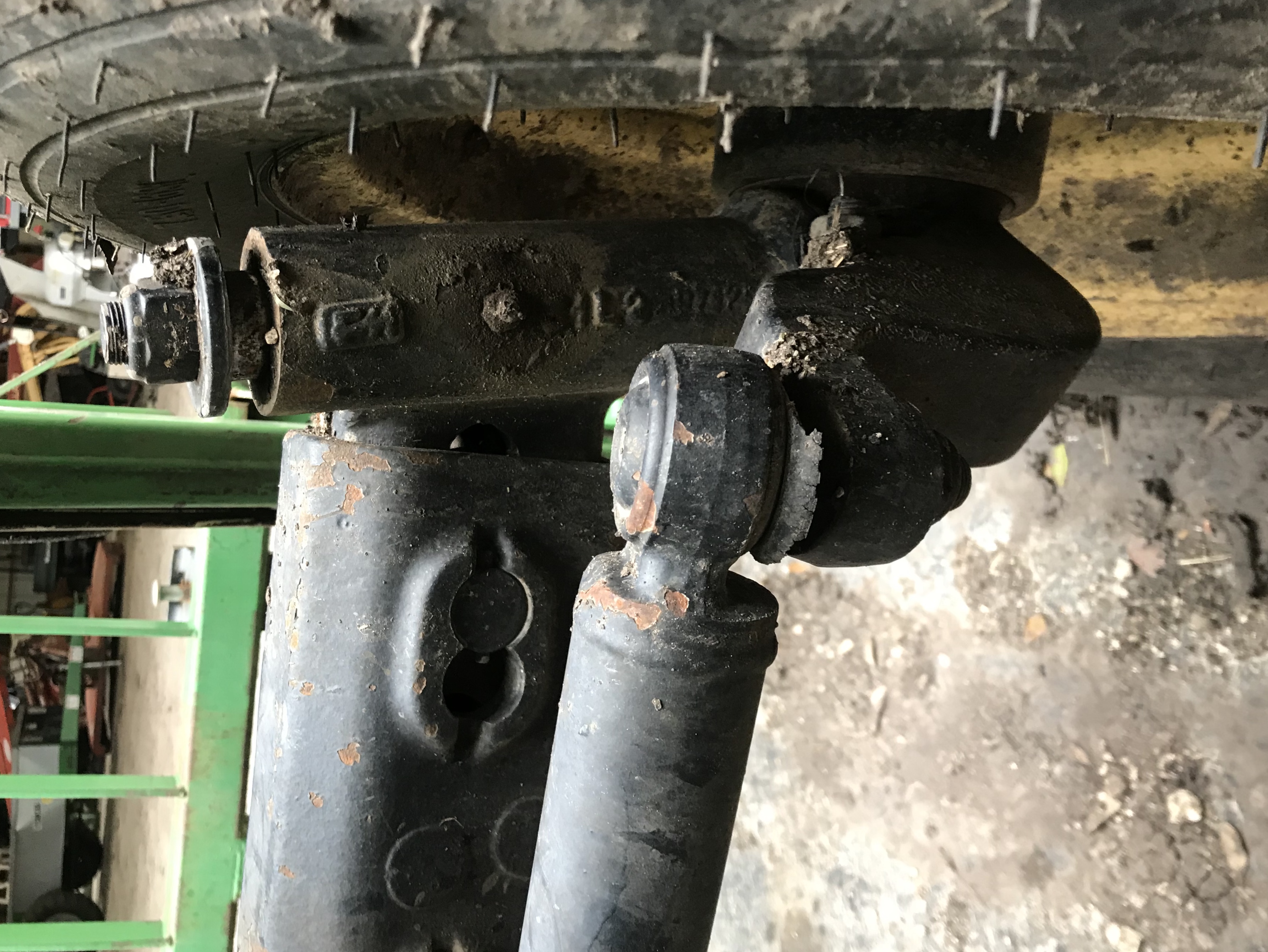

Sincere Thank you for the link, exactly what I needed.
So is the seal, bearing, or bearing damaged and therefore the knuckle is pushed up through the axle knee?

I cannot figure out how to get that picture upright

Take it apart and see what is amiss or missing. Best way to find out..
Prolly the pic is 90 deg off because of using an iPhone and holding the phone vertical, instead of horizontal. It's a bug, thanks to Apple.
   / 2005 JD 5103 #14
My guess is the bearing key 14 in the drawing beenthere posted has failed. I would ALSO replace the seal key 13 and check both bushings key 15, since you will have it apart.
Also check the other side, since it might be close to failing too. This is the kind of repair I do both sides if one side failed.

Thank you. That痴 what値l I do. I値l Go ahead and order the parts

Thrustbearing failed !
When setting up these tractors at its widest that axle tend to brake at the wheelbearings ! Do not repair it . Just replace it !
