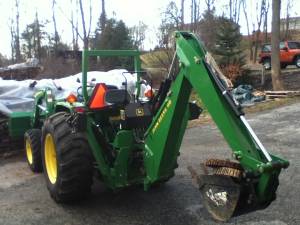

Well I tried out the backhoe today and had a big surprise. I was pulling a good size rock out of the lawn and the whole bh pulled away from the tractor!:confused:
I of course immediately stopped and got off of the bh and looked and sure enough it was pulled right away from the tractor and I am scratching my head. Low and behold the locking pins on the front of the frame were not locked in. Someone had unlocked them and thus using the bh it slipped right out of the frame of the tractor. So I had my first lesson to always check those pins and my first lesson in installing the bh back onto the tractor. I knew that some people had complained that this was a real pain to do. Of course the fact that I had never done it caused me to get the manual and look it over. However I must say it is not a difficult thing to do once you understand what has to be done. I shut off the tractor, disconnected the hoses and then pulled away from the bh so that I could properly align the tractor. Then I backed up as straight as possible. Tried to align the back catches and then started to learn how you use the stabalisers and the hoe boom to properly position it. Once I got the hang of it I saw how easy it is to install the bh. You really need to learn how to pivot it properly in order to get the front of the frame to attach properly. Once I got it set up I could finish backing into it and then pivot it to lock it in. Then of course locked the front pins properly and then I was able to use the bh once again.:)
The other thing I saw was that the bh did not really have a lot of power to it. The first thought in my mind was what is the level of the hydraulic fluid and sure enough it is really not even touching the dip stick. So later this week the cutting endge for the bucket will arrive at the dealer and I will pick up the hydraulic fluid and since it has never been changed in 6 years and the maintenance says that it should have been changed at 50 hours I will drain it, put on a new filter, clean the screen and then fill it up with the specified 5.5 gallons. The stuff aint cheep. They said it is $110 for the 5.5 gallon bucket. This stuff is called John Deere Low Viscosity HY-GARD (JDM J20D) but it says you can use an equivalent. Is the JD stuff a must or can one purchase another standard hydraulic/transmission fluid?
Also I am assuming that of course this old fluid will be in all the hydraulic cylinders throughout the system. Should I make sure that all the cylinders are fully retracted so that I can get as much of the fluid out as possible?

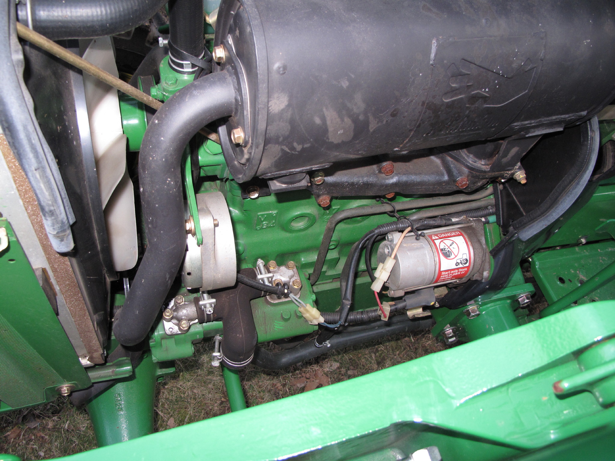

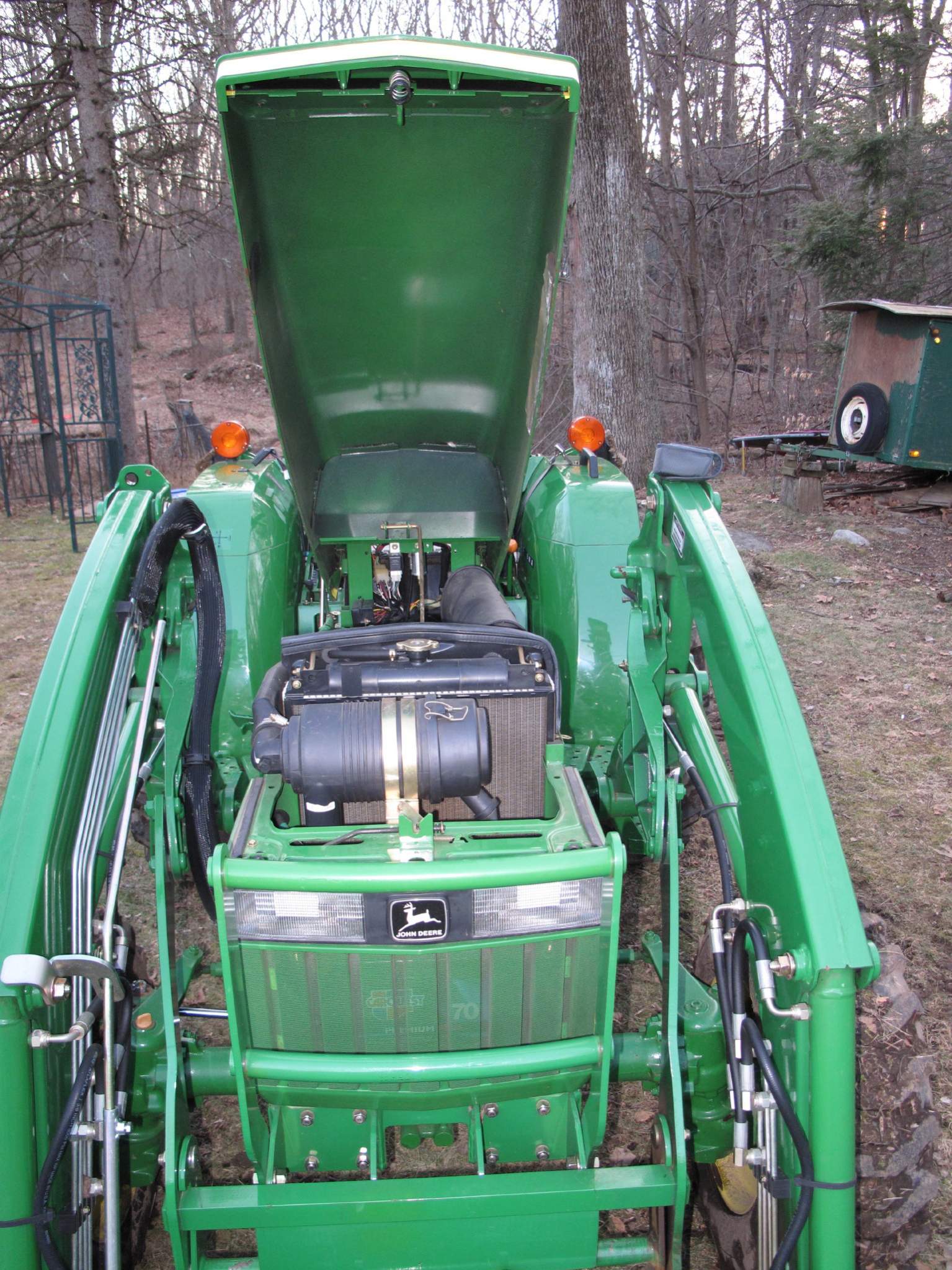

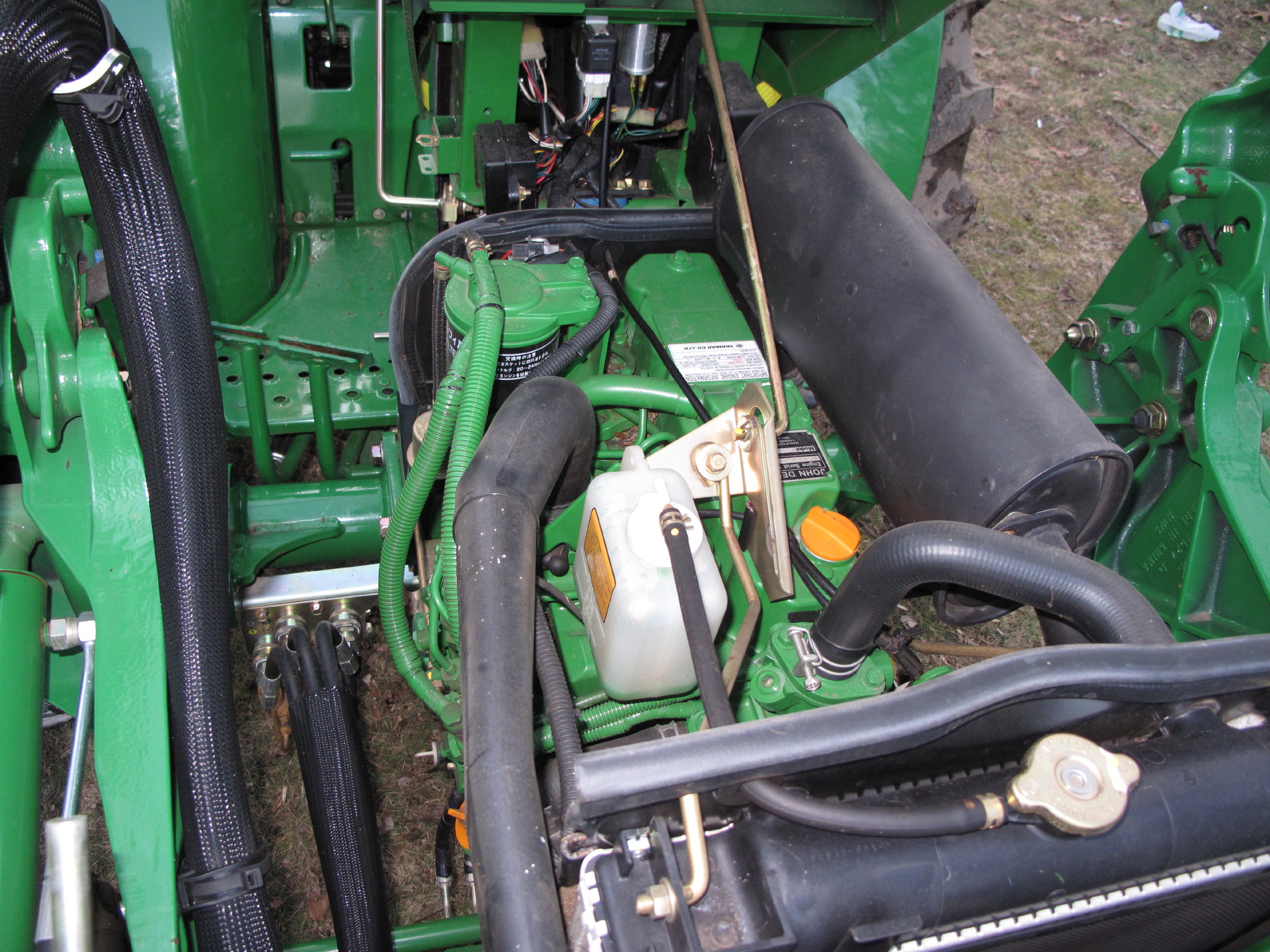

By the way here are a couple of shots of the engine. This thing is just like new:) My daughter got to drive it today as well. See the picture.
