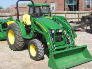

:ashamed::ashamed: I bought a 2008 John Deere 4105 , 278 Hrs , 300cx quick attatch loader and quick attach bucket , HST . Looks almost new !!

PICTURES???????????????????????
   / 2005 Kubota FEL and BH FAIR DEAL ?
#49
   / 2005 Kubota FEL and BH FAIR DEAL ? #50
Very NICE:thumbsup:
Congradulations.
