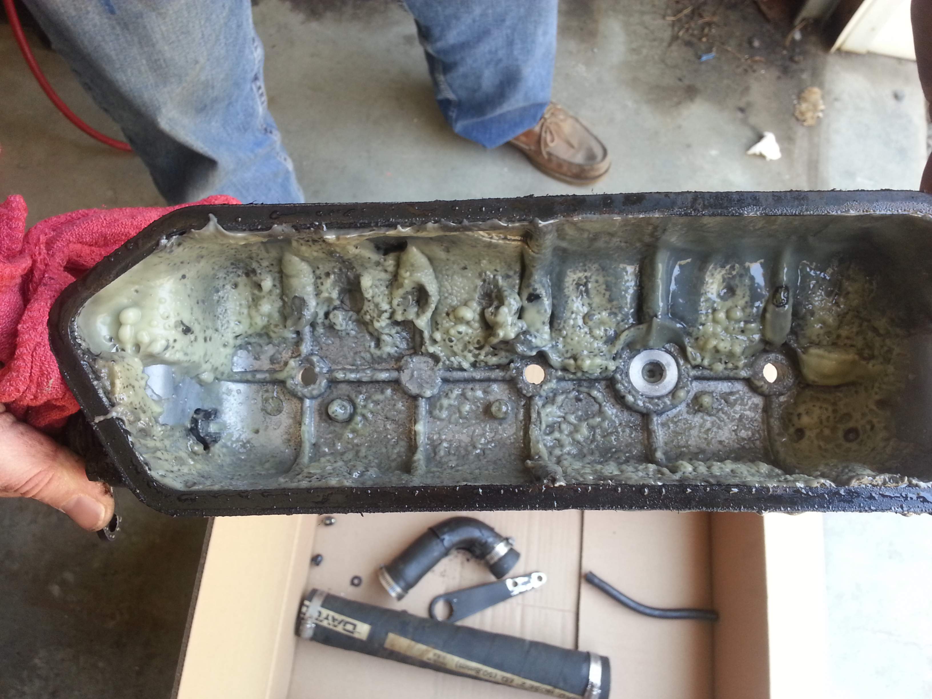

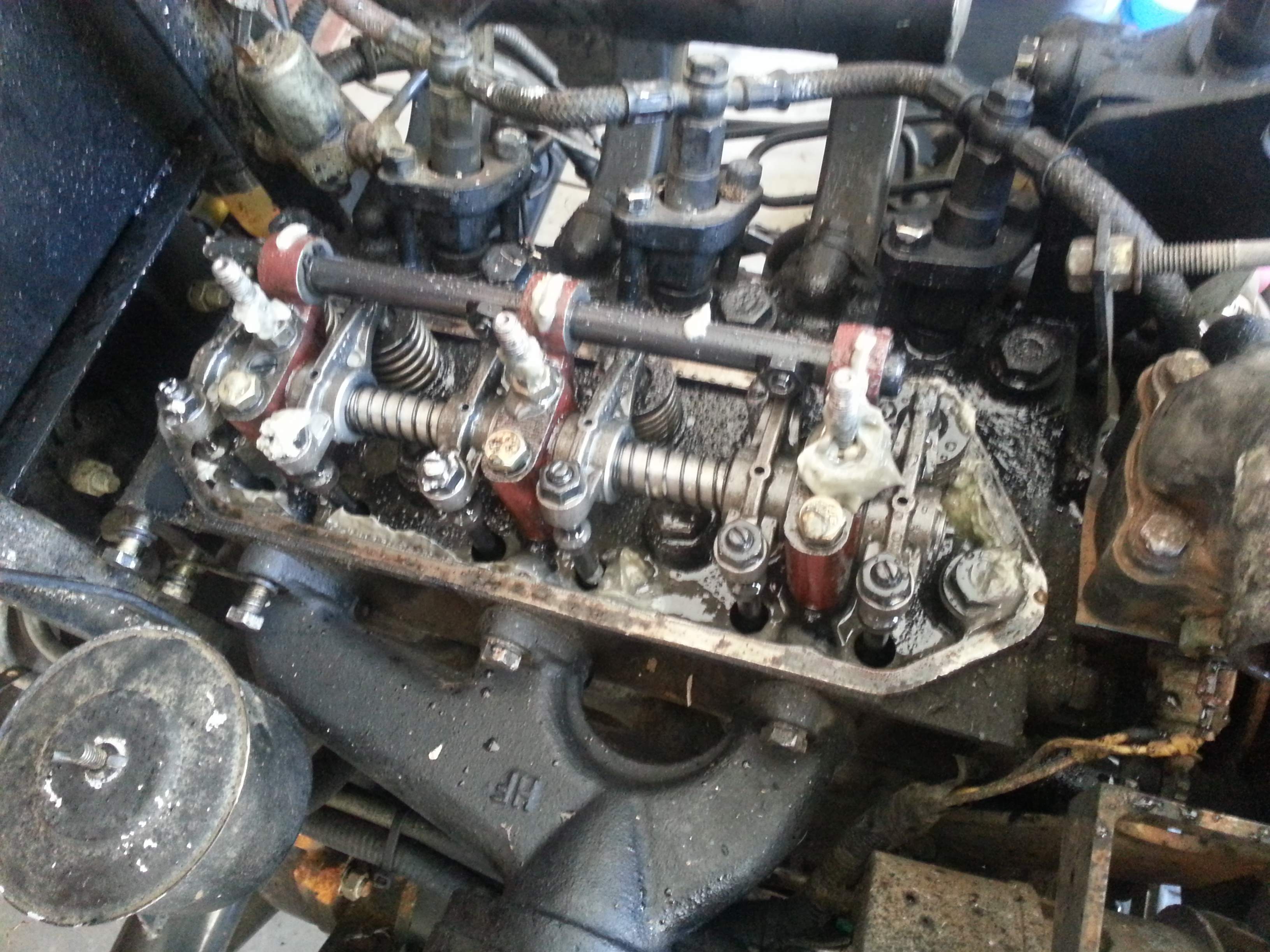

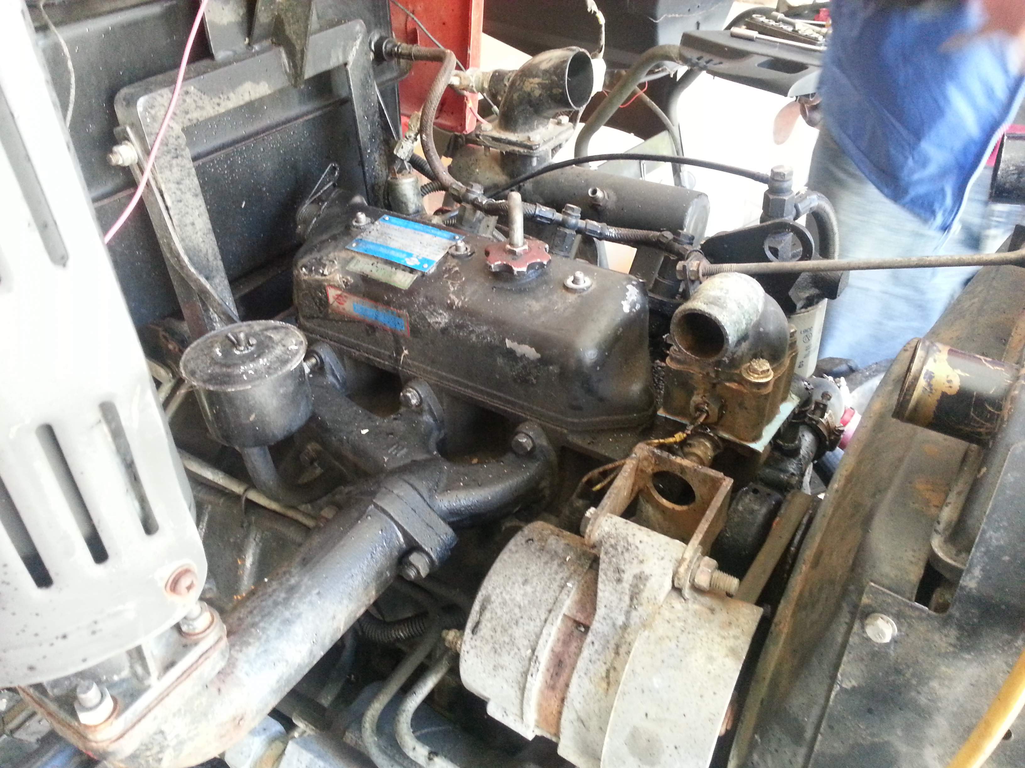

Started to pull the head yesterday, tractor.jpgvalves.jpgcover.jpg was surprised to find a "pudding like" goop covering everything.

No surprise there, that's oil and coolant mixed together and cooked. You're going to need to drain the oil and the coolant from the block and radiator and clean them out before you run the engine again. You can start by pulling the drain bung in the oil sump and flushing lots of diesel fuel through there until it runs clean. That isn't going to get all the oil galleys clean though, so you'll have to do the same thing again after the engine is reassembled and pump it through by cranking the engine a long time with the compression release pulled or the glow plugs or injectors removed. I'd add a bit of alcohol to the diesel to help absorb the water. It may take a few of those flushes to get all the crud out of the oil galleys but it is well worth doing. Take the radiator to a shop to have it boiled out.

The gasket had no visible sign of blow-by. I'm going to have a local shop test the head for warping or cracking, couldn't see any by eye.
That emulsion is common to coolant leaking into the lube oil system or poor crankcase ventilation. Check to see that your evacuation system isn't plugged. If you find there isn't any problem with the cylinder head then you may have failed cylinder liner O-ring seals, or worse yet, a cracked liner.
