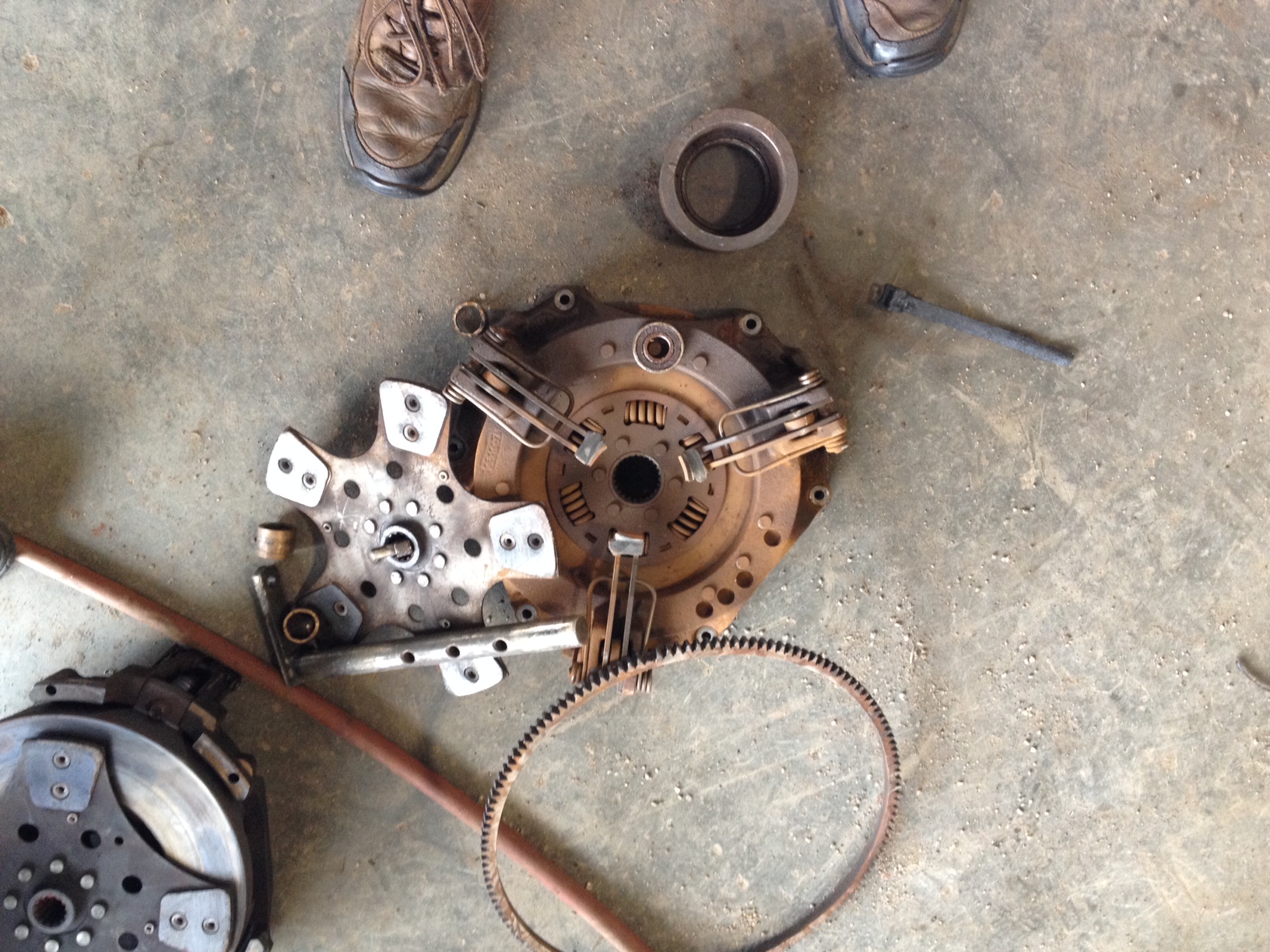

Here are my parts. Water or moisture or excessive heat had definitely washed all the grease out of my throw out bearing and you could feel the rough dry balls in the bearing it was toast. You can see where it was skidding on the pressure plate fingers and wore excessively. I think this was for 2 reasons. One because the throw out bearing was shot.....
At one point my tractor did not disengage the PTO very well. I had to crawl underneath and push the lever to fully disengage it. If you look at the linkage that runs through the housing its shiny where they may have tried to salvage it with maybe emory cloth and or wire wheel. It was probably rusted and looked like it was pitted and had crap all in the bushings. They ended up replacing bronze bushings and linkage. At one point when my PTO did not want to disengage with cab lever I worked the lever back and forth from underneath the tractor. Working the lever back and forth it started to disengage with the lever in the cab but I noticed cruddy fluid run out of the housing from where this shaft goes through. One of my thoughts is rust and crud from water keep the lever from moving freely. And either does not allow the throw out bearing from completely moving off the fingers and it just rubs and skids all the time very lightly and especially once the grease runs out it was skidding more than rotating. OR once the PTO linkage is allowed to get a bit loose and not enough pressure is there to keep the throw out bearing on the fingers hard enough to make the race stick to the fingers and it skids instead of bearing rotating internal. Either way its another area to increase wear that should last a long time.
The clutch disc was also excessively worn for the hours IMO and I wonder if it slips too much. I really dislike JD's instructions to rev to rated PTO speed before engaging the PTO. I don't do that cause it probably just slips the crap out of the disc for too much.
The Pressure plate was rusted but not seized rusted. I can see where tractors that don't get used for some time the fingers could definitely rust to point of seizure from a moisture issue. Could it also build up rust but not seize however not move freely and allow some extra rubbing on the clutch disc I think so depending on what you have hooked to PTO. I personally leave my mower attached for counterweight a lot and would give some resistance for PTO shaft not to spin and the disc to rub from not disengaging completely. The bottom of disc sitting in crap water would also cause long term issues with more slippage on engagement as its lubed with water or it might swell and want to rub??? Or just build up crud and rub until it burns off each time you operate it after it has sat for a long while????
All of this just accelerates wear at least a little more than it should.
Anyway you look at it IMO moisture definitely accelerated wear on the PTO clutch mechanisms and probably usually doesn't get caught in the warranty period. I feel its a time bomb that goes off afterwards and is an expensive repair that happens way too soon. I would expect the PTO to last several thousands of hours without repair or maintenance needed.
