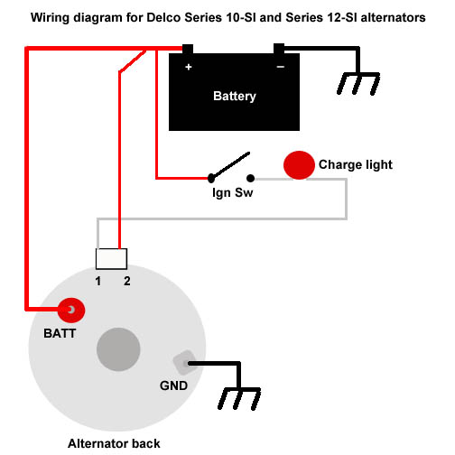

Hello,
I have a 05 Foton ft404, previous owner lost keys, and ran with out gauges. I was hoping key was only issue, but doesn't look like it. As I found major issues with Chinese Tractors is the electronics, and the external voltage regulator, I want to swap out the alternator I picked up a 80 GM 2 WIRE alternator.
Any further information and guidance would be greatly appreciated. I used a power wheel battery to supply power to the instrument panel, all seemed ok. Trying to figure out how to hook up panel to power with upgraded alternator.
Thanks again for any help
Greatly appreciated
   / 2008 Foton 254 Generator to Alernator Swap #17
Might be better to start a new thread instead of resurecting a 3 year old one...
Few hints thoug. Panel wiring should really be uneffected. That should be guided by the original wiring diagram and should be uneffected by a new alternator installation.
As for the alternator, I would suggest looking at some system/vehicle diagrams that use that alternator to see where the new alternator typiclly returns power to the system. In the end tough, the foton schematic should show one alternator output where it puts power back into the wiring. What can be confusing is that the external regulator probably uses a sense wire where it measures the voltage it is regulating to. This wont be used with the new alternator and can be removed when you pull out the old reg. At any rate the new alternator needs to connect to that old power input point
   / 2008 Foton 254 Generator to Alernator Swap #18
