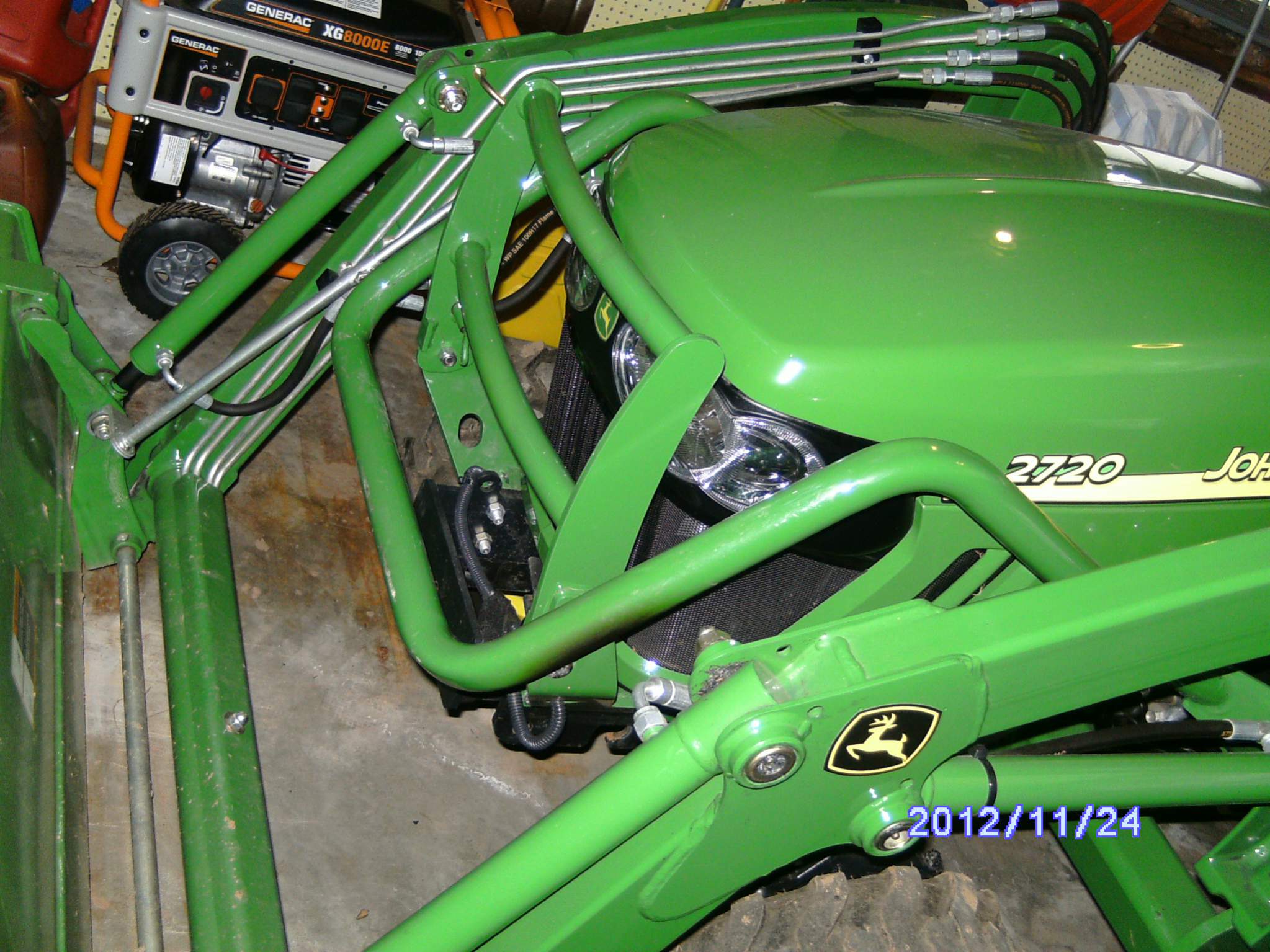

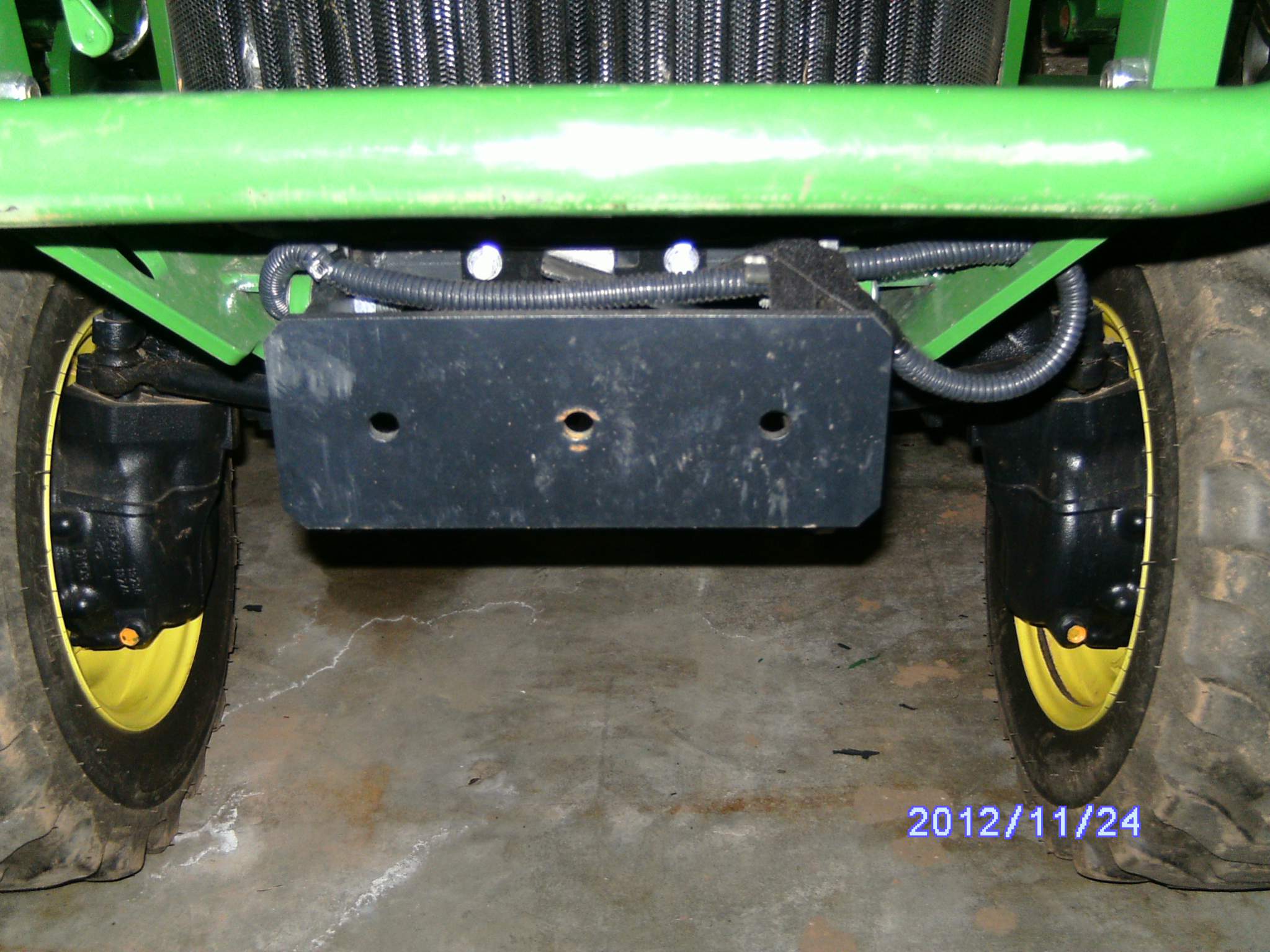

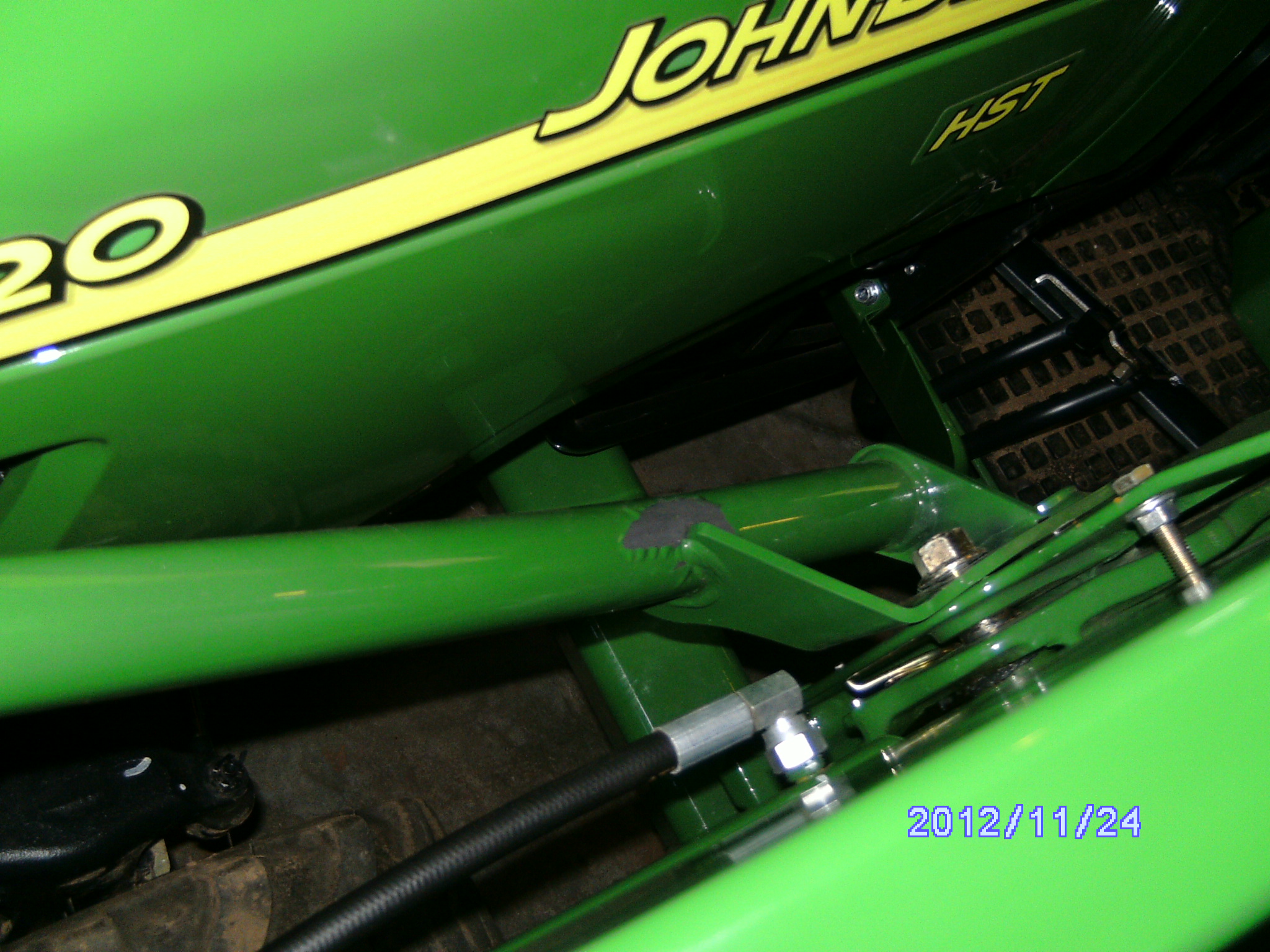

Here are a few pics pf the bent Parking stand.
As you can see it the bottom sits way to high and I can't even hing down the grill guard.
When trying to take the FEL off the stand bent instead of lifting the weight of the FEL frame.
Once I get this thing straight again (not sure how at this point) and the FEl off the tractor, I plan to take the stand off and weld a 1/4" plate x 3" plate making a TEE on the bottom of the tube.
It will be really tough to bend that.

   / 200cx loader parking stand #13
I don't know much about the 200cx, but someone mentioned the way the parking stand slides on the ground during the removal process. The parking stand on my 70A loader does the same thing. When removing the loader, I put the tractor in neutral so instead of dragging the parking stand across the ground, the tractor just rolls instead.
   / 200cx loader parking stand #14
I tried to put my 200cx loader on while still having the mount for the front pto in place. As others have stated this does not work!
However, I used a chain from the stand to the bucket and slowly curled till the stand would clear. I now leave the front 3pt hookup in place all the time since I use it for my broom attachment every few weeks and it makes changeover quicker.

I bought my 2720 in September this year. Our parking stands are different. Mine has a pair of feet that slides on the floor.

   / 200cx loader parking stand #19
Intersting to see you new 2012 model vs my 2011 model.
Why the change?
The feet will certainly slide easier then the tube.
The 300CX CX has similiar feet but uses a flat bar instead of a tube.
Spending the $95 for the dealer to come out here just documents the issue.
Depending on what JD decides will detrmine if I have to pay for a new stand.

Your last picture that shows the paint missing is where I have seen these stands bend my old 200 cx included. The trick has been mentioned and that is to let the loader push the tractor so the stand doesn't slide. Not sure what the feet that were pictured would actually do.
