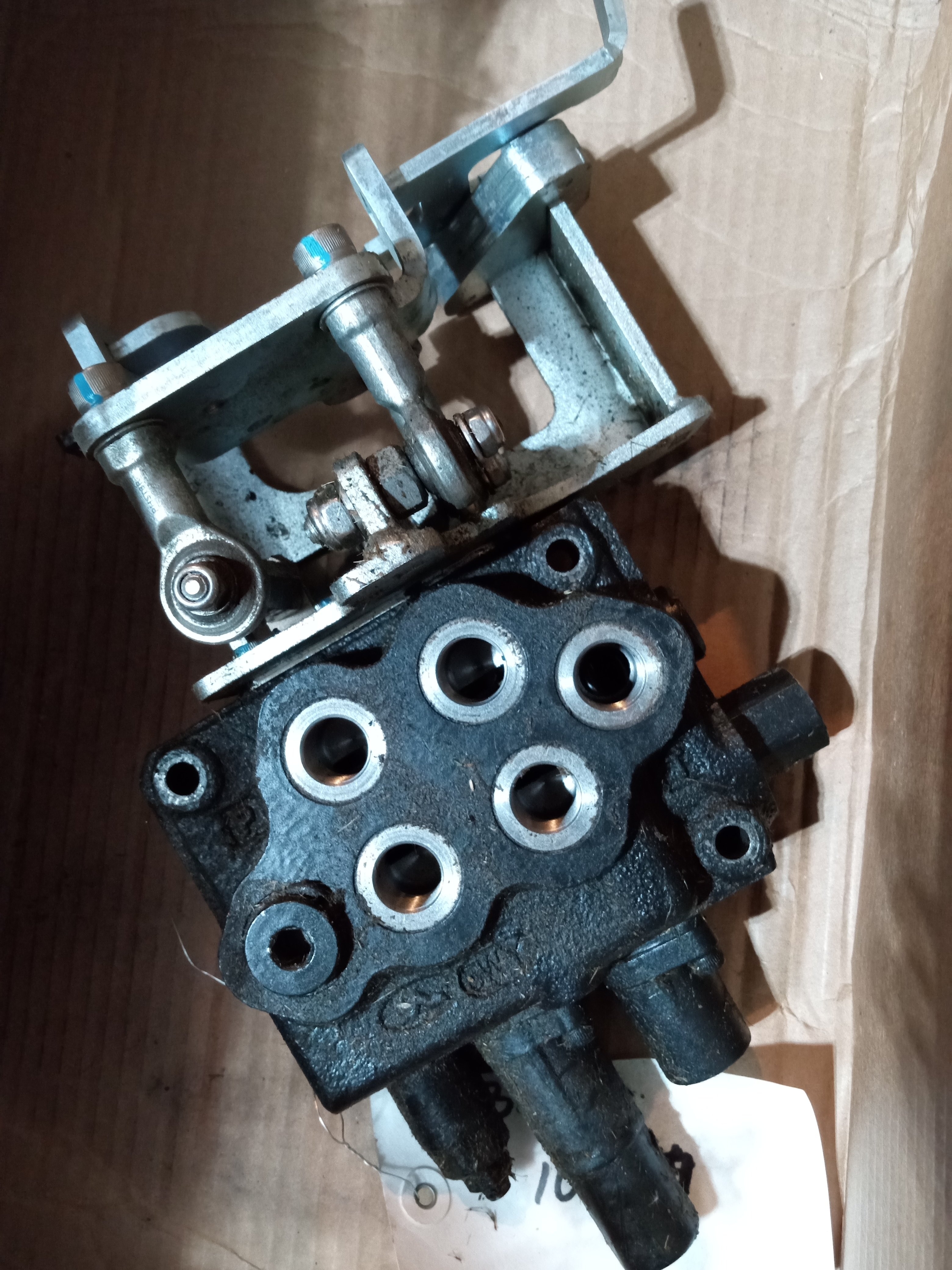

On the loader valve oil leaks. If it's a common problem with these units, I have to ask. How many lines do these valves have? Six or seven? Spool valve seals are indeed a common problem on valves with only six lines.
Here's the old one from my tractor:
/ LS MT225S problems - is this normal? #10
I see four work ports, and one probable return port. Assuming the pressure in line is on the left side (out of sight) and the protrusion on the right side may be a power beyond sleeve with another port (also out of sight) ? If that's the case, that would be a total of seven ports. Yes/no? If so, the plumbing is probably not the source of the problem, more likely the quality of the valve.

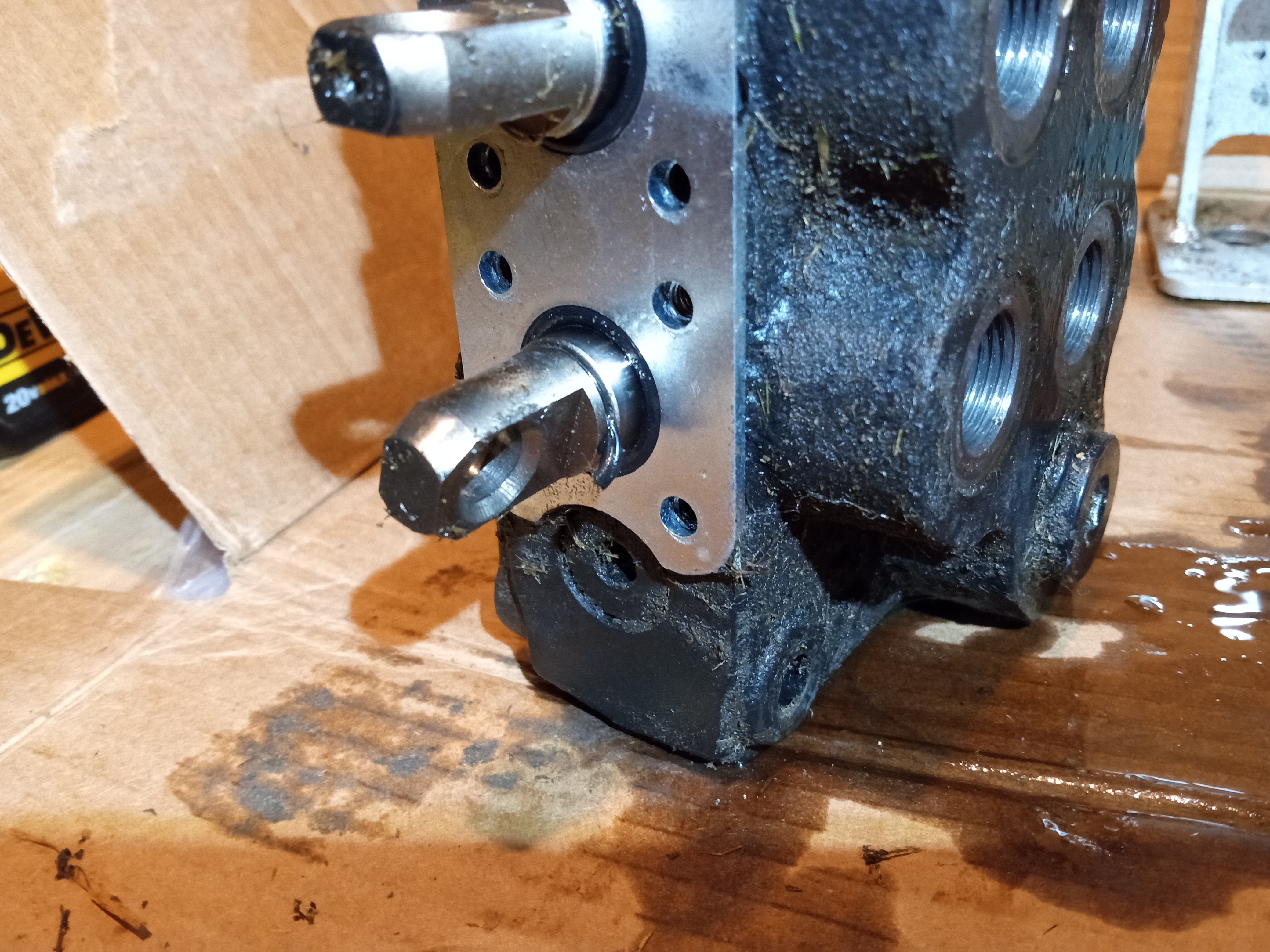

Some pictures of the sides:

I'm not going to name the dealership or exactly where they are located, that's not what this forum is about. It's to share information about the tractors and our experiences, to help each other out. I don't want anyone to get the wrong idea and think I am promoting them in any way. They have many locations, and have won many sales awards from LS. The sales numbers are real, you can believe or not believe whatever you want, it doesn't matter. Moving on to the important stuff:
The ports on the loader valves have nothing to do with the leaks. Yes, sometimes a bonded seal on the banjo fitting connections might leak and need to be replaced, but that's minor and can be fixed without replacing the valve. The o-rings that leak are under the silver colored metal plate on top of the valve where the lever linkages move the spools up and down. The pictures in the previous post show where the ball joints (or Heim joints if you prefer that term) connect to the spools. The leaks come from around the spools between that silver plate and the top of the valve. If the mounting screws come loose on that plate, it can cause the leaks also. You can sometimes see the blown o-rings sticking out when that happens. There is no parts breakdown for the valve, so the valves are being replaced. If the valve was taken apart, maybe the o-rings could be replaced if the size could be matched, and possibly the valves could be fixed. Don't know for sure, never tried. Maybe could save alot of money if it's out of warranty.

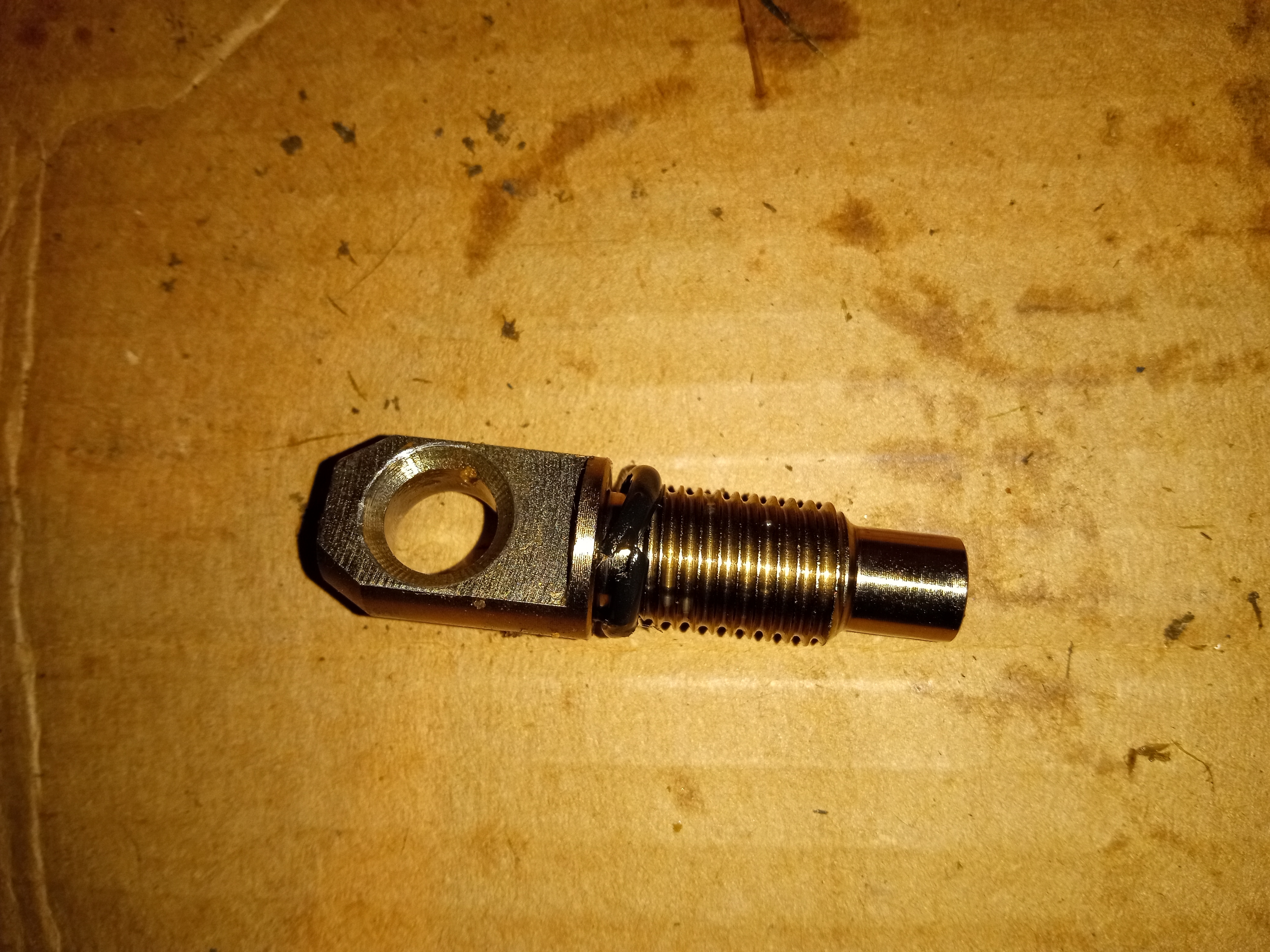

That's exactly where mine was leaking. Started taking the leaky valve apart and found the magic o-ring. You can see it sticking out:
Now I just need to figure out what size it is.
/ LS MT225S problems - is this normal? #14
Cool, glad you found it. I'll bet that piece came loose and unscrewed from the spool. There is a bulletin on that problem now, and it should be fixed after tractor serial 2351002914. Not sure how to figure out what size o-ring, and it has to be a perfect match. Close isn't good enough or it will fail right away. And it also needs to be the correct durometer, which is the stiffness of the rubber. If it's too soft or too stiff it won't last either, even if it's the correct size. It's probably a metric o-ring, but since there's no information for it, I hope you have good luck finding a match. The bulletin does not tell the size of the o-ring, only how the manufacturing process of the valve has been improved to prevent this. And the valve is not made by LS, it comes from a hydraulic supplier. Make sure you clean and Loc-tite the parts when you assemble it so this doesn't happen again.
View attachment 1664129Now I just need to figure out what size it is.

Bumping this to the top has anyone be able to figure out the O-ring size for replacement? I have the same issue the o-ring blew out of the top of the spool valve as pictured above. I have tried a few metric and standard o-rings but they only last a few hours. I rather not buy a new valve that seems like such a waste of money. Has anyone third part sourced the valve?
