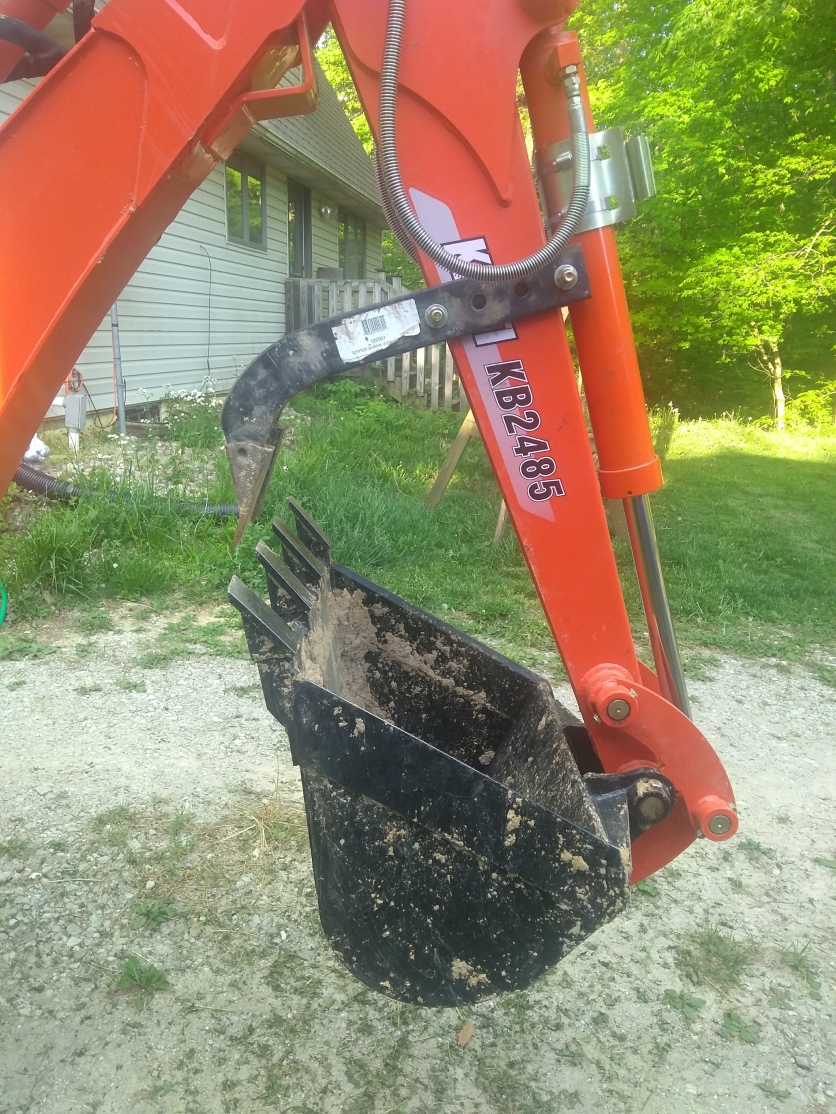

I tried picking up some large logs with just the bucket and could quite get under them. I had purchased two King Kutter Box grader knives for a different project and got to thinking -- I could buy some steel and make a simple bracket and bolt them onto the boom. When I held one up to the boom -- the holes lined up perfectly. I bought 2 Grade #8 bolts, 6" long, lock washers and nuts and mounted them as shown. I was able to lift the log on the first try. There's no fancy angle adjustments -- I moved it up/down the boom to just mate up with the teeth on the bucket. I think this will come in handy during future trips into the woods.
   / 2010 DS4510HS -- should I buy a backhoe or trade in or rent? #29
That looks slick. Should get the job done.

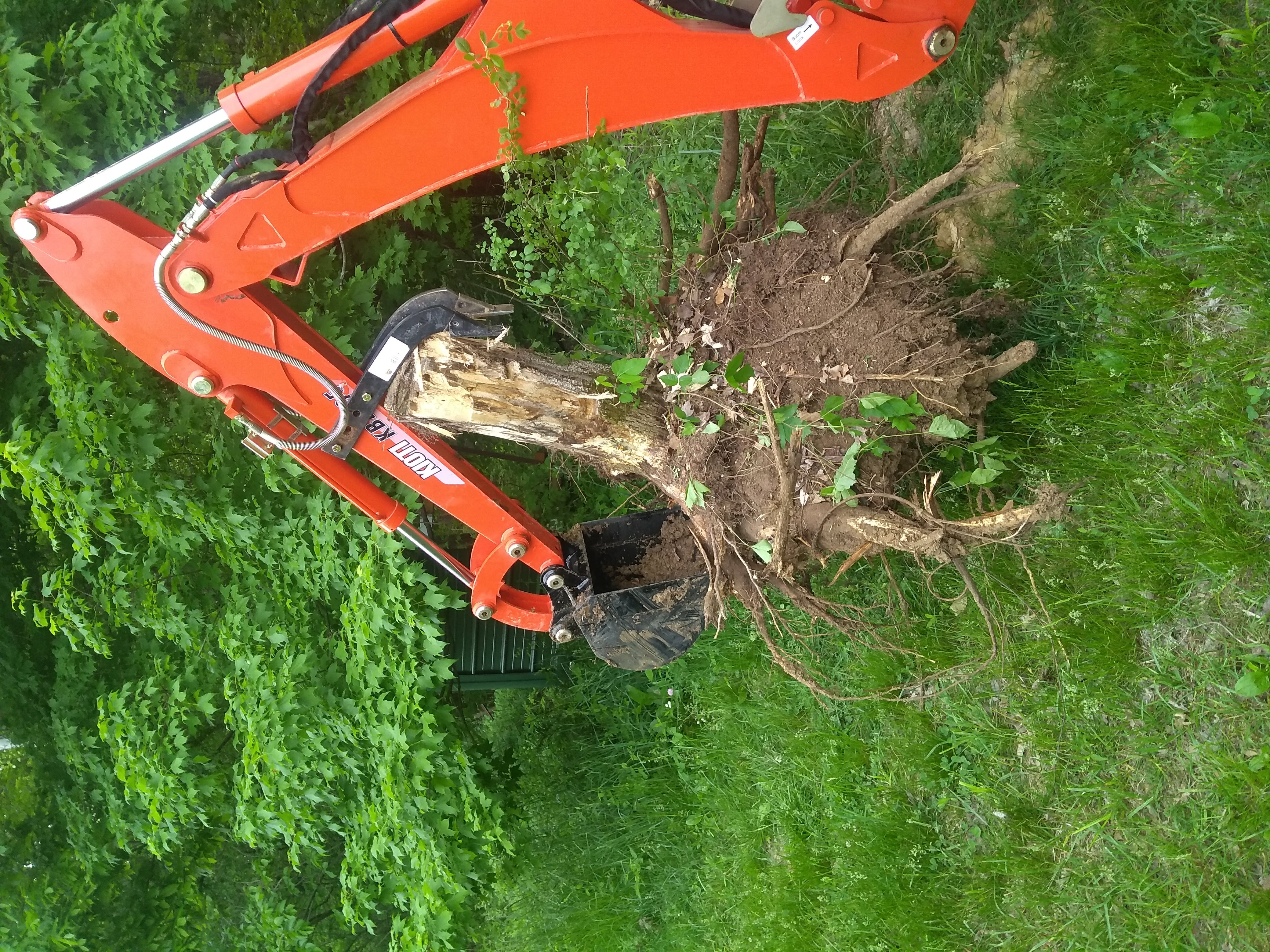

Yesterday, I stopped in at the dealer -- he had ordered a 12" backhoe bucket. We talked about it -- and I decided to buy it from him and keep my 18" bucket. I swapped it out today and headed for the woods. It seems to be be a little bit stronger in breaking up roots -- but that's a little hard to say -- I tackled an older stump and the roots might have been softer (Poplar) and decayed. In about an hour, I had a stump out of the ground (shown) and headed to the burn pile. Cycle times were a little quicker, as I'm not lifting nearly as much heavy clay out of the ground with each dip (and the bucket weighs less). IMG_20180518_092538239.jpg
