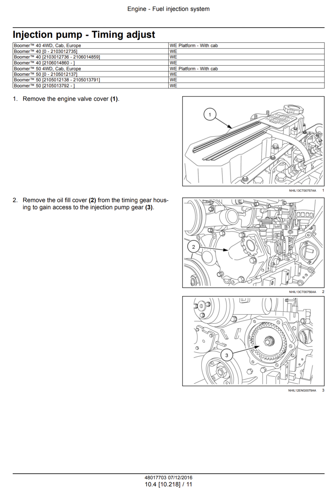

/ 2011 Boomer 40 fuel pump timing
This is the pump it is hard to read the etched numbers. Also included some of the service manual it does not have any info for setting the proper pump install if you did not follow these steps when taking it off.
I have no idea what to try next any help would be great.
I forgot to mention I found a downloadable service manual that I bought and it does not have any instruction on how to set pump timing other than doing it before removing.

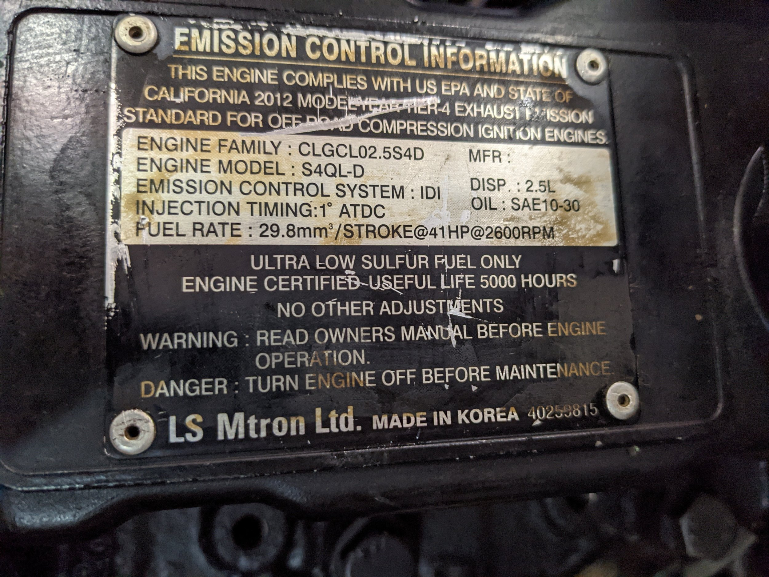

/ 2011 Boomer 40 fuel pump timing #6
On the valve cover, is there a tag giving any info such as 1.0mm @ outlet A.??
/ 2011 Boomer 40 fuel pump timing #7
BTW.. it’s a Zexel VE pump.
If u could LIGHTLY sand the housing where name plate is etched, it may help get the #’s.??
Yes it does it. It is 1° ATDC I'm hoping to find a way to get this done without removing the front cover in the engine. Especially since it has been completely installed filled with fluids and not even sure if the gears have markings.
