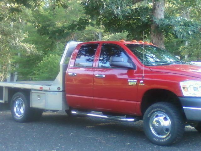

Also people want pick up beds cause they look good.
Kinda hard getting a date driving a flatbed, utility body or dump around :D
JB.
Come on now, all you gotta do is keep it clean and pretty. Heel prints are hard to get out of the headliner though :)
   / 2011 Ram Chassis Cab #18
After putting a custom bed on a my CCf450 I will find it hard to go back to a truck with a bed. I like a pickup bed but a dump with toolboxes has been the best setup ever. I wish I had done it sooner. We use it as a personal truck and service truck. CC is not a everyday grocery getter but for farm or construction work they really shine.
   / 2011 Ram Chassis Cab #19
:D:laughing:
Nice looking truck, too!
