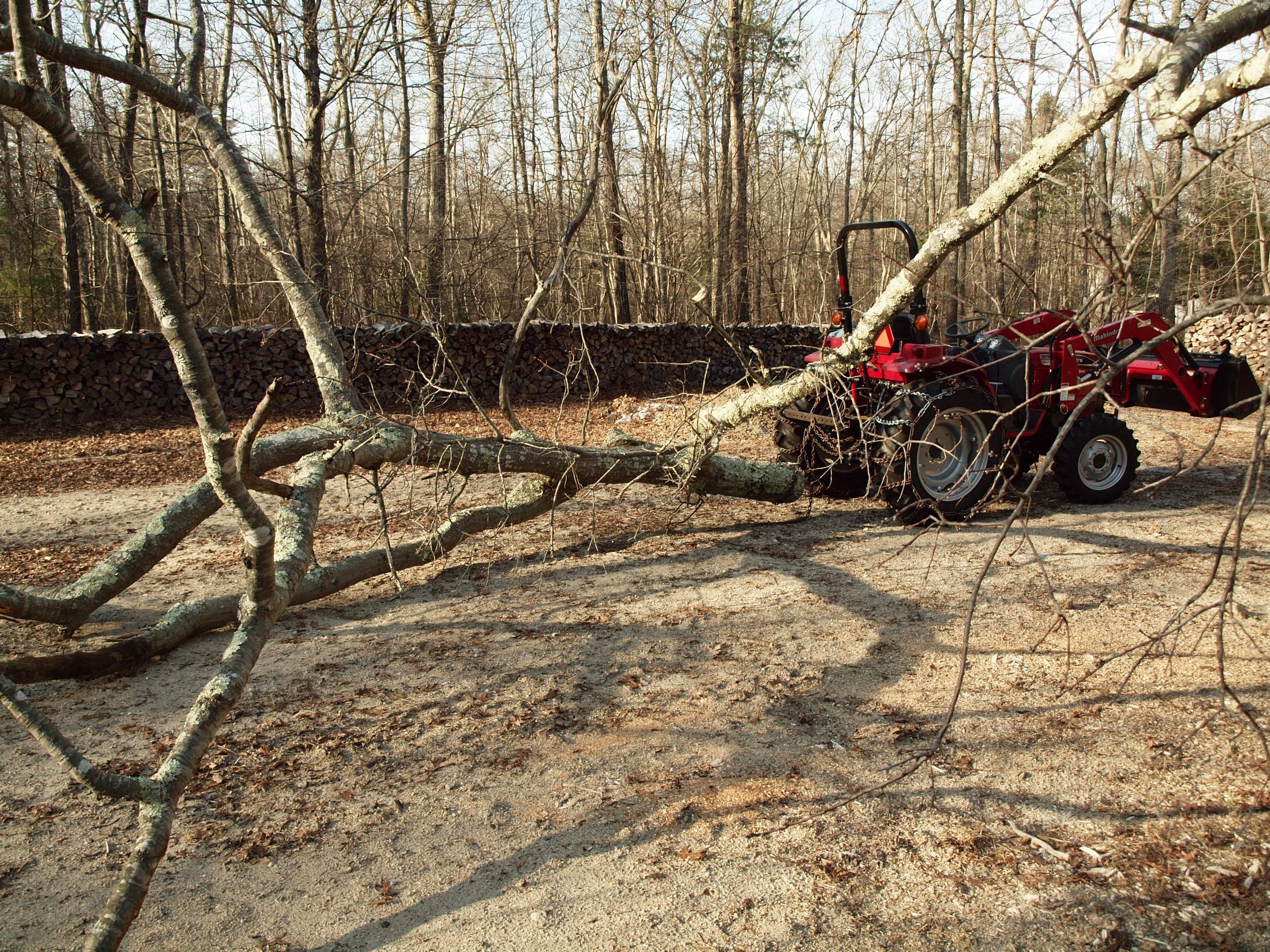

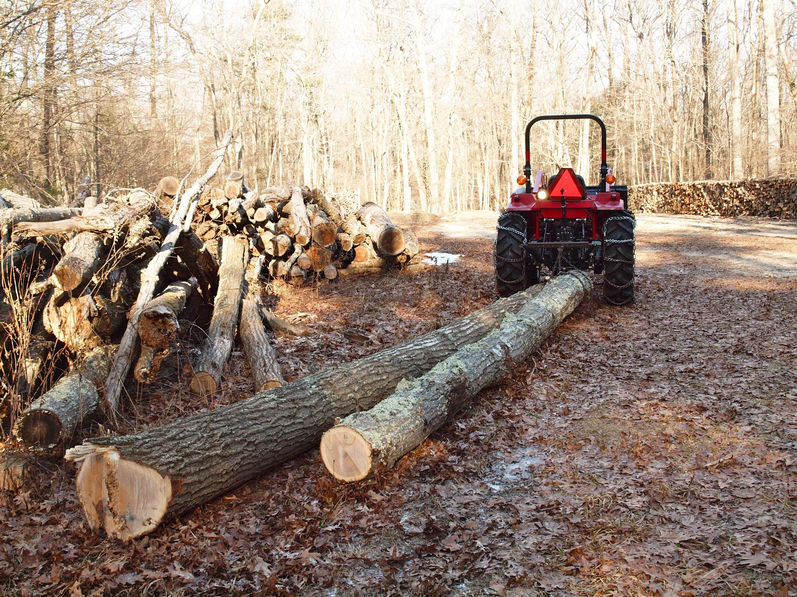

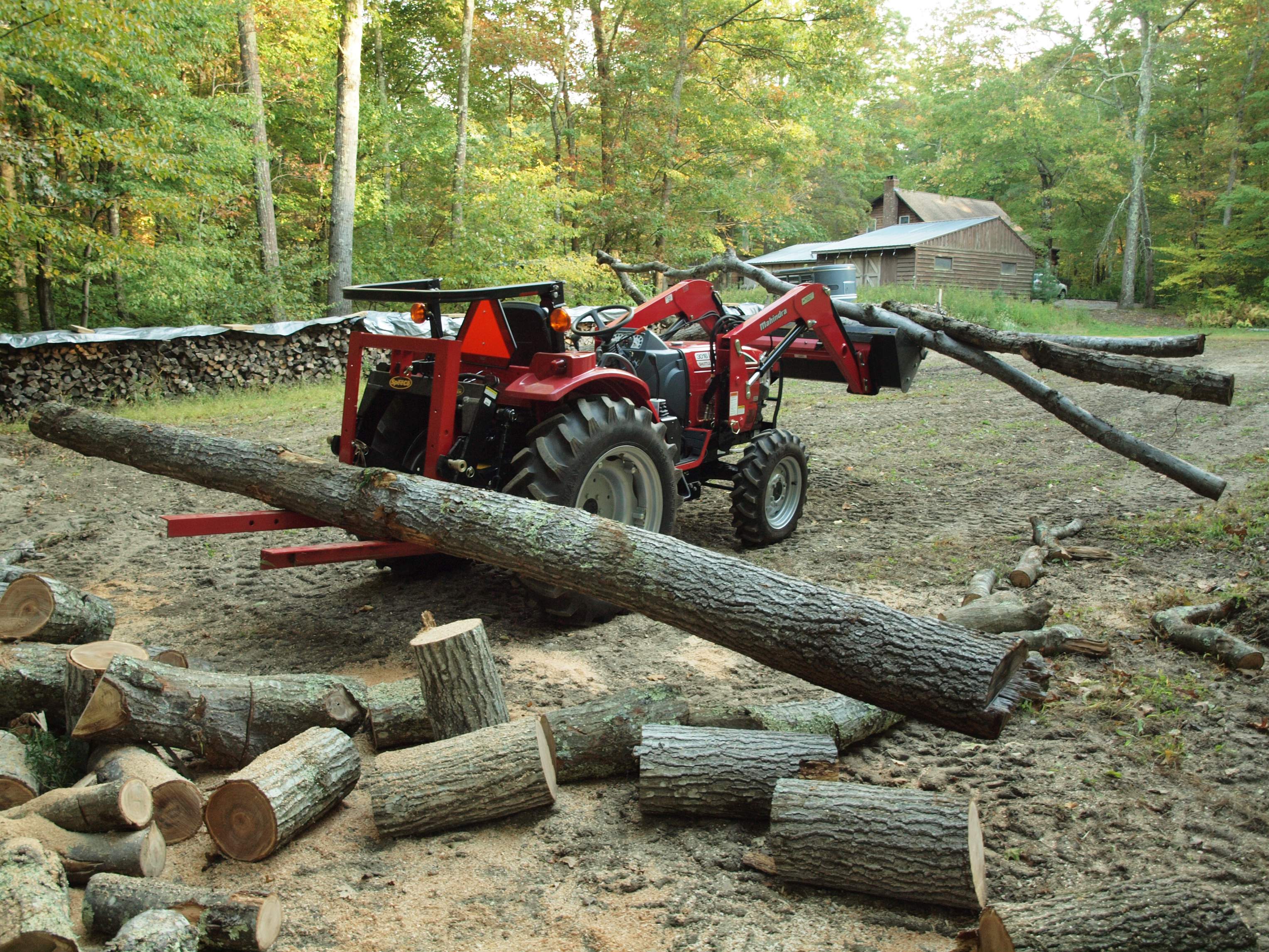

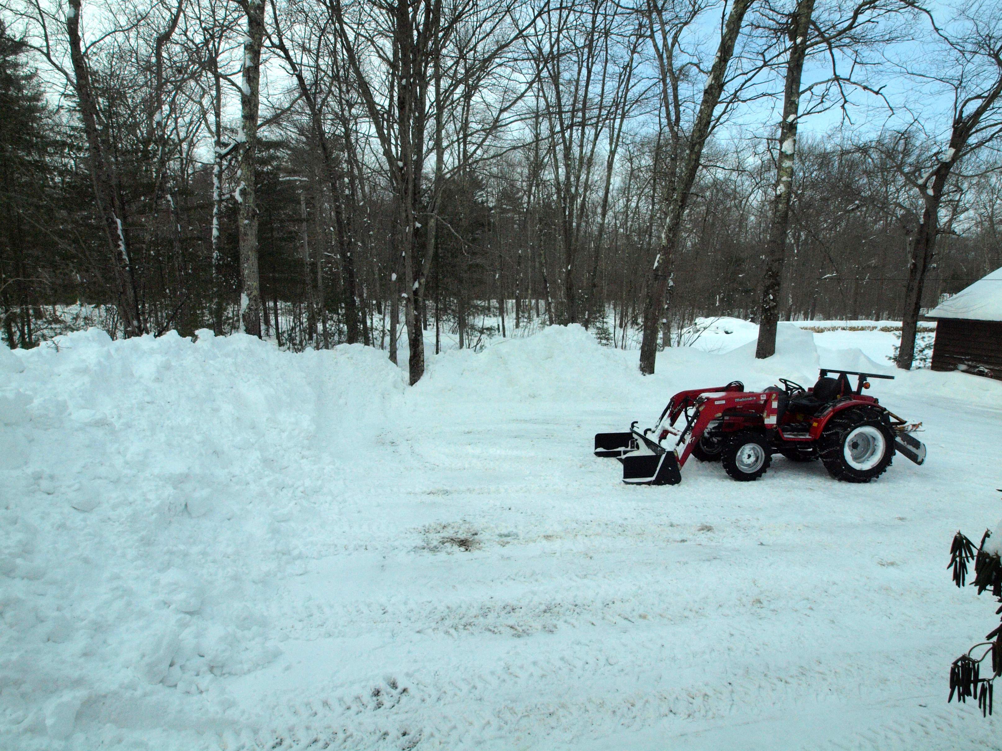

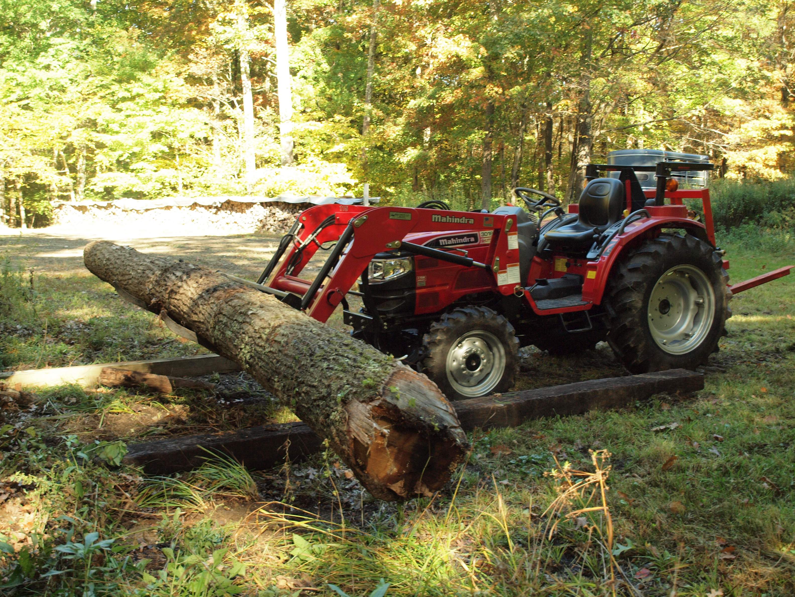

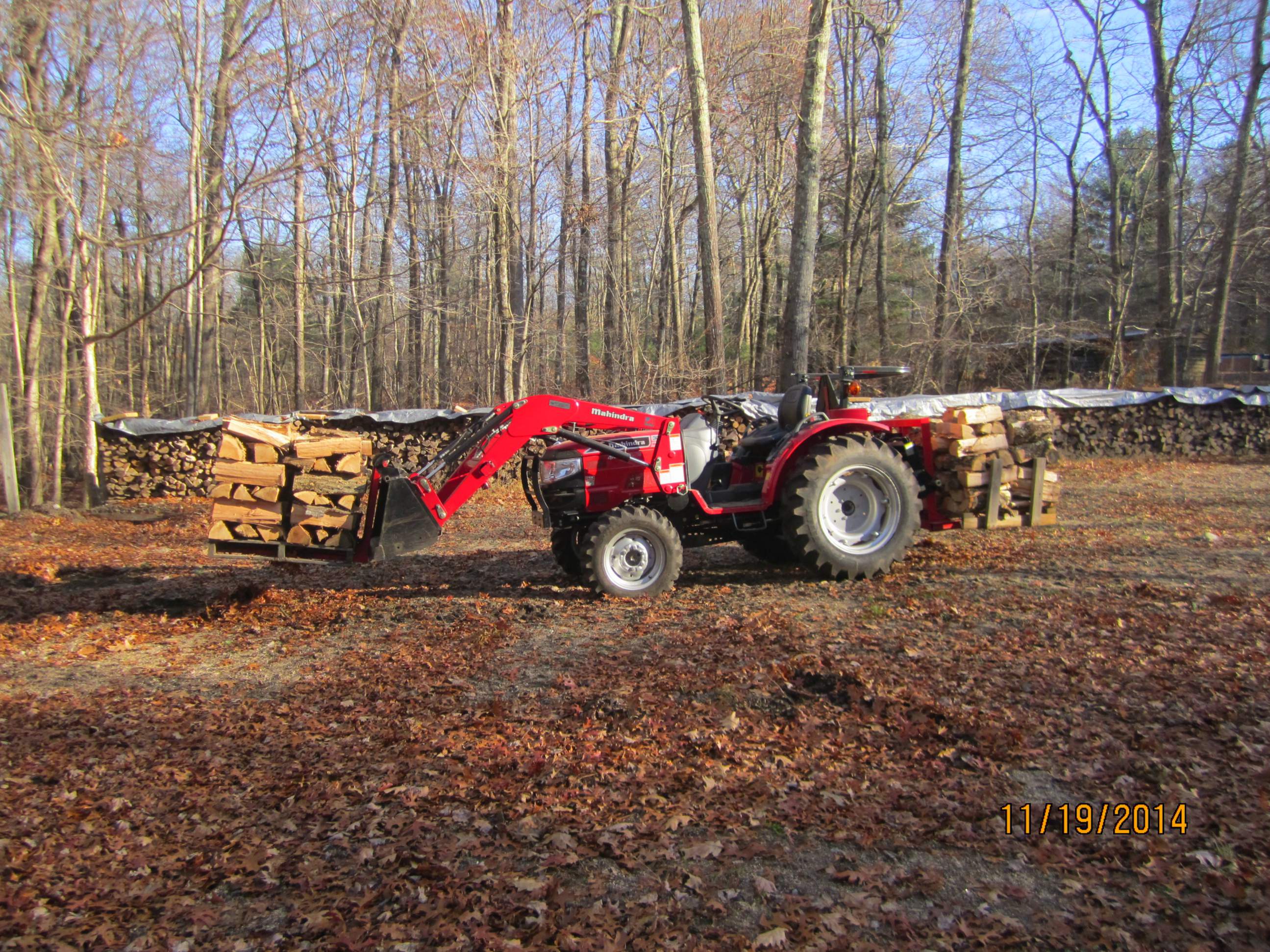

careful...the 3016 is rated for 1650 @ the fel and over 2200 lbs @ the 3 pt. It's sister tractor (3616 and same frame) with 6 more hp, is rated exactly the same. A bigger frame tractor has the advantage of more weight but not necessarily more lift capacity than the over achiever 16 series from Mahindra. You may have to jump to the 45 - 50 hp class to get an appreciable difference.
Here's some pics of 3016 capacity so you may judge for yourself applicable to the work you do. The big stem weighs in just short of 1800 lbs.

Thanks Arrow! Those are some impressive pics. I bought a 20 acre wooded parcel of land that I have started clearing so I will be doing a lot of similar work. I like the rear pallet forks, where did you get them?

TSC. I beefed them up however as they are rated for only a thousand lbs. They art not considered "forks" but are listed as a " utility 3 pt carry all".
