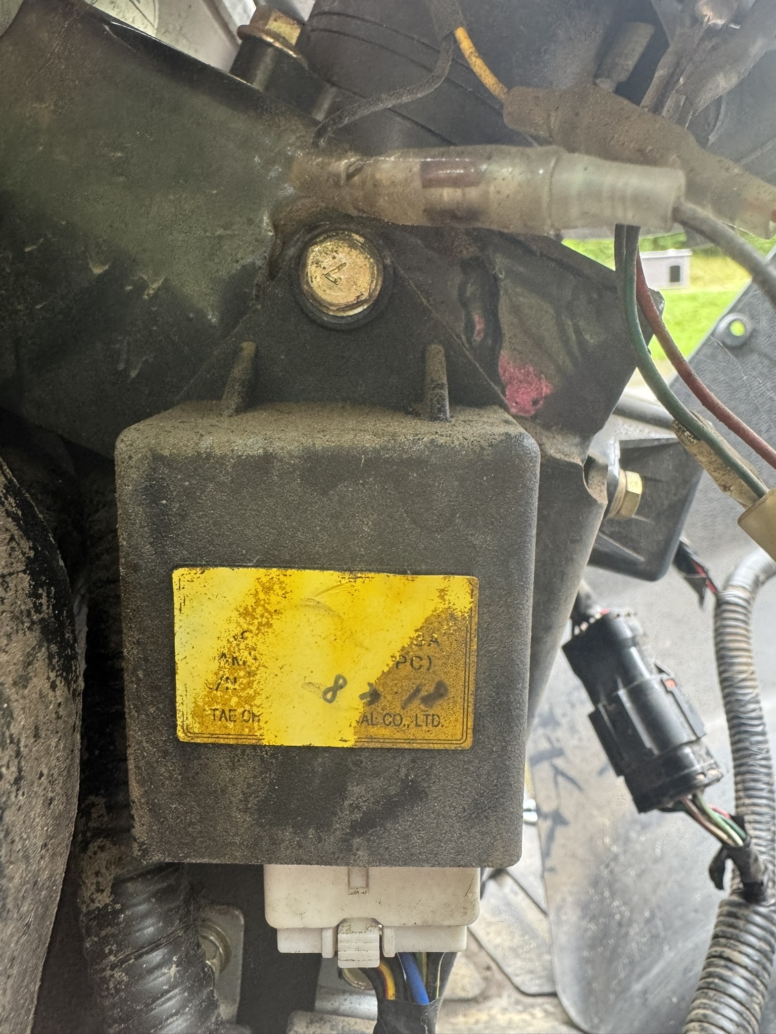

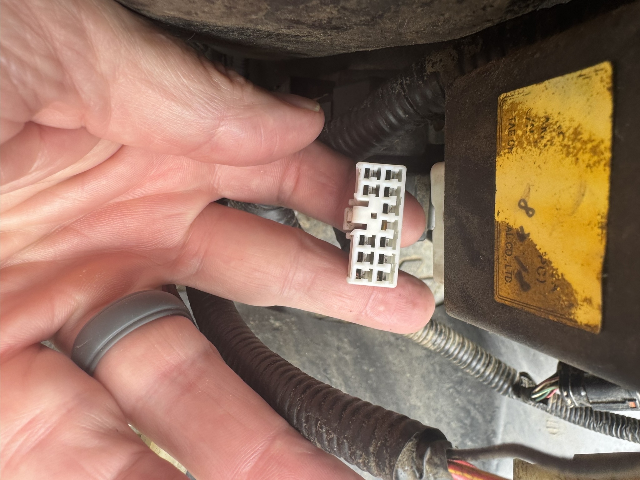

I have a 2013 Branson 2400 that will not hit a lick. I have replaced almost everything except for the starter relay controller OPC part number HA00000013A. I cannot locate one on the web or by phone. Any suggestions on where I can get one would be greatly appreciated.

I expect that it combines all the safety switches and then allows the start command to the starter solenoid and possibly the fuel solenoid.
It wouldn't be hard to bypass but then it could be started in gear, pto on, and even the hydro pedals pressed, and nobody in the seat.

That would be my guess too. In that case it would be pretty easy to open the controller box up and use a VOM to test which of the safety switches and/or solenoids are not working.

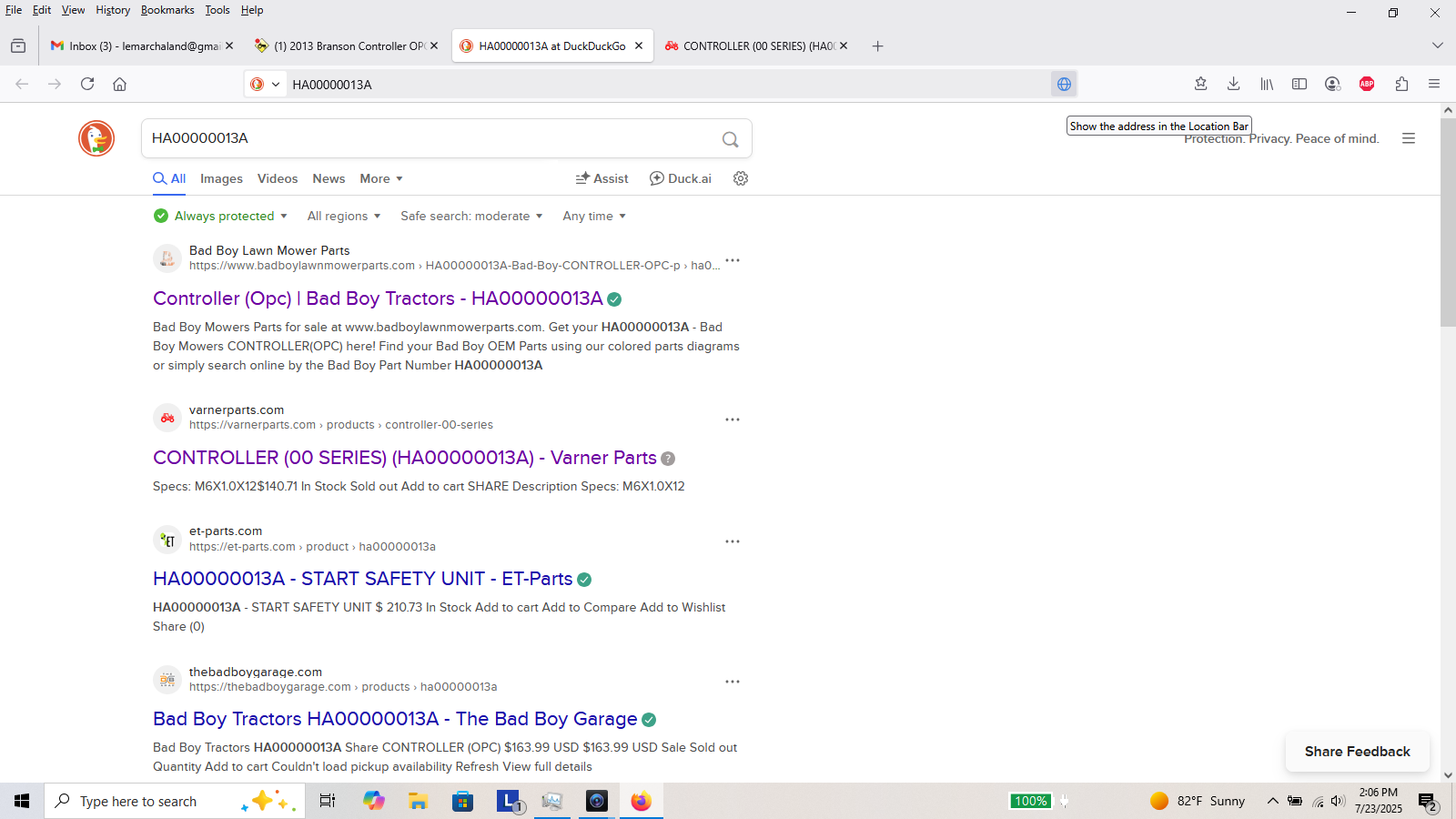

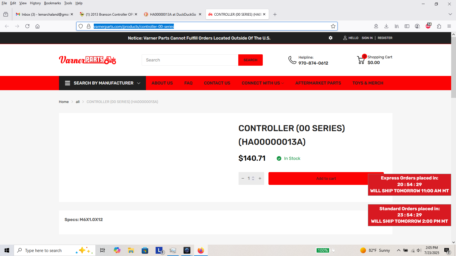

The alternative method to testing is to continue to throw parts at it. Entering the controller number HA00000013A into Google Search shows half a dozen places that claim to have the part for sale. All about the same price.

You could...but my guess is that Lou is right that the "Controller" offers convenient access to half a dozen safety devices and solenoids. And no telling what else it does. The actual problem could be in any one of those parts.
First thing I would do is put the tractor into neutral, lock all brakes, turn off the PTO, and then use a battery cable to jump from the battery + to the insulated terminal on the starter and see if the starter itself is any good. Then work backwards from there with a test light or VOM.
