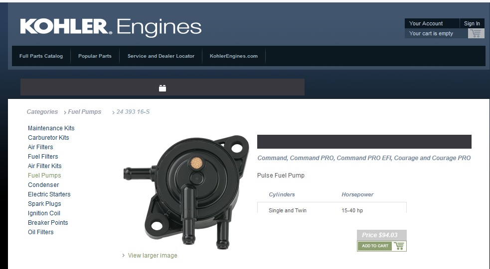

Agree with Bob B's suggestion to diagnose problem.
I suspect a failing fuel pump or cracked vacuum line which powers the fuel pump.
Kohler Fuel Pump NEW 17 HP | eBay
Dave M7040

OK Bob B, I did your test. Motor conked out after 15 - 20 minutes again. I sprayed starter fluid into the air intake immediately afterward and it started right up. So, it sure seems to be a fuel flow problem. I think I am going to go ahead and order a new fuel pump. I also figured I may as well get new fuel lines while I am at it. I'll let you know how it turns out (might not be until next weekend). Thanks for the help!

Welp, it wasn't the fuel pump or fuel lines. Ordering the solenoid. We'll see if that's it?

Well, 3 months later, here's an update. As noted above, I installed a new fuel pump and that wasn't the problem. I installed a new solenoid and that didn't help either. My neighbor Joe didn't like the color of my spark, so I installed new coils and wires; didn't fix it. BUT, it does run for a sustained period of time now AS LONG AS I start out with a full tank of fuel. Once the fuel gets down to 1/3rd - 1/4th full, it stalls out as before. So, I guess a cheap repair would be just to keep the fuel leve up. However, I really would like to get to the root cause and fix this thing. Any ideas? Thanks.
