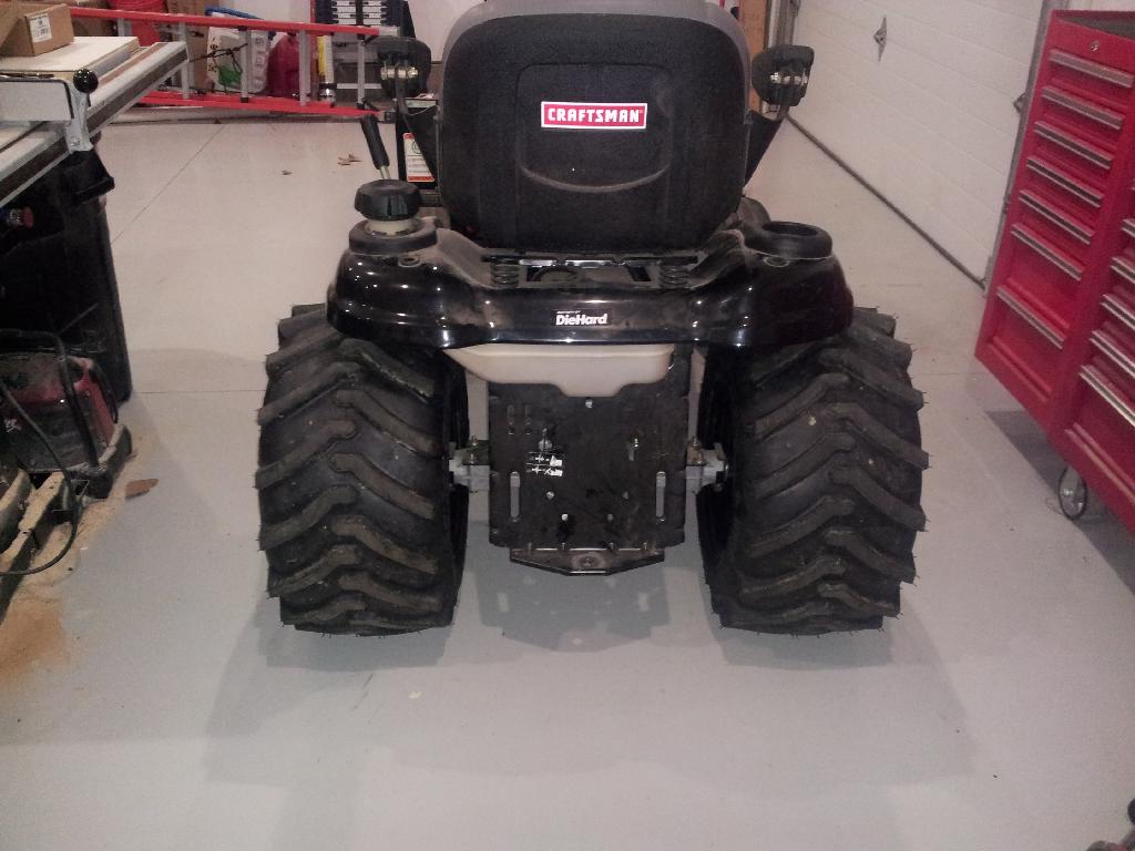

The bolt pattern is standard, before buying the tires we took them off my neighbors x749 and they went right on. I needed a little wider stance to mow an area that's steep and has to be cut side ways, so I added 1 1/2" wheel spacers. I'll add pictures of this too, they helped make a little more space so the deck height linkage didn't rub the tire lugs.

I do run the All-Trails all year, I really like them in the grass. My front yard is pretty sloped, and the turfs tend to slide too much. I did fill these with Rimguard and it really feels planted now. Before buying those I tried going with the bar-type lugs with OTR Tracmasters in 24x12x12 and while they worked OK in the snow, I still needed chains and the one time I used them in the grass they shreaded it with any wheel slip. In the areas what were softer/wet, I also found them leaving indents in the dirt. Not a big deal, but I didn't like it. The All-trails have been great year round to the point that I'm going to sell the others w/ rims (both turf and the OTRs).
The clumping isssue I ran into got really bad when I swapped to Meg-Mo's. They are really cool and mulch very well, but the clumping at first was insane- so bad that after 2 or 3 cuts the deck was full to the blades and it wouldn't cut. After a few cleanings I called Roy (owner of Meg Mo blades) and found that these blades need a ton of airflow and the pulley covers had to go as well as any baffles. The difference was immediate. Although the deck still gets some grass stuck to it, its' nothing like it was. In the fall when I pulled the deck and mounted the snow blower I wire-wheeled the underside and primed the whole thing. I considered buying that graphite spray paint that's supposed to stop anything from sticking to it but never got around to it.

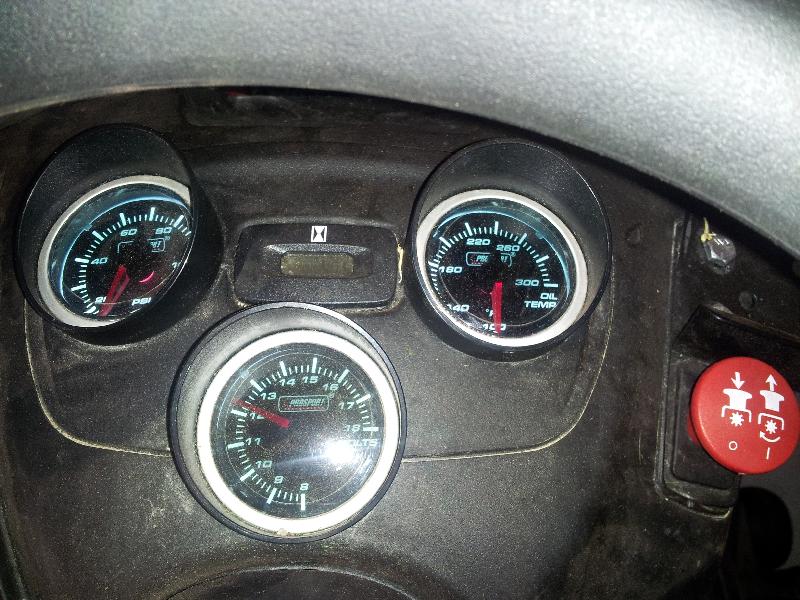

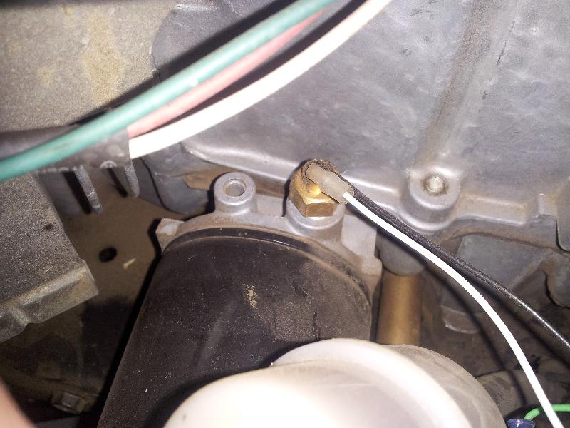

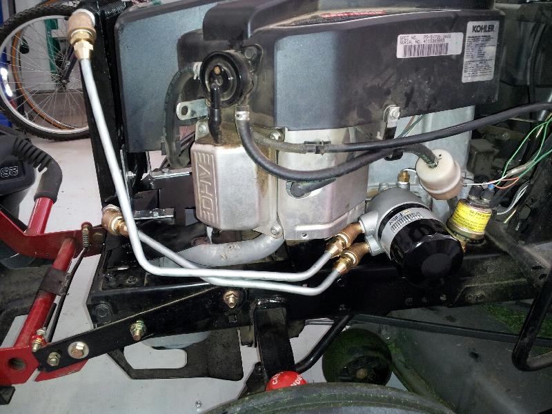

Here are some pics of the rear end with the spacers and OTR Tracmasters, the oil temp sensor, the gauges, and the oil cooler. I can take more, found these on my laptop.

That looks like a great setup there. The oil filter tap off with the integrated temp sensor looks ideal and OEM like.

I did use the OTRs all last winter and while they do self clean very well, I found once it gets hard packed or there is any glaze on the pavement they just spin. I went as far as loading them with rimguard, 55 lb wheel weights, and strapped 180 lbs to the rear and they still spun (not to mention the rear end just cried and crawled coming back up the driveway). Took the weights off the wheels and off the rear, then added chains.
