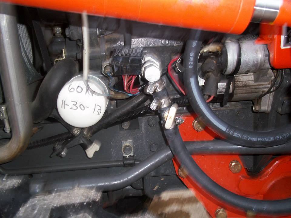

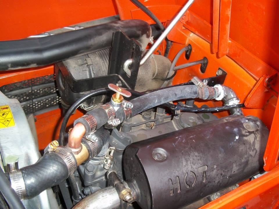

Mr Gpinthemitten. The engine block drain plug takes a 17MM allen wrench. I bought my wrench at Sears. I do have another T for the upper rad hose, if you would like to buy it. I bought the Tuck-a-way heater kit for my tractor, and it had two T's. One for the top and one for the bottom hose. As you see, I didn't use the bottom T. Thanks. javahjoe, MIO P K Junky, aka Don
   / 2013, Kubota B-2920 Heater installation #13
Thanks again. How much for the T ?
#14
They were expensive. I'll sell you the T for $20 plus $5 shipping. For a total of $25 delivered to your door, priority mail. These T's are sold in a kit from Tuck-a-way Heater Co. and can only be bought through a dealer. Tuck-a-way will not sell to the public. The kit sells for $90, and all you get are T's and hose clamps. I'll not be offended if you decline my offer. Thanks. javahjoe, MIO, P K Junky, aka Don
   / 2013, Kubota B-2920 Heater installation #15
Sounds good. I'll take it. I'll pm you so we can work out the details.
#16
I have more photo's of the heater installation. The engine drain plug, tap. The pipe running between the firewall and the muffler. Had a small leak at the engine block. Took it apart and re-taped the threads, and put it back together. NO LEAK NOW! :banghead: 100_1520.jpg100_1522.jpg100_1523.jpg100_1524.jpg
