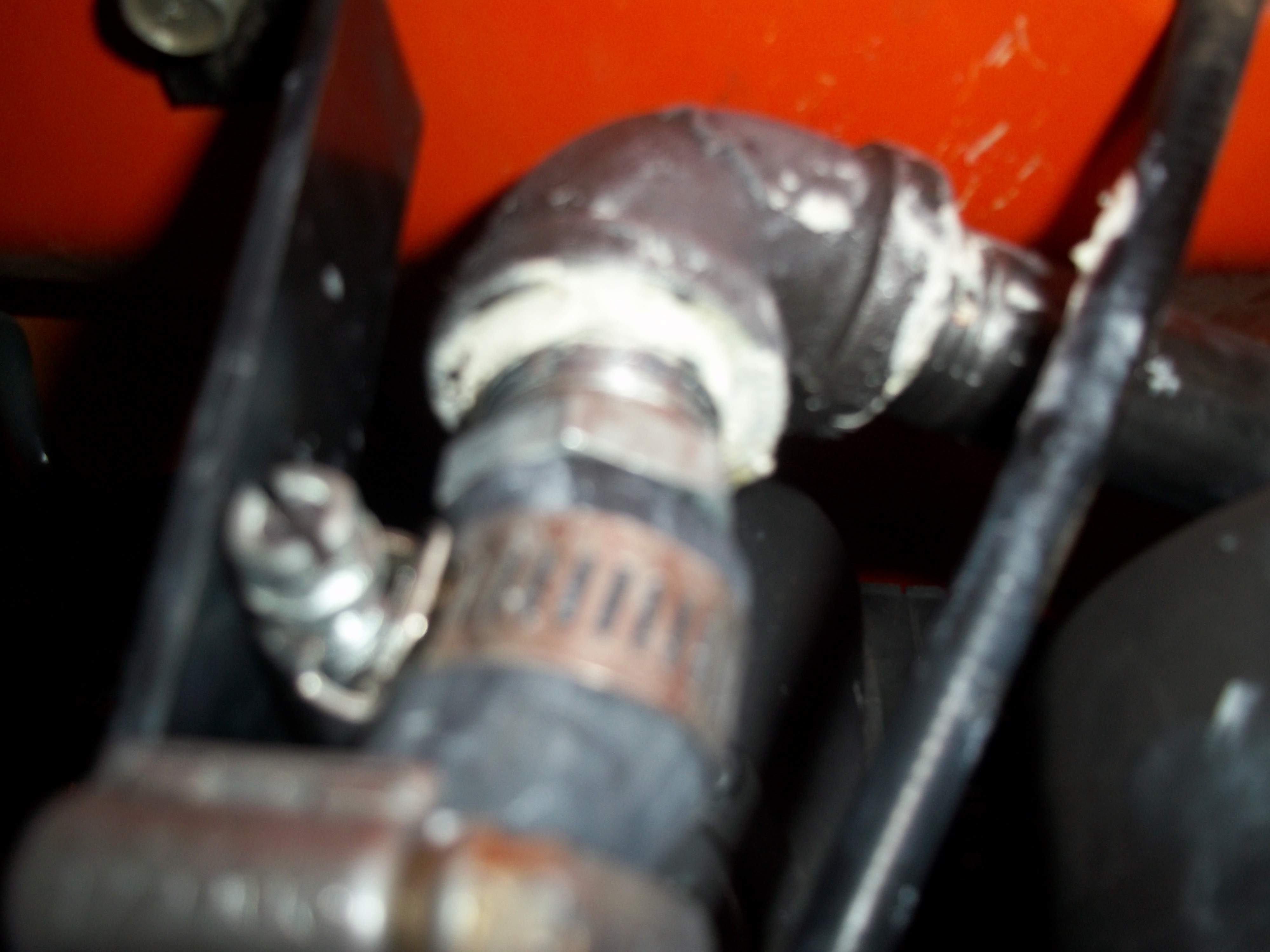

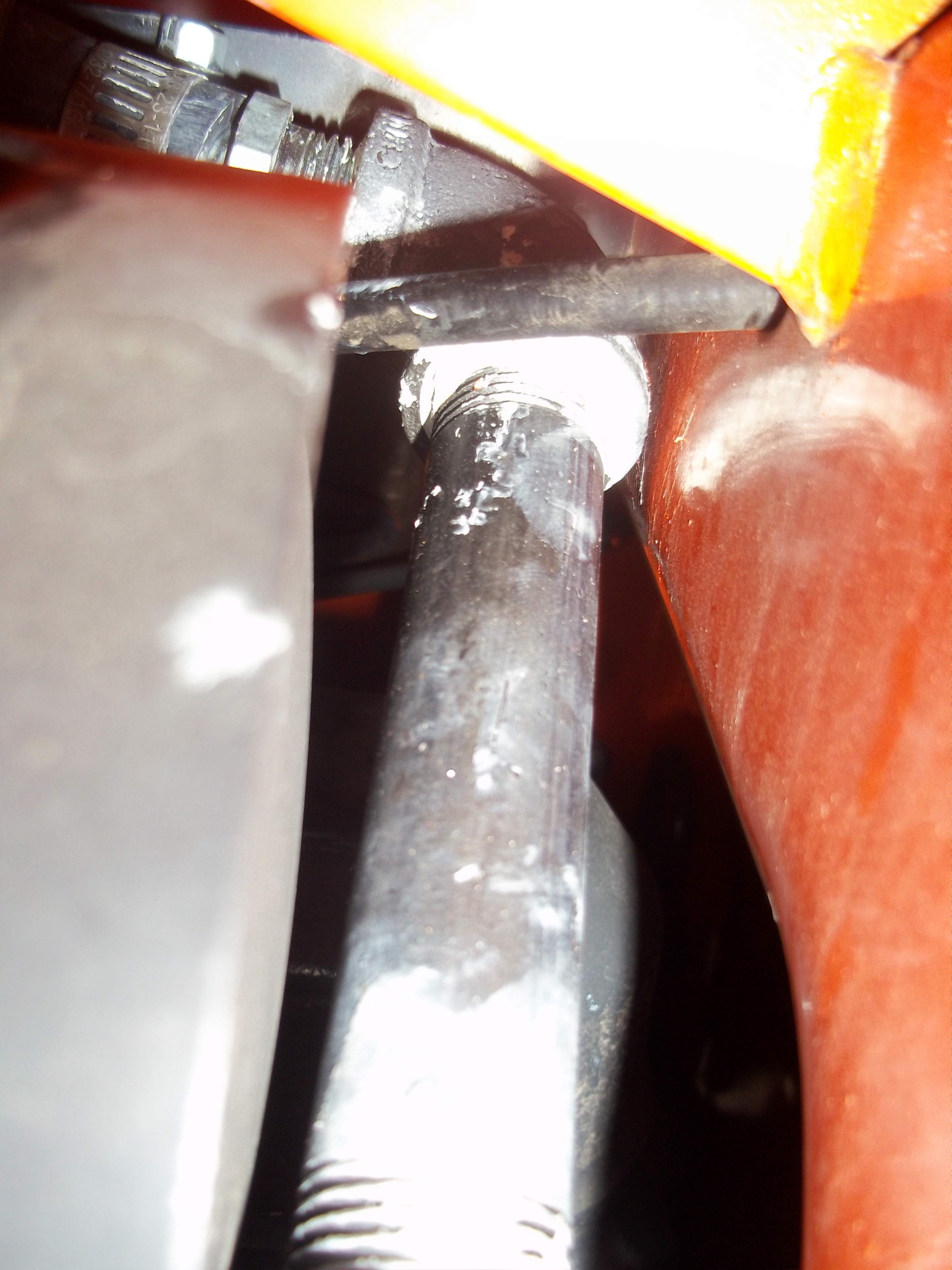

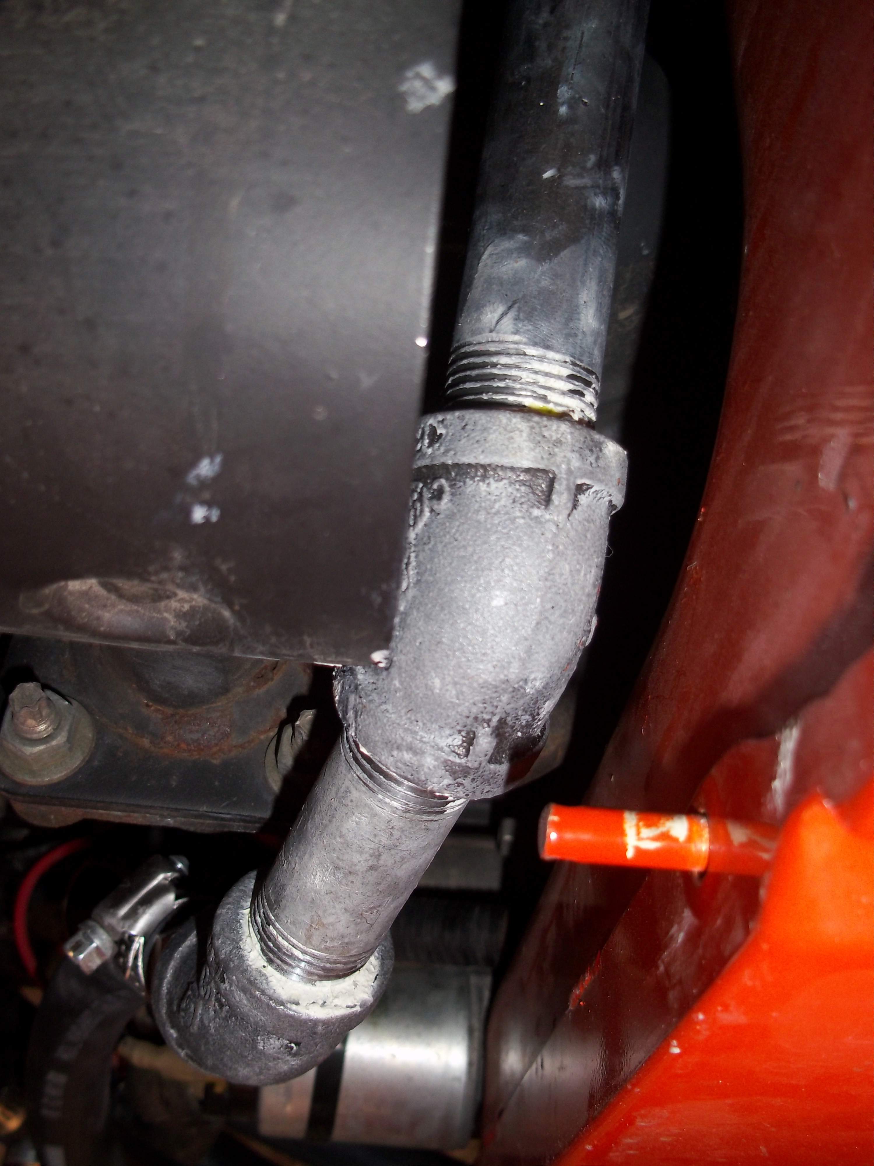

#16
I have more photo's of the heater installation. The engine drain plug, tap. The pipe running between the firewall and the muffler. Had a small leak at the engine block. Took it apart and re-taped the threads, and put it back together. NO LEAK NOW! :banghead: 100_1520.jpg100_1522.jpg100_1523.jpg100_1524.jpg
