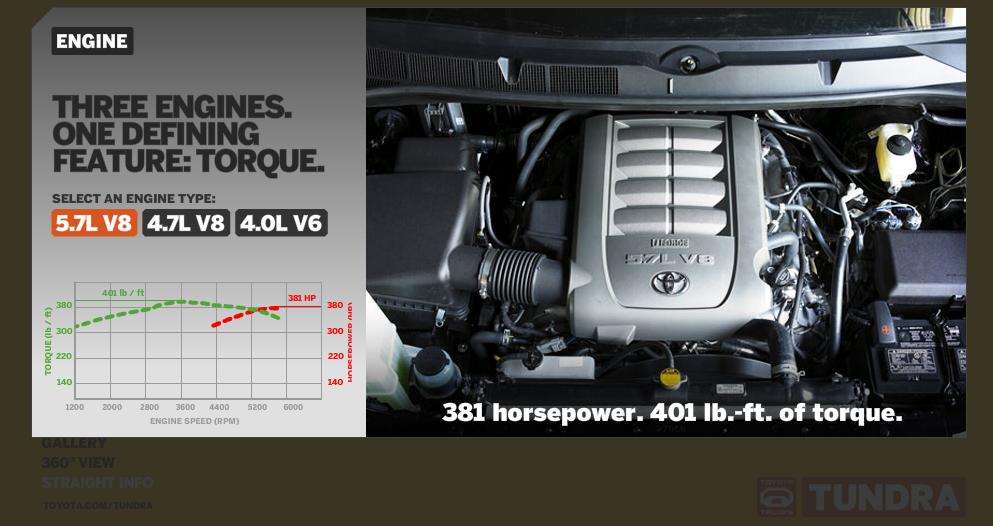

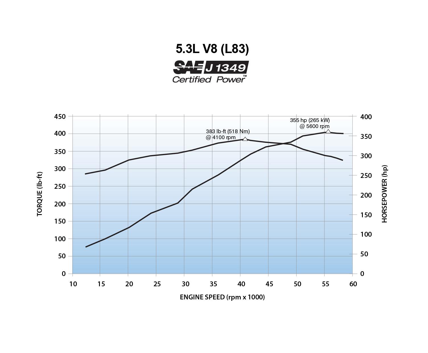

Here's a chart for HP and Torque for both the new 5.3 GM and the 07 Toyota 5.7. Yes the 5.7 is slightly larger and should make more power but Toyota's engine is a 7 year old design. These are real world numbers for two competing trucks you can buy today.
Both of these charts look like they have a very similar (flat) torque curve. How much of a boost did the GM 5.3 get over last years model?
The advantages of an overhead cam set up is there's less parts and weight that the valve spring needs to move when the valve is closing. That allows the OHC motor to rev higher without the valves floating. Since it can rev higher mfgs tend to make them do just that, but it's designed to take advantage of that feature. The 4 valve set up allows much better flow through the head. The OHV engine is easier to design variable valve cam timing.
The downside is that they require a lot more work to build. The heads are a lot more complicated. There's 4 cams vs a single cam. There's a complicated timing belt/ chain that has to go to both heads. There has to be a gear set up in each head to drive the second cam. Simply put there are a lot more engineering design work needed to get the most out of a OHC set up. The OHV design is simple. It's easy to work on, it's a tried and true design, it requires less machine work to build, it's lighter in weight, the head height is smaller so it doesn't fill up the engine bay, it's a solid engine. Personally I think that GM will switch over in the future. I just think that they would of needed to start working on the design back when they had a cash crunch.
