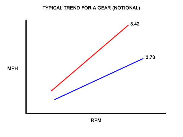

Here's a notional graph of how the ratios would compare in a single gear, just for discussion purposes. In reality you have a separate line for each gear in the transmission, with slope increasing as the gear increases (ratio decreases). A good science project for kids is to ride along and call out pairs of (RPM,MPH) points and write down, then make plots (you only need two points for each gear since it's linear).
<img
Only linear on gears in which the torque convert can and is locked. On my ford, torque converter will Lock 3rd through 6th gear. As I said earlier, gas mileage won't suffer until you are locked in the highest gear because the transmission will just up shift earlier and keep similar ratios at lower speeds.
