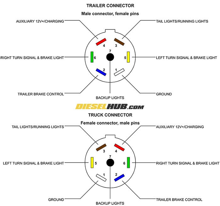

unplug the trailer. Use a meter, pull a bulb in the light that doesnt work. check if your circuit is open or not.
plug the trailer back into your vehicle. check if there is power to the light.
can be a fuse or lack of. power wire not wired to power or ground for the two lights not hooked up.
Trailer should have fuses. Pull all the fuses and check as well. swap them in different positions. a fuse can look ok but doesnt mean it works.
   / 2014 Sundowner 3 horse bumper pull trailer light question
#12
A battery or an old style "dumb" battery charger and a couple of jumper wires is how I would do it.
Looks like you will need pins 1 and 4 (4:30 and 10:30 if looking at the end of the trailer plug that goes into the truck) per this diagram:
Source: dieselhub.com/img/figures/7-pin-trailer-connector.jpg
Aaron Z
Fixed! It was a loose connection in the trailer plug. Thanks for all the help guys
