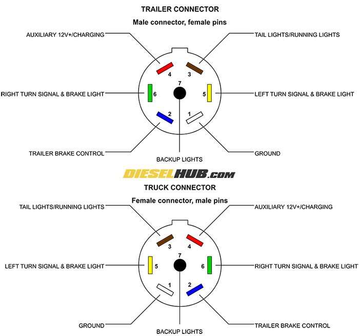

A battery or an old style "dumb" battery charger and a couple of jumper wires is how I would do it.
Looks like you will need pins 1 and 4 (4:30 and 10:30 if looking at the end of the trailer plug that goes into the truck) per this diagram:
Source: dieselhub.com/img/figures/7-pin-trailer-connector.jpg
Aaron Z
Fixed! It was a loose connection in the trailer plug. Thanks for all the help guys

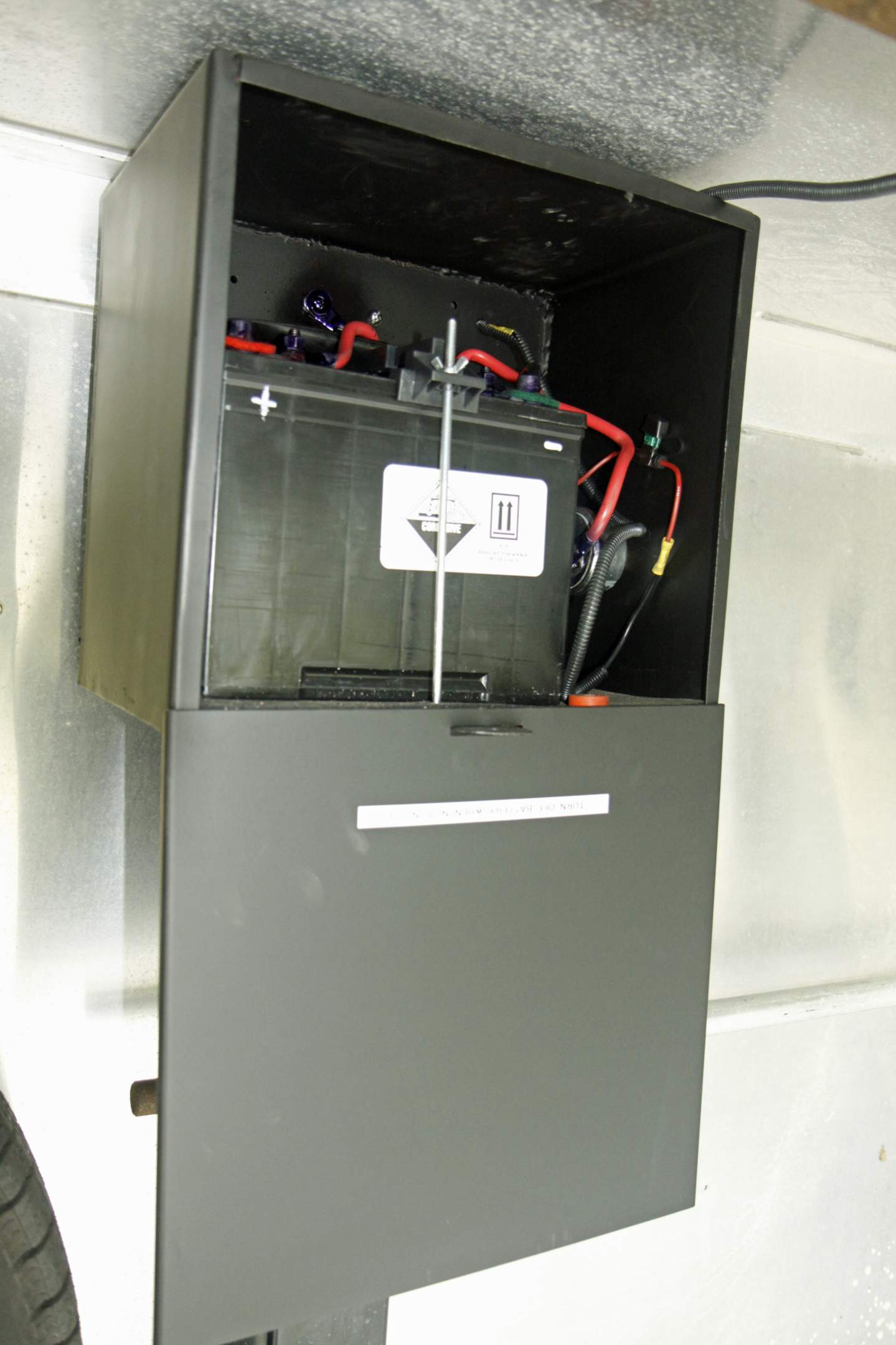

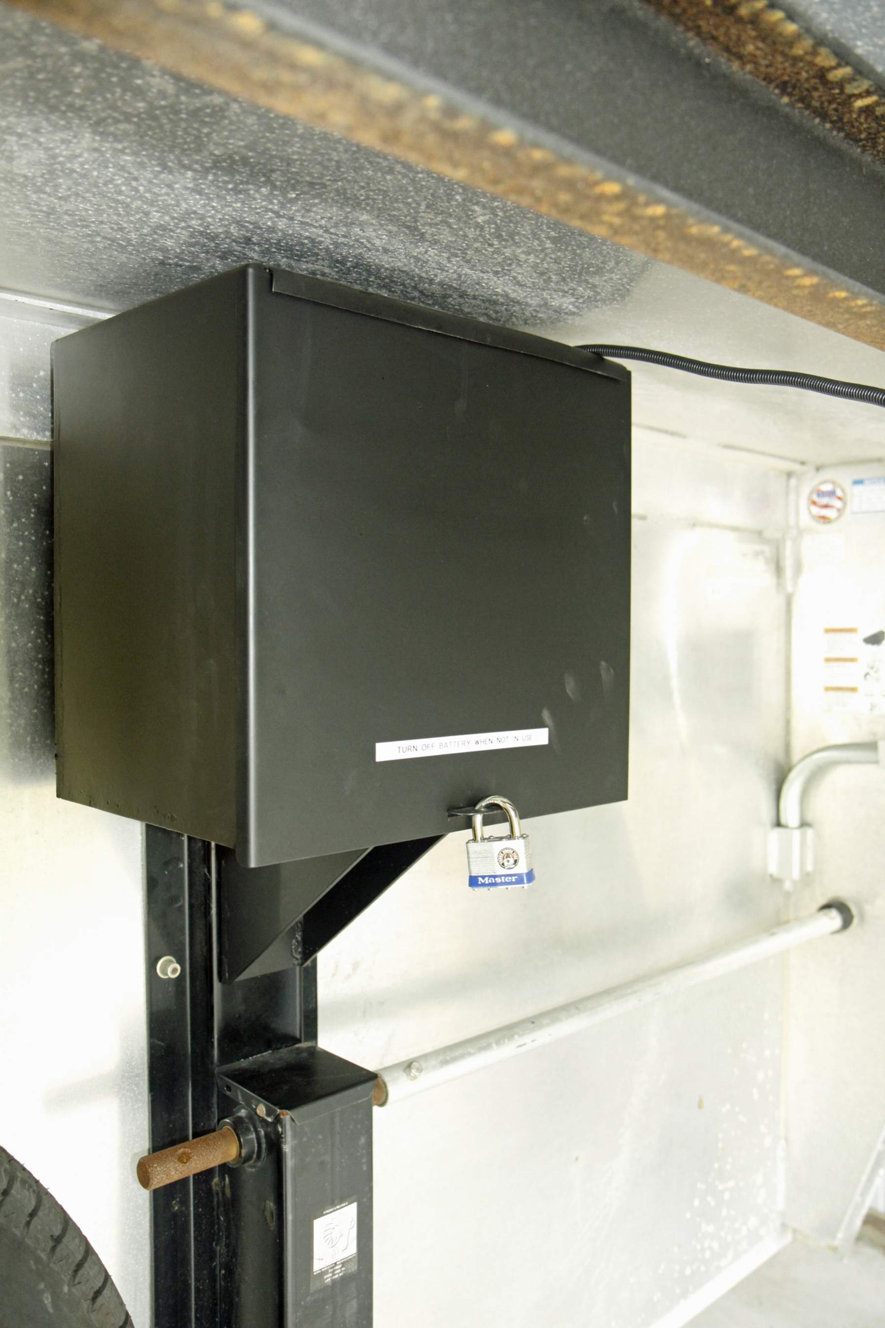

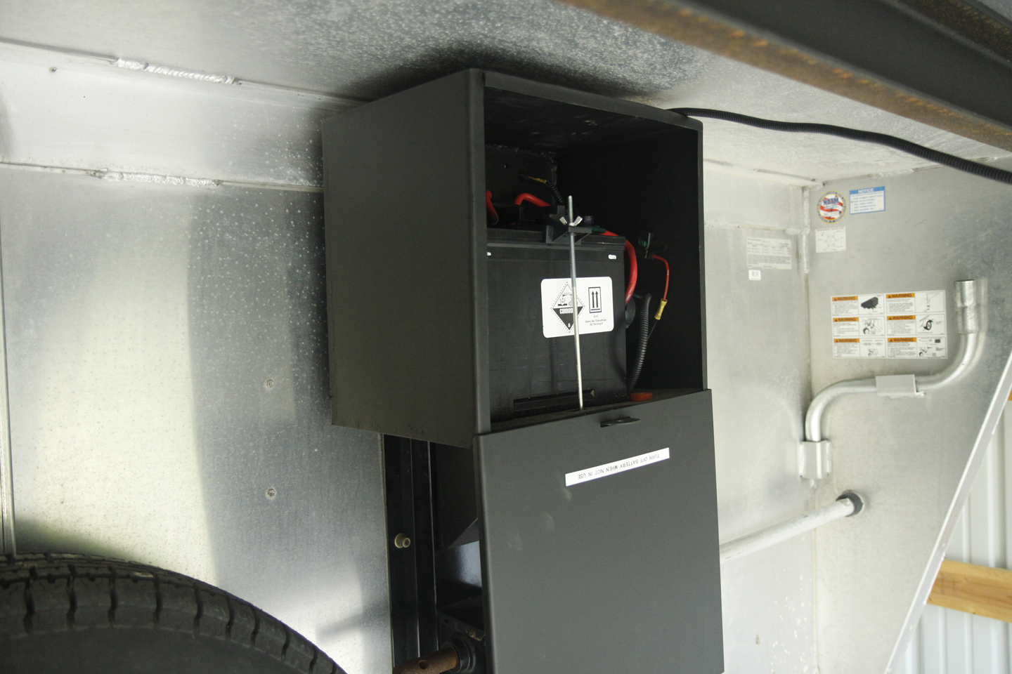

I did the same on m6 wifes 30 foot horse trailer. i built a locking metal box and installed a deep cycle battery. charges when hooked up to my truck. i remove battery and leave on trickle charger in winter. battery box small 2.jpg battery box small 1.jpg battery box small 3.jpg trailer small.jpg
hard to see on these pictures, but i added a battery cut off switch on one side. i can use this battery to operate the electric jack without the trailer attached to truck. also can operate all lights, inside and out when not attached. works great at horse shows
