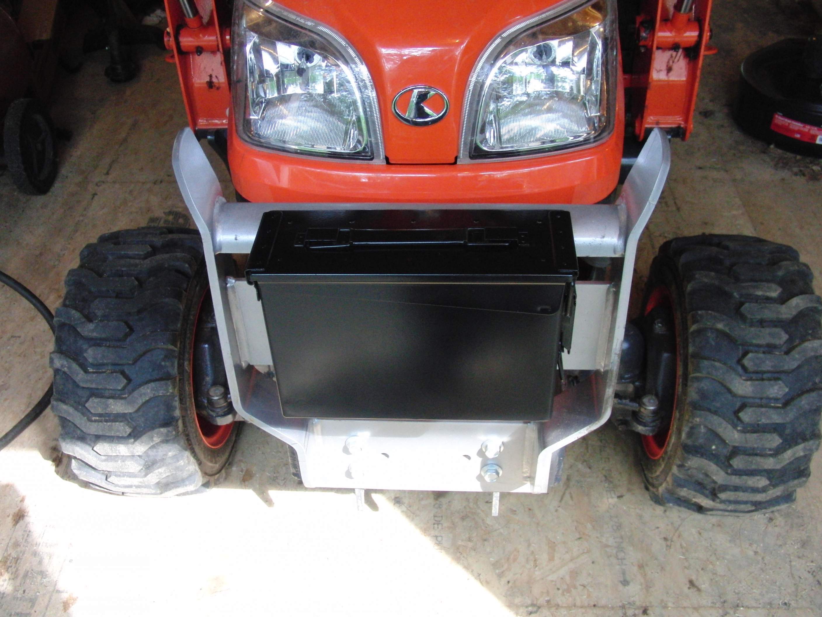

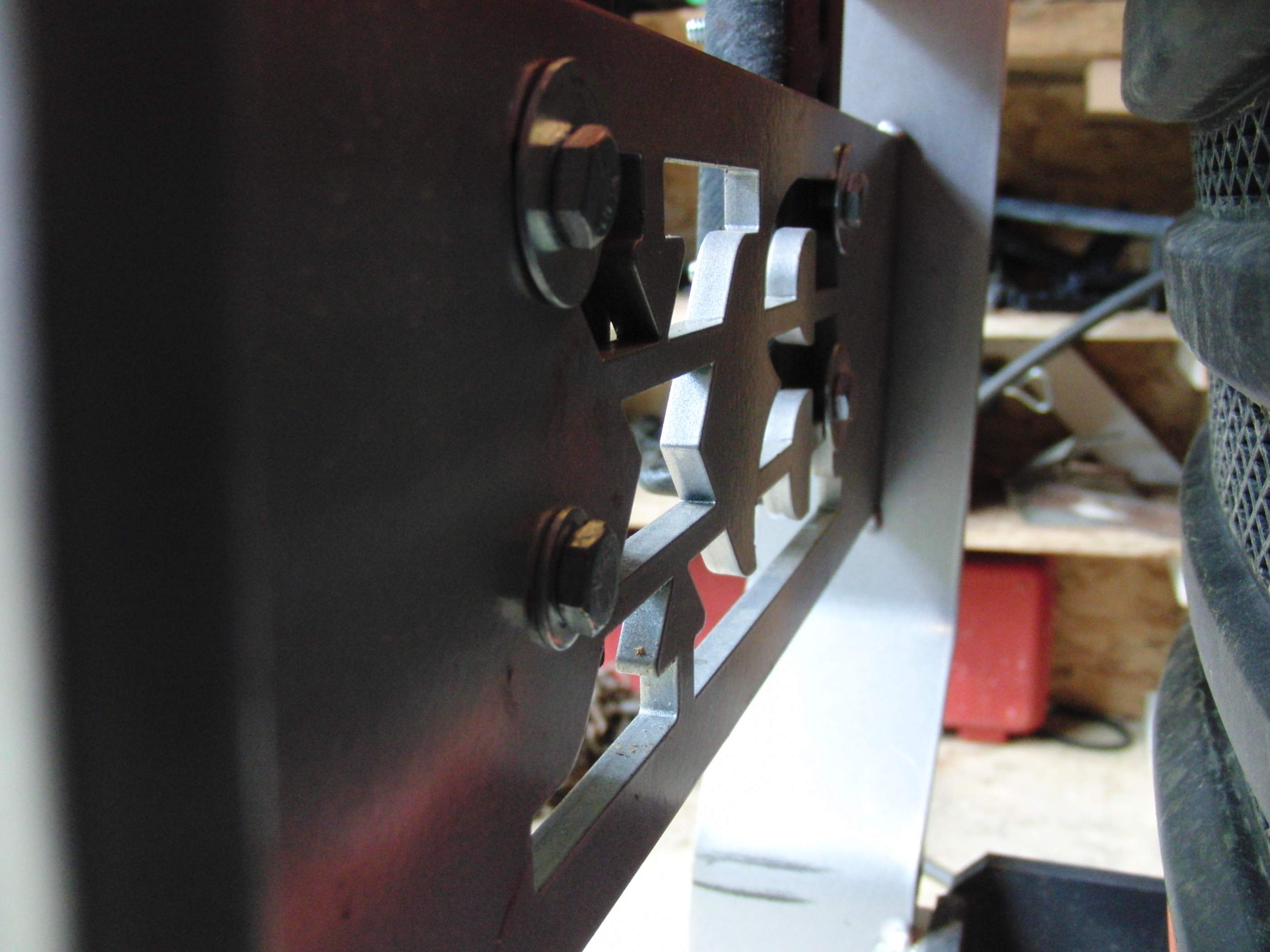

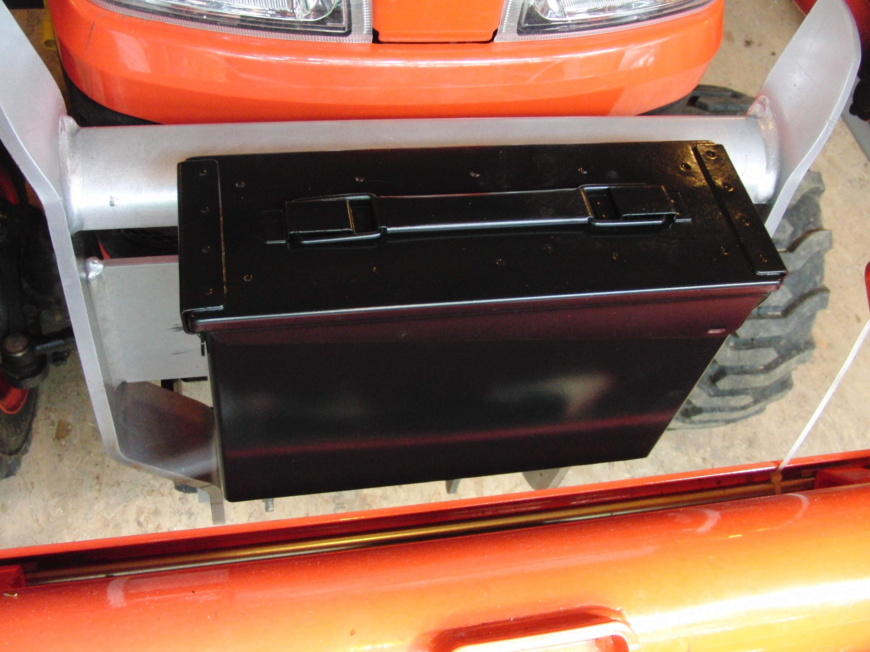

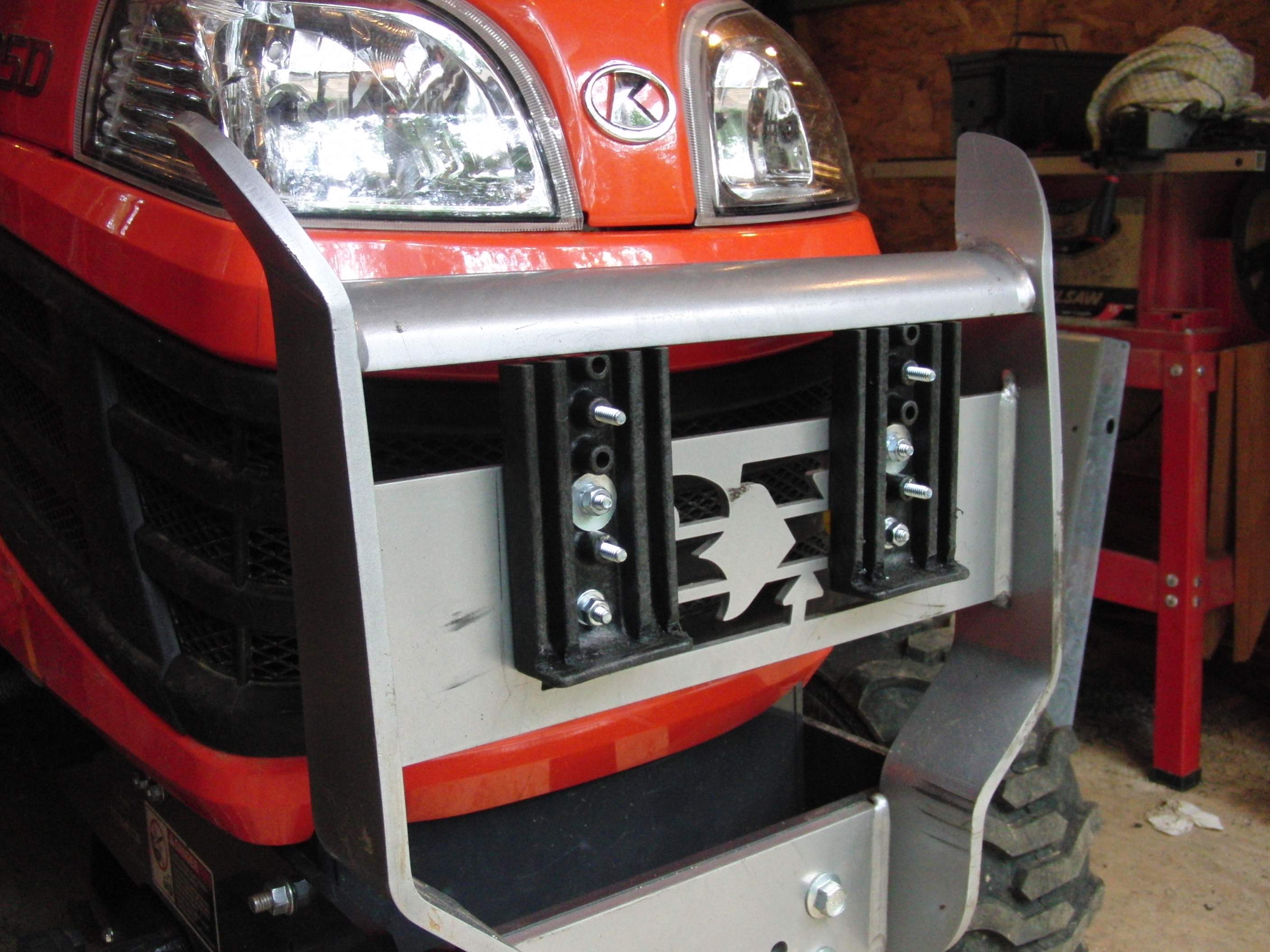

Got the first tool box all mounted up. I found that Tractor Supply had two ammo boxes (30 cal and 50 cal) for $29.95 so I pick them up. Had some plastic type material left from another project that made perfect spacers for the brush guard mount. So when I took the brush guard off to do the 50 hr maintenance I made up the mount before I put it back on. Here's the 30 cal box mounted to the guard. Haven't decided where I'll mount the 50 cal box yet...

Nice work. Are those boxes for sale currently at TSC? $10/each?
   / 2015 BX25D - plans for "upgrades" #34
Thanks for the idea. Been looking for tool box mounting ideas and options for the BX25 and this is a great start. Just ordered the ammo box combo online from TSC. Can't wait to see what you come up with for the 50 cal box so I can copy that too! This should work good for my chain and maybe a couple other misc items.
Be sure you mount it high enough so you have clearance between the box and the FEL cross member/stand! :eek:
I'm working on an idea for the 50 cal to be able to mount on the FEL brace but I want it to be an easy on/easy off type mount. Maybe some type of slide mount? :rolleyes:

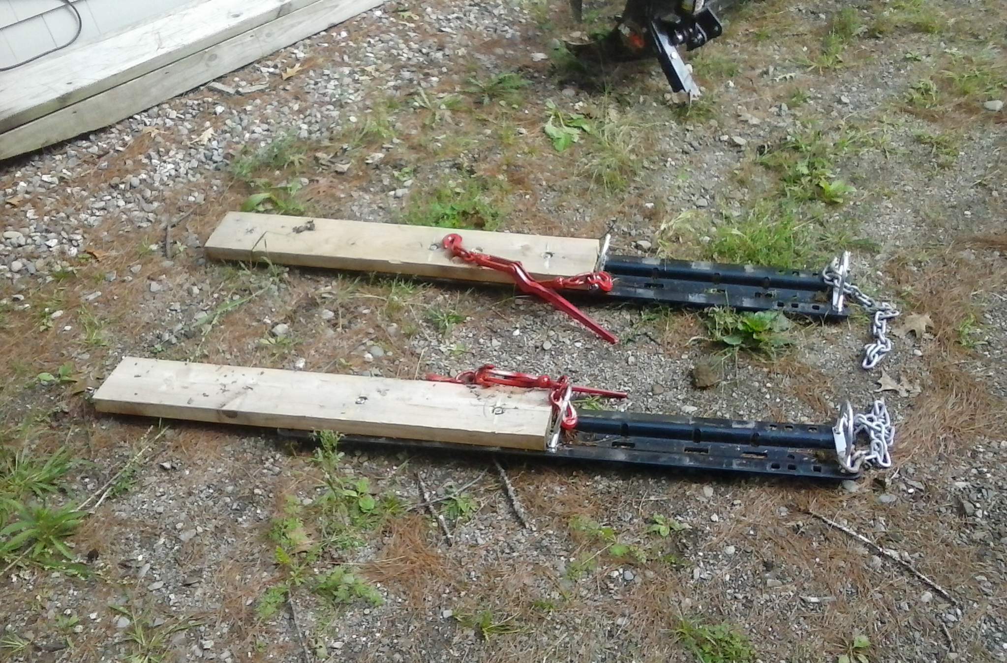

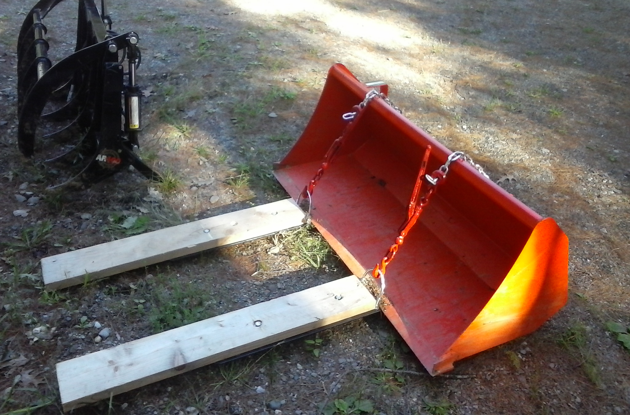

0914151120.jpgBucket Forks - not on my original list but realized I needed them so...
I looked in the scrap steel pile and found a couple of fifth wheel mounts for a pickup bed. They are about 4 ft long and real sturdy so I got some chain, chain binders, 3" u-bolts I had, a couple of 40" 2 x 6 and some carriage bolts...voila! Bucket forks! (Thanks to the folks on TBN that gave me the ideas for this!)
