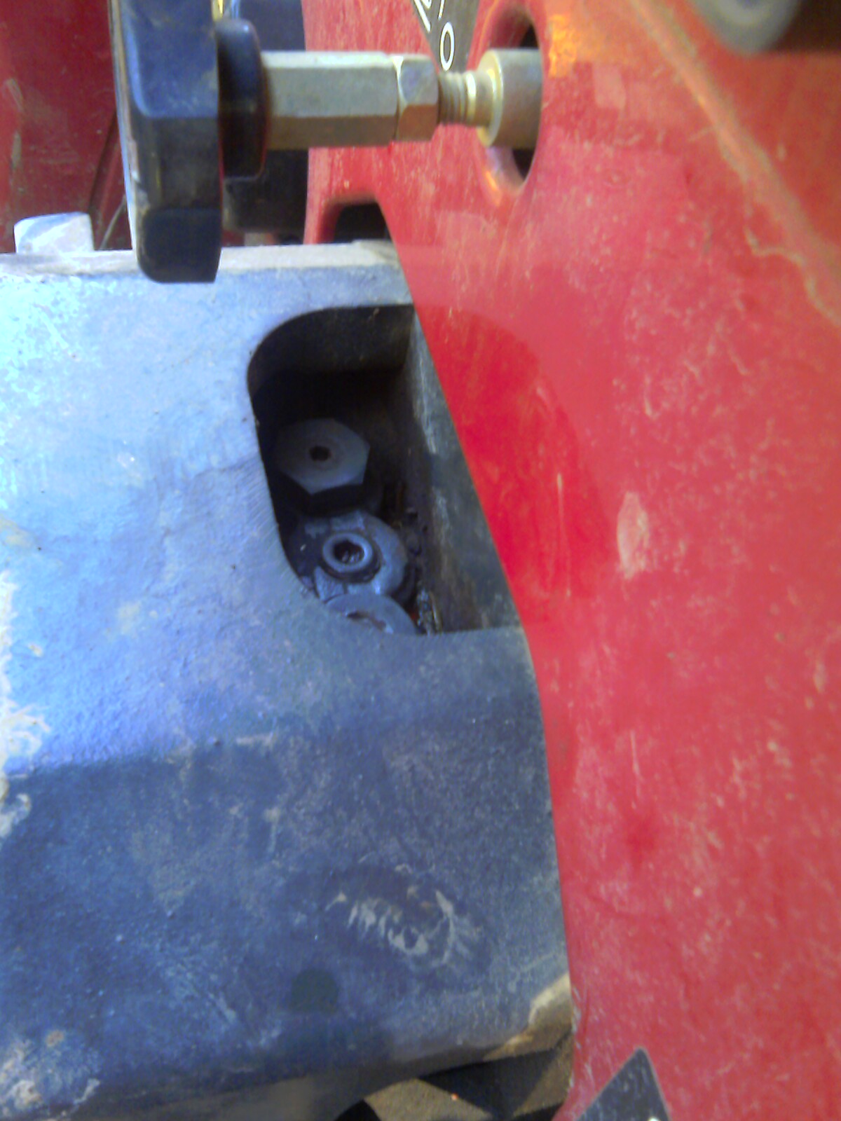

Reviving an old (really old post) here, but I just discovered the same problem. No backhoe installed, though. I can't see exactly where it's coming from, but I suspect it's starting at the top, and dripping to the left.
Any ideas on what's happening? I will post pix soon.

Is this tractor a hydro trans?
/ 2015 fluid leak (Sort of) #7
Yes, it's an HST, 2005 coming up on 450 hours.
Is the leak coming from inside the open cavity where you can see the drive shaft? I have seen the hydraulic lines up in the cavity loosen up and leak. You have to split the tractor to get to them and tighten the fittings.

I don't think it coming from the area you've described. I can't see the drive shaft, but it appears to be starting at the area visible from the top.
Turns out that I'm not low on fluid like I first thought, so I'm not as alarmed. I'm also remembering times in the past where under high load I'd get a smell of hot THF. I didn't think to look down or under when it happened, but I will from now on.
I'd still appreciate your thoughts, though. :thumbsup:
