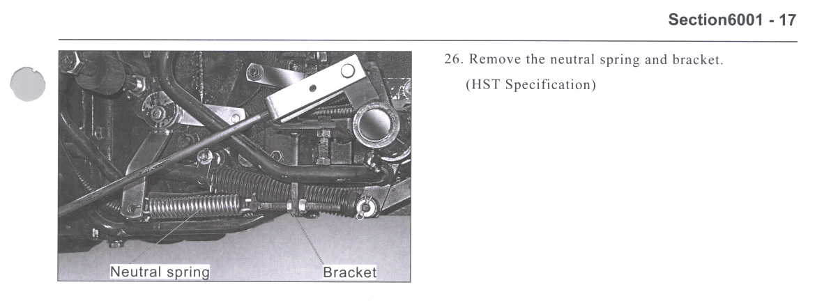

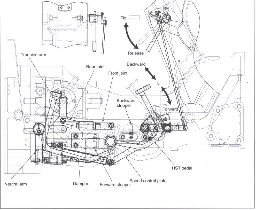

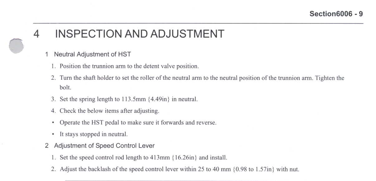

After read Wanderer53 posting which seemed to be good ideal I started looking more into my manual and found the following which for whatever reason I overlooked so I've scanned and have attached the information below, hopeful this will help.
Added another picture which should help identify the components.

Exactly what he needed. I tried to scan that for him a few days ago but for one reason or another, neither the shop or home computer would scan it and transfer it from the scanner. Even though I know the problem is probably me, I hate computers sometimes.
