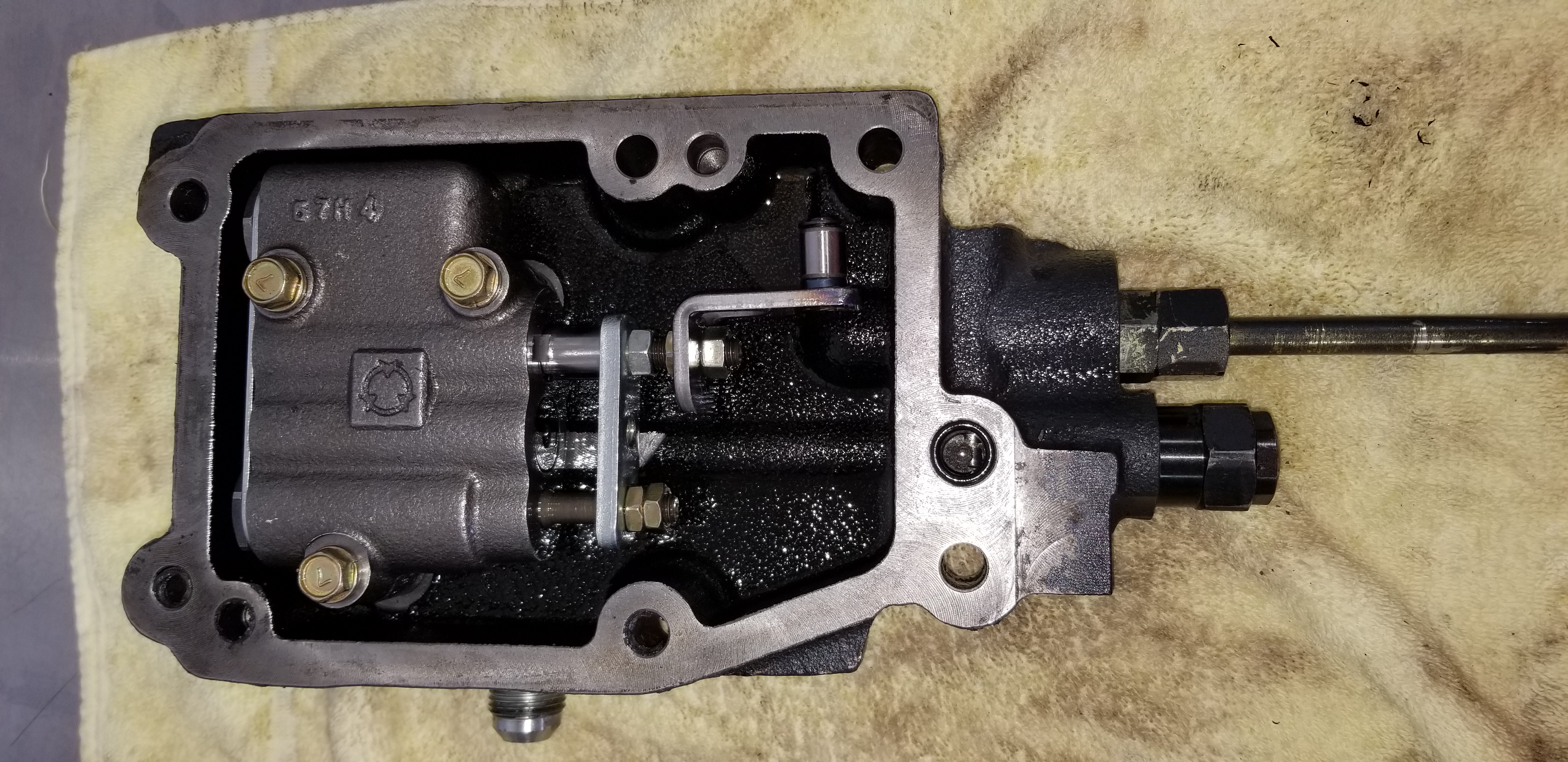

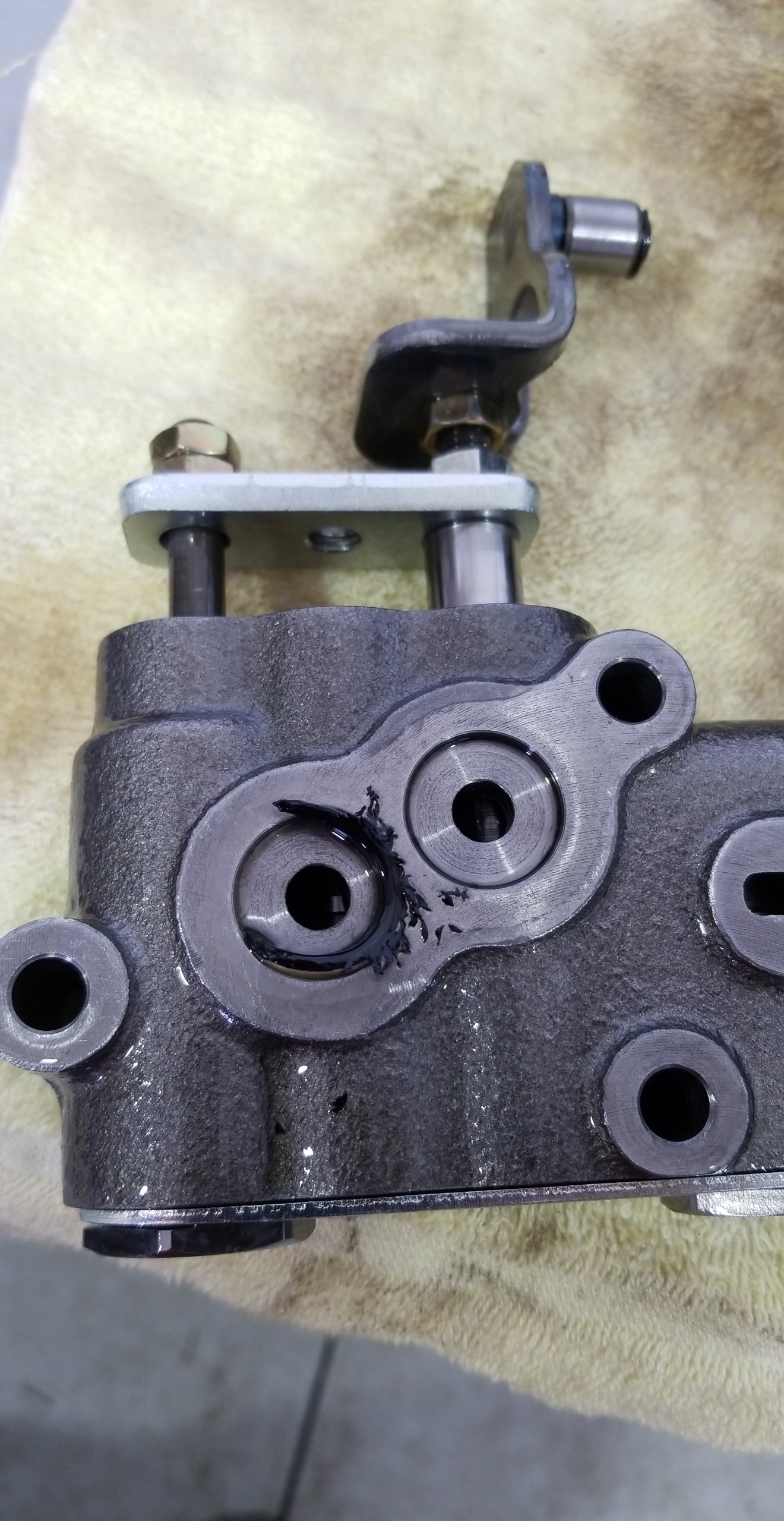

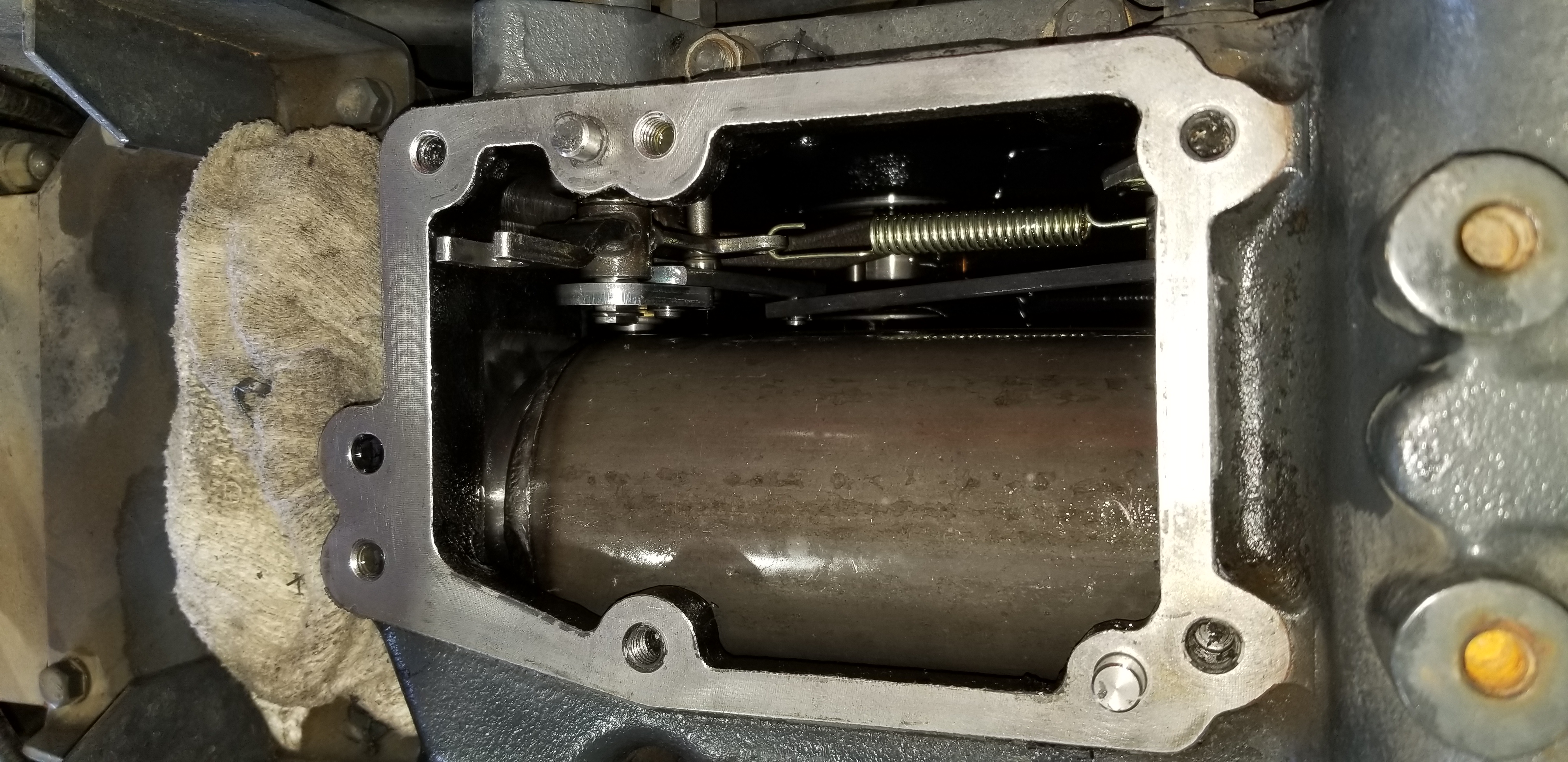

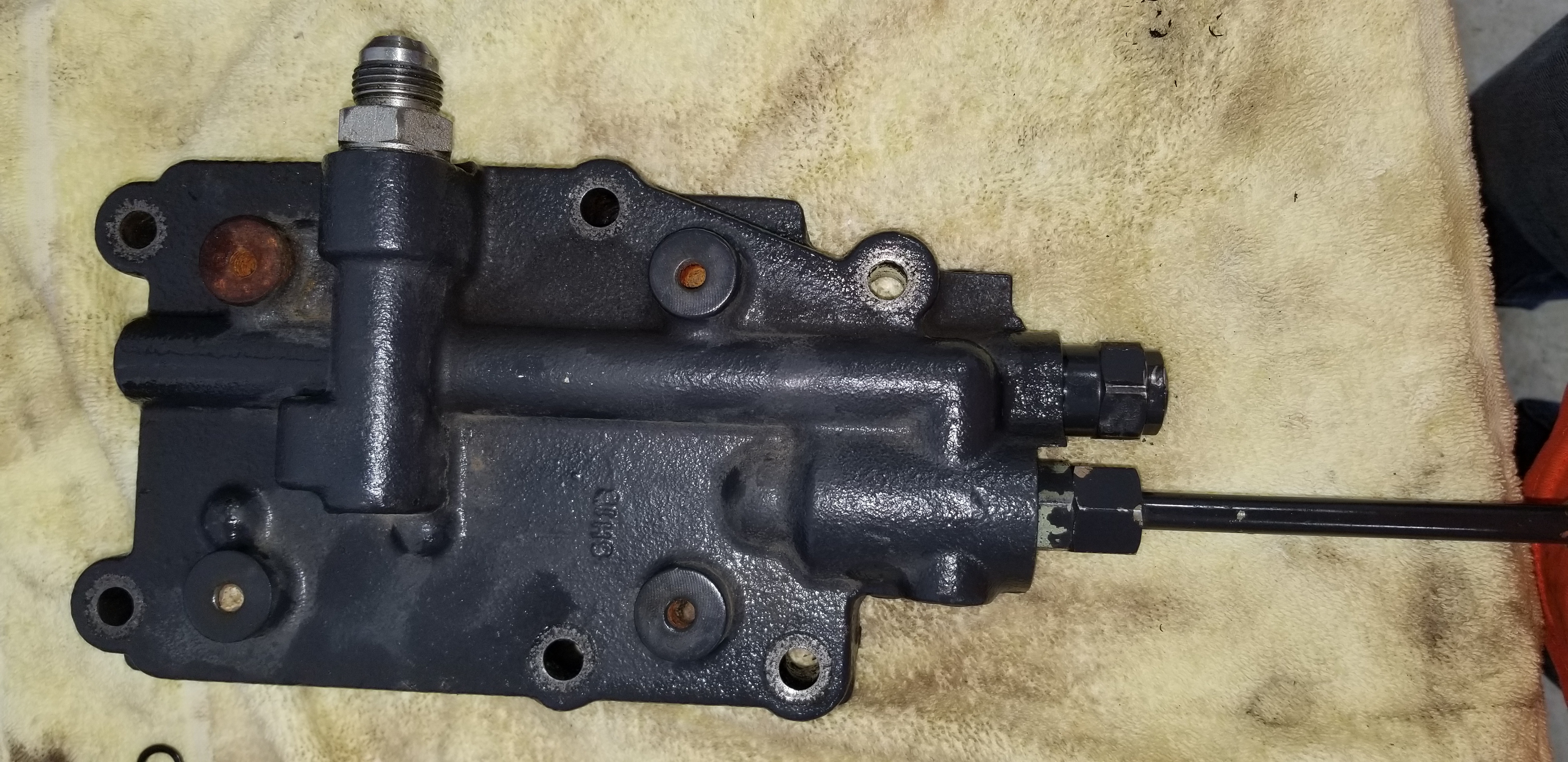

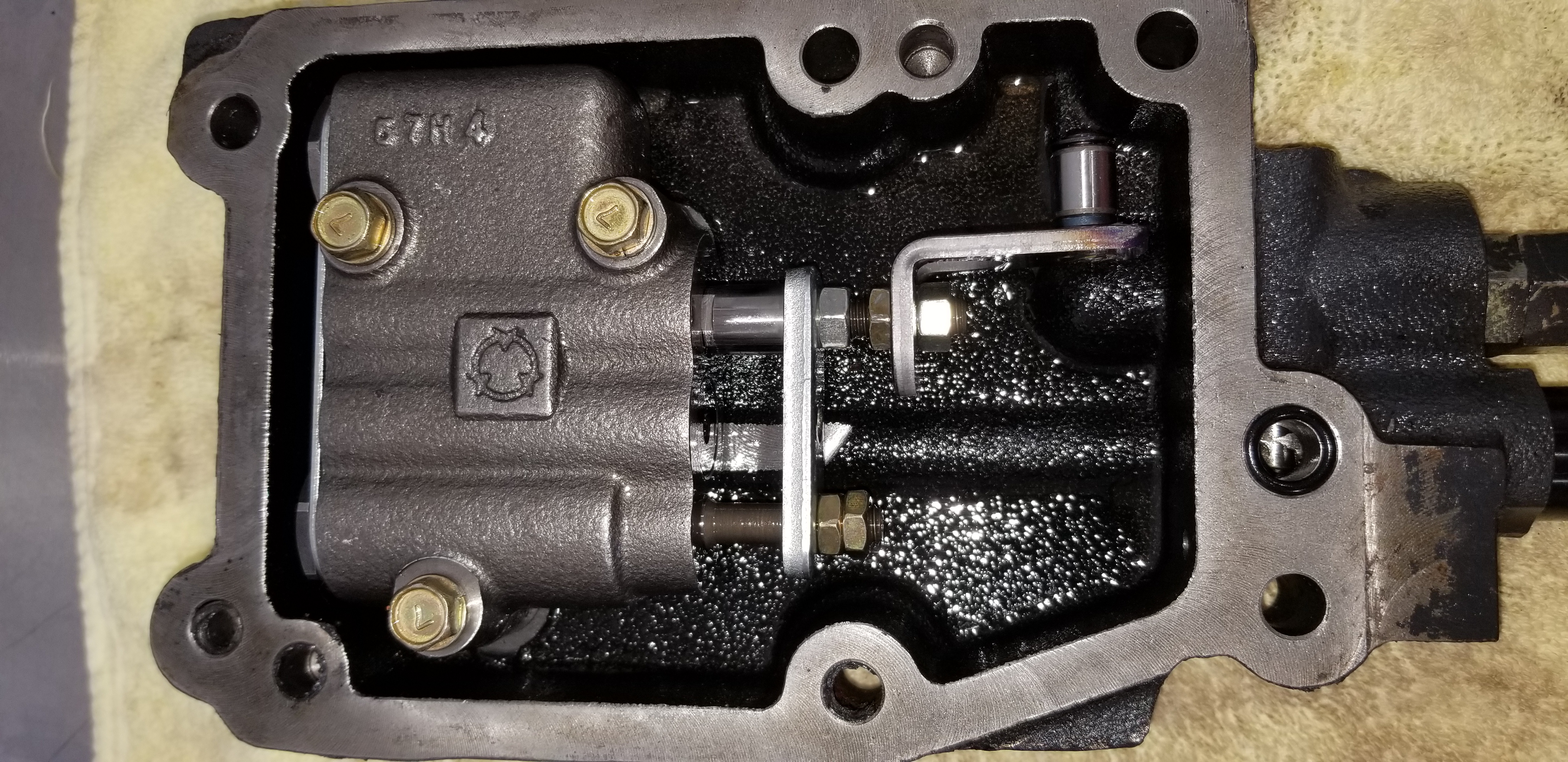

Thanks to everyone for your input!! I think I found the problem this morning! USER_SCOPED_TEMP_DATA_MSGR_PHOTO_FOR_UPLOAD_1571063124669.jpeg
/ 2016 3520R 3pt hitch bouncing #9
Good find....what is it? Is it sealer, rubber from somewhere else in the system, o-ring?
It's what's left of one of the two o-rings between the lift control valve and the top plate for the 3pt hitch.20191014_104925.jpg20191014_104829.jpg20191014_104811.jpg20191014_104748.jpg
/ 2016 3520R 3pt hitch bouncing #11
So, too much pressure for the o-ring to contain, so the pressure shredded it. I wonder if there are better or stronger type seals out there? Was there an instance that overloaded the system with pressure? Just wondering about the WHY....:confused3:
/ 2016 3520R 3pt hitch bouncing #12
Could be moved out of its place during the assembly process. And now, after some time, it finally gave up.
/ 2016 3520R 3pt hitch bouncing #13
Yeah- looks like it shifted during assembly, time for a dab of grease or petroleum jelly to keep the new O rings in place during bolt up
OP How did it work out- Fully functional now?
Nice to have confirmation repairs have been successful
