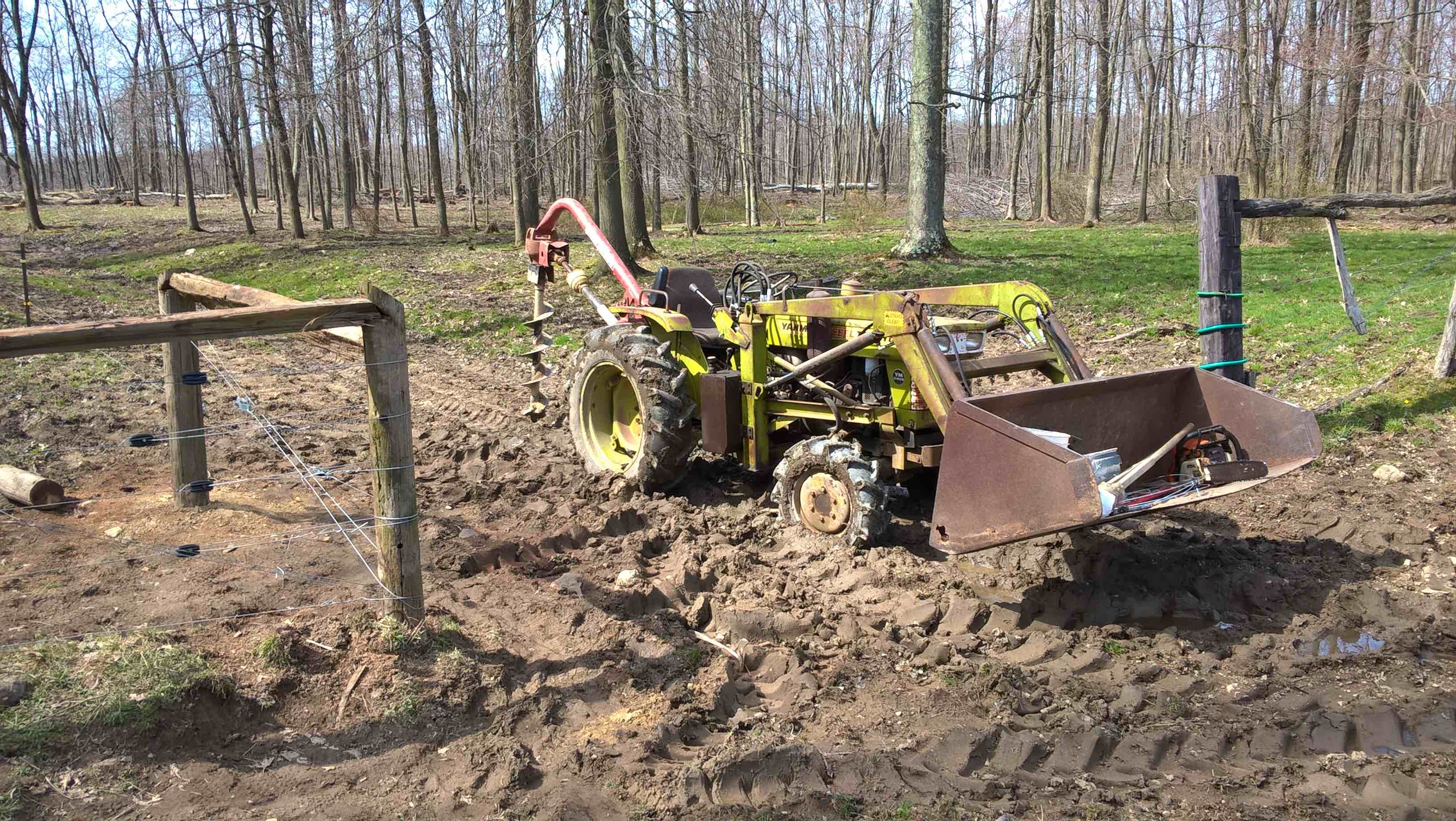

I've used my old yanmar to help 'seat' fence posts as well, but in my case I don't think they'll care.
Not nearly as pretty as yours but the good news is she keeps on running.
