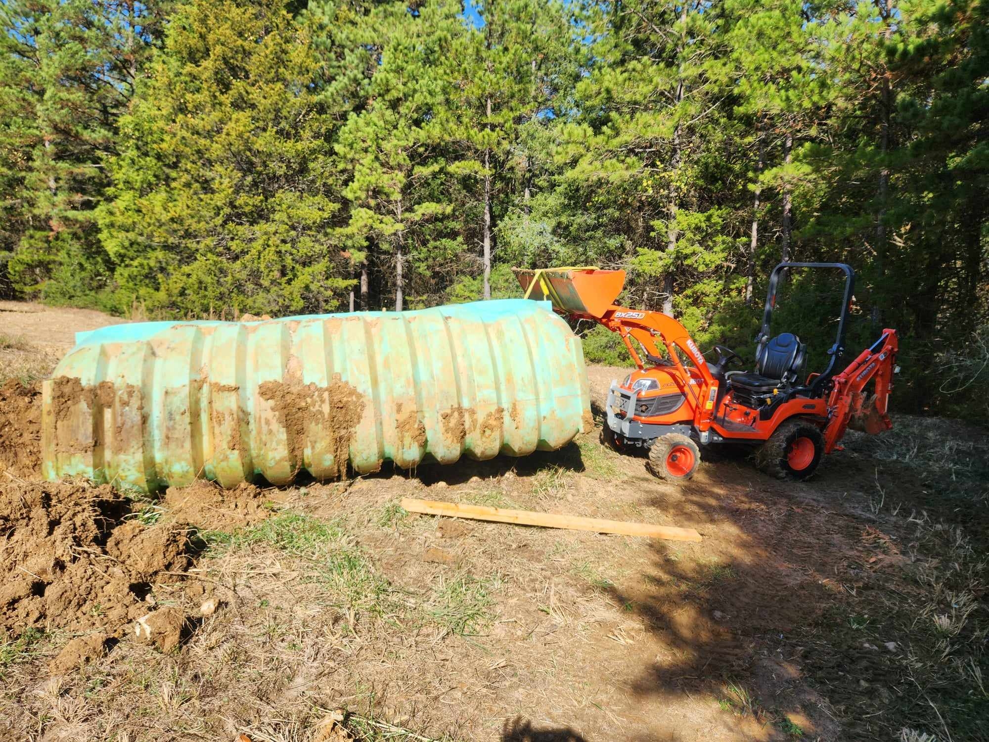

Small but mighty! This tank was never tied in nor properly installed. It floated this summer a bit. Dug around it a bit, lifted and pulled. Love this "toy" tractor. 1250 gallon tank, with some dirt/water in it.
   / 2017 kubota bx25d - tachometer inoperable
#20
Capable of alot of work for the size! Nice
