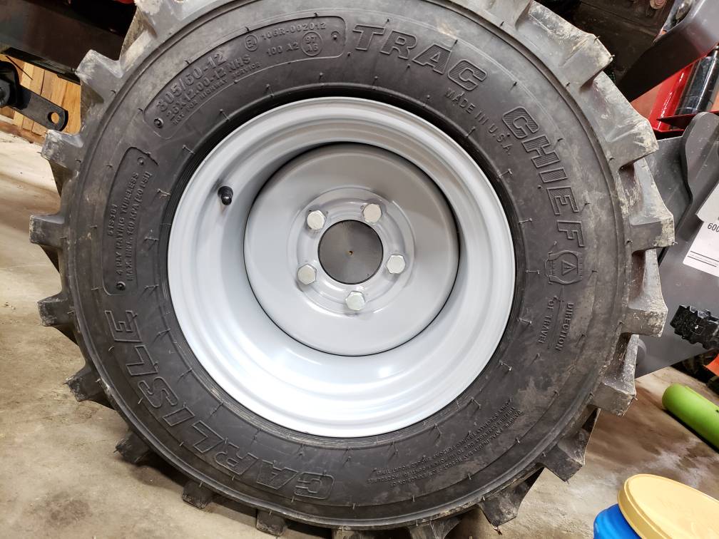

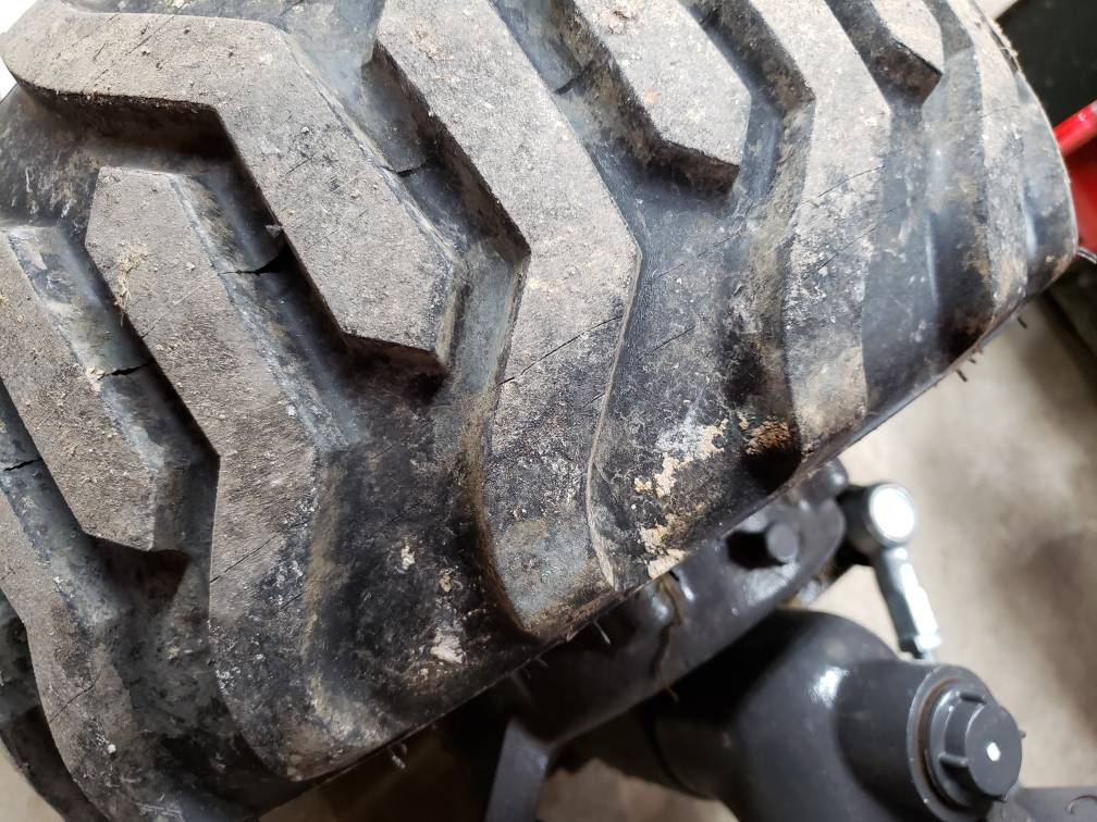

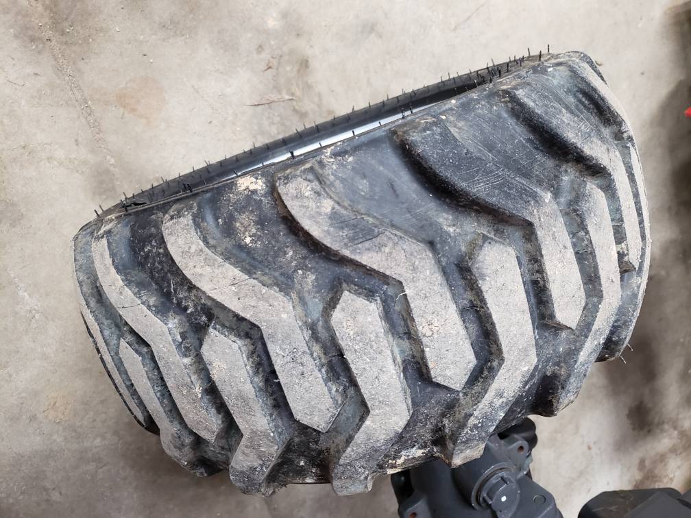

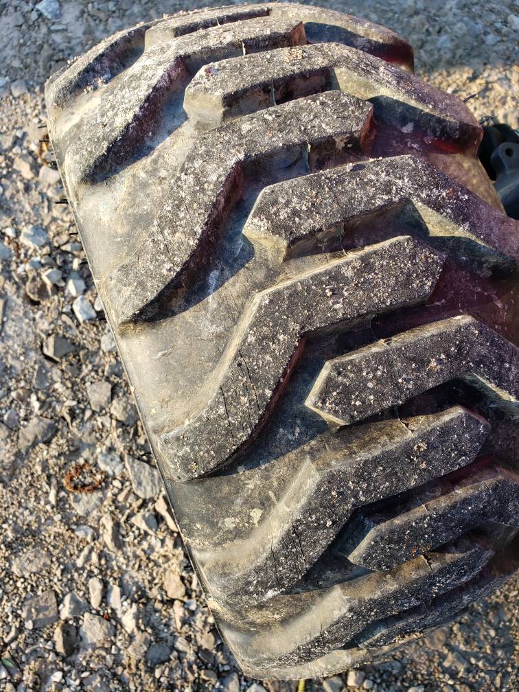

I posted this in the MF forum, already. I think posting it here in a more general sub would get more eyes on my issue.

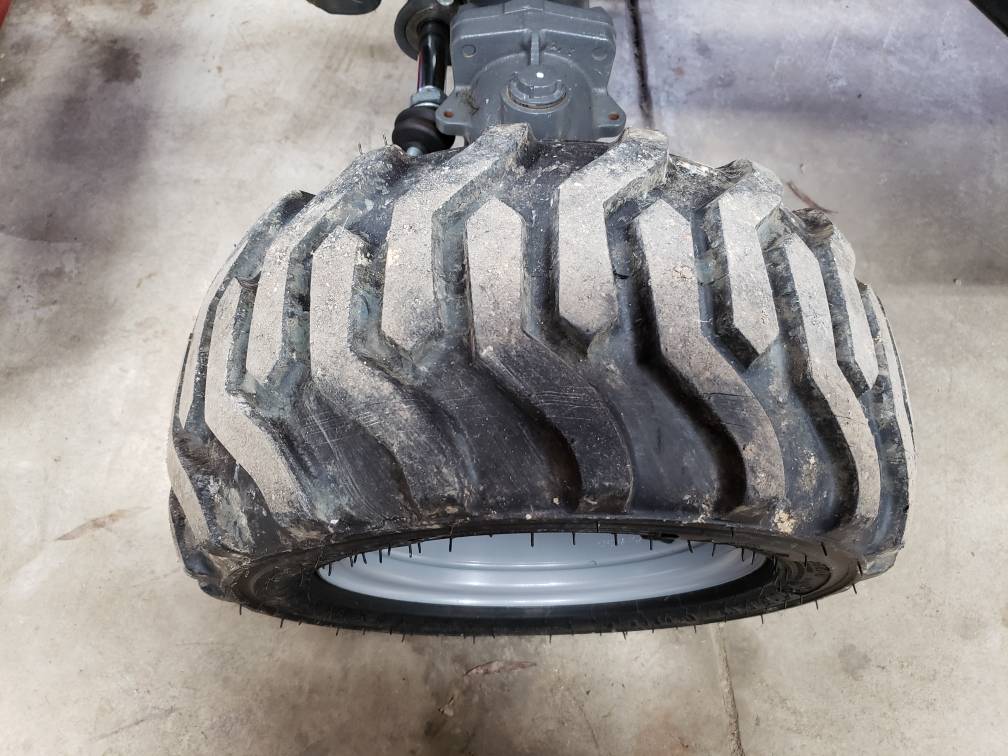

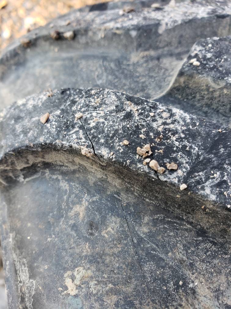

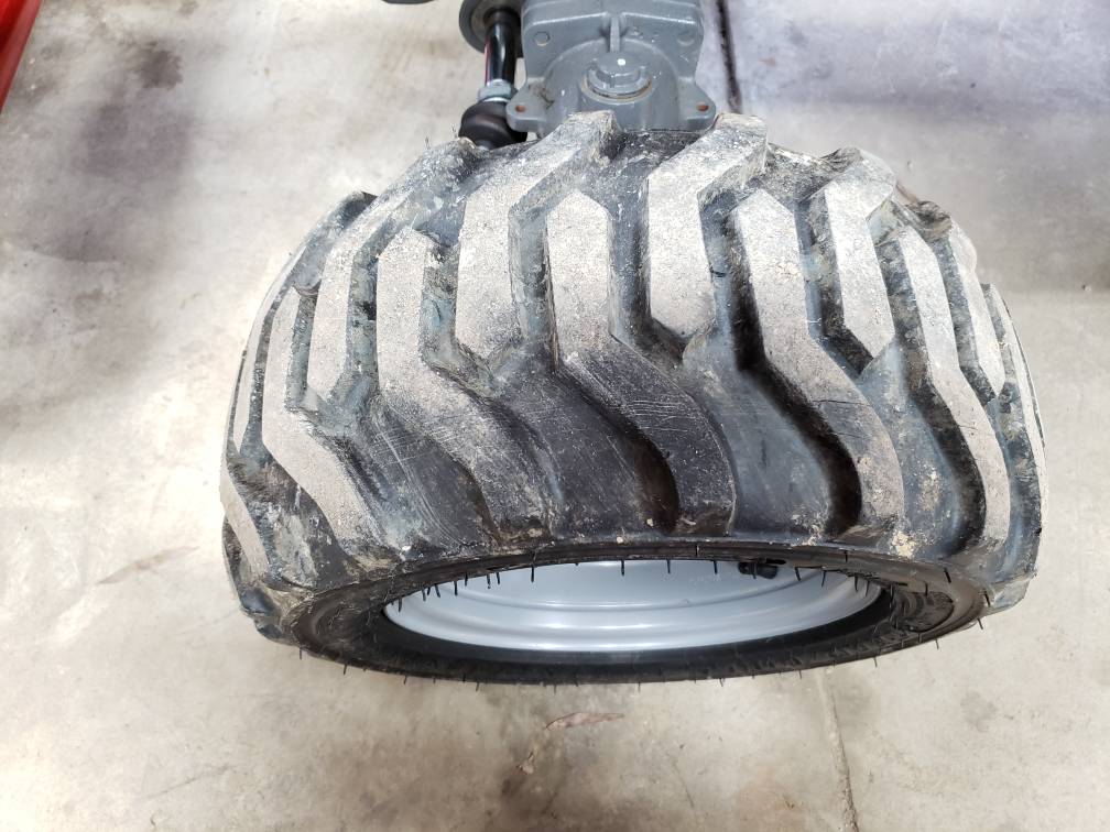

I have 20 hours on my tractor. I got it at the end of last year and parked it in my garage over winter. I used it to mow my lawn a few times.
I took it out on the first really nice day to spray the dust off of it and noticed my front tires appear to be splitting. Both of them.
It's tough to describe. The cuts go with the tire and span the lugs and valleys. There is no way that I hit something and did this. It's almost identical on both tires.
They are Carlisle Trac Chief tires. A mechanic friend of mine warned me that Carlisle were junk when I got the tractor. Now I'm inclined to believe him.
I contacted my dealer and they don't think they can help me. They are reaching out to a supplier and I'll call back tomorrow for an update.
That's all I need- to have these things explode on me while il trying to transport dirt or gravel this summer. It has me a little worried to say the least.
Please take a look at the pictures and let me know what you think.

I’d be frustrated for sure and go corporate on both agco and Carlisle if dealer can’t handle. Does it go completely around the tire? That’s bizarre looking for sure.
   / 2018 Massey Ferguson Gc1720 with 20hrs-R4 tires splitting
Completely around the tire. I'll probably call both of them tomorrow.

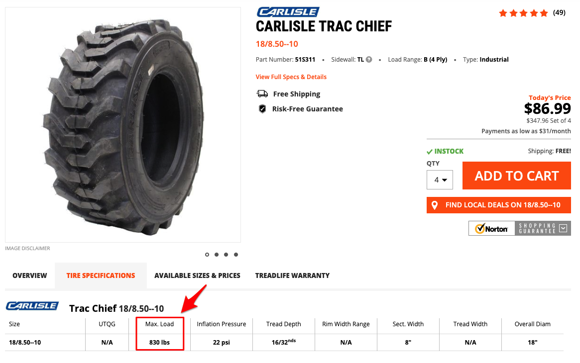

Also, in researching the tires more thoroughly, they are quite anemic. They are 4 ply with a weight rating of 830lbs... I just don't think thats very good for a SCUT with loader, but I'm not a tire expert. Maybe they're fine, who knows.

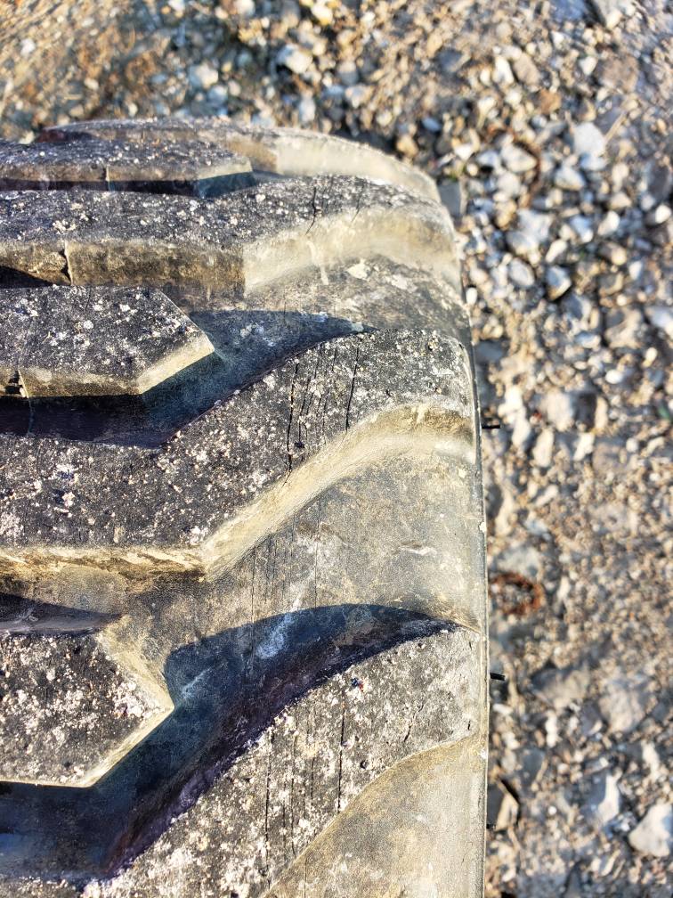

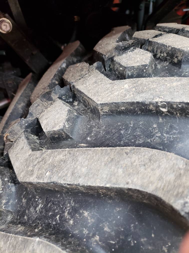

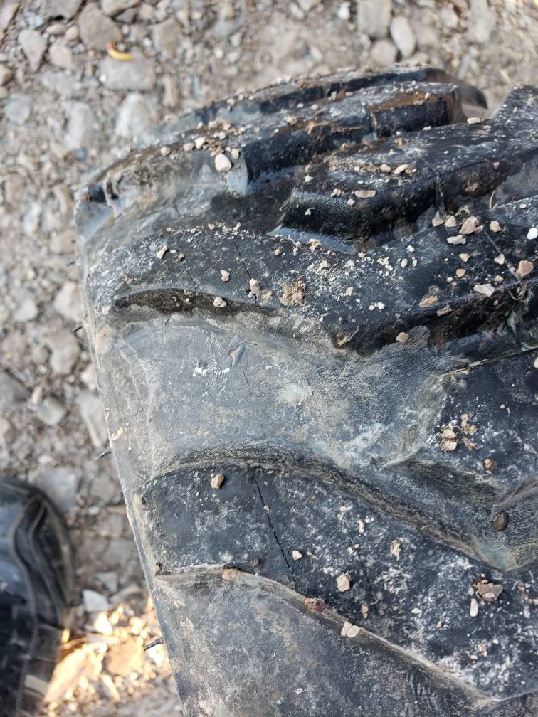

I tried to take some slightly better pictures of the issue. 20190424_193624.jpg20190424_193620.jpg

Definitely something wrong in the batch - My 2016 GC1720 has ~300 hours and the tires do not look like that - heck they are barely showing wear.
   / 2018 Massey Ferguson Gc1720 with 20hrs-R4 tires splitting #9
Looks like the layers of rubber they put in the tire didn't congeal.....maybe temperature was too cool, or timer on cook cycle was malfunctioning and was too short.
I had a problem with Titans crazing on my front tires on the 6530 when I bought it....little concentric arcs around the leading edge of the tread lug.....assume lack of adequate plasticizer in the rubber compound used on that batch. I took it to the local Titan tire dealer who took pictures of the tires and sent them to Titan electronically. He immediately got a reply, had replacements in stock, mounted new ones and had me on my way in an hour or so, no charge. I was really impressed.
