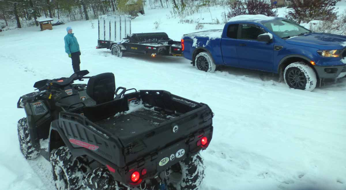

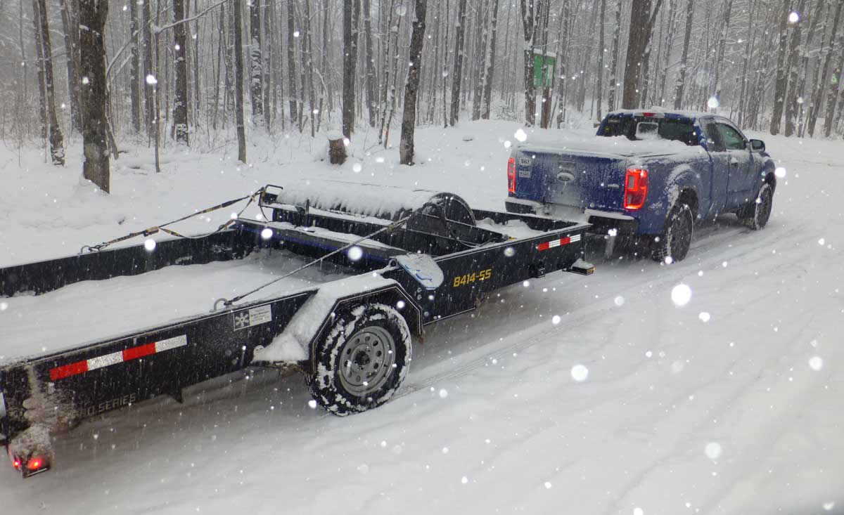

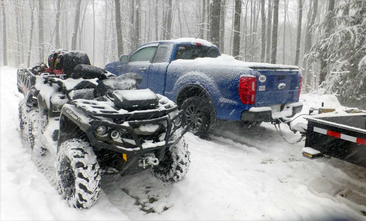

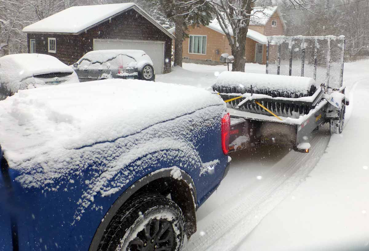

Rangers at work. Haven't got the snow-tire wheels installed yet. :ROFLMAO:
