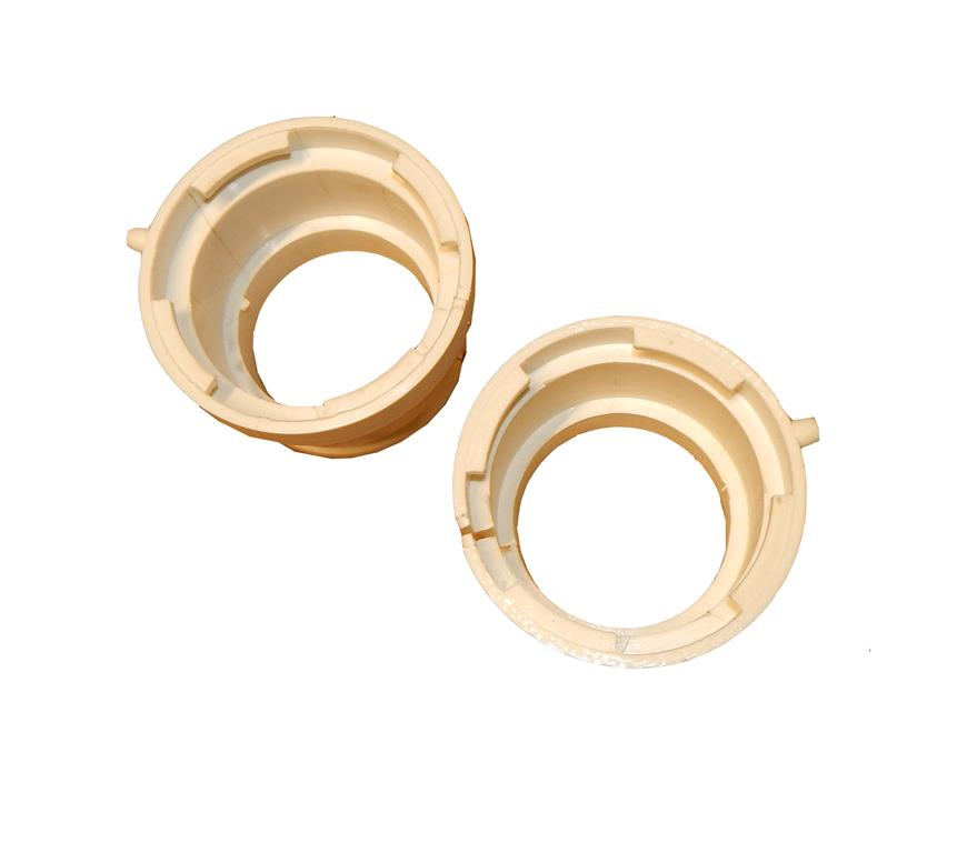

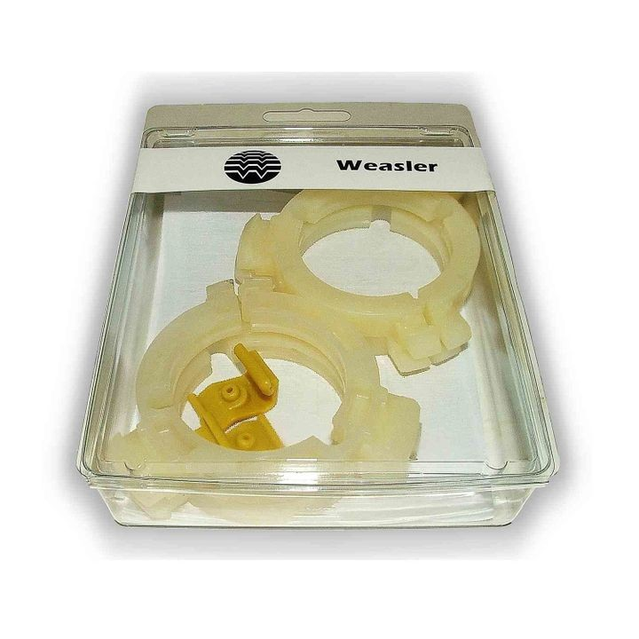

I am old and slow. Define pto bushing for me.
/ 2020 PTO plastic bushing #4
Some of the plastic types look like this.
or like this,
It would be nice to see what his YM2020 really has. :)

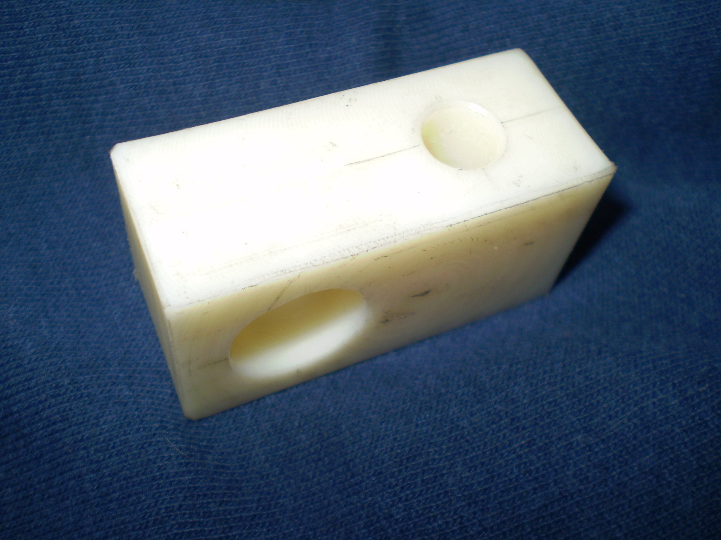

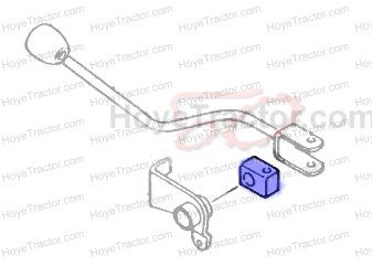

I think you are talking about this piece?
/ 2020 PTO plastic bushing #8
I looked this one up since I never seen it come up. Had to look hard but It's there" PTOB-2787 PTO Shifter Block". Yeah I think 25$ on shipping is a little steep.
Yes that is it I will look for that part, thanks so much for your help
